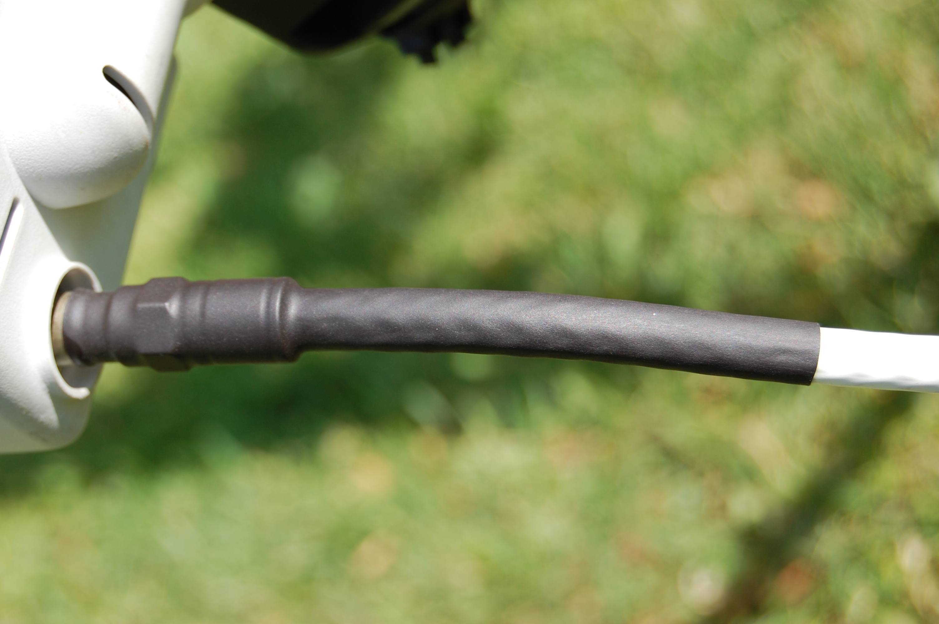

first i got some heat shrink from harbor freight, and a 30$ heat gun from home depot. (they have 2 there, get the one in the paint department, not the tool department)
starting with the cable freshly cut,
cut a piece of heat shink, flare the connector side with a needle nose pliers and slide it down the coax
then i strip the coax and put the connector on, then screw it into what ever its going on.
slide the heat shrink back up the cable push it up as far is it will go.
then use a heat gun to seal it all up
im sure a slightly bigger size heat shrink would not require flaring for the connector side, and i think they make heat shrink with a gel-adhesive specificaly designed for waterproofing.
but im happy how it turned out and i thought i would share it with you
gopher

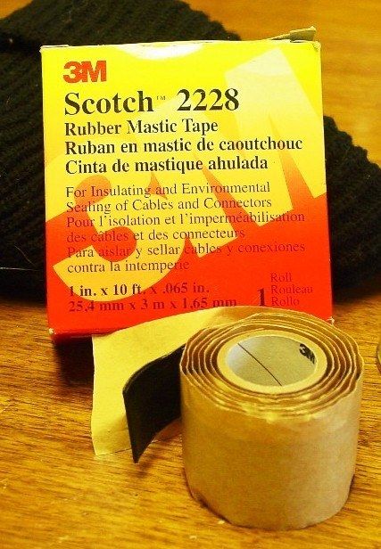

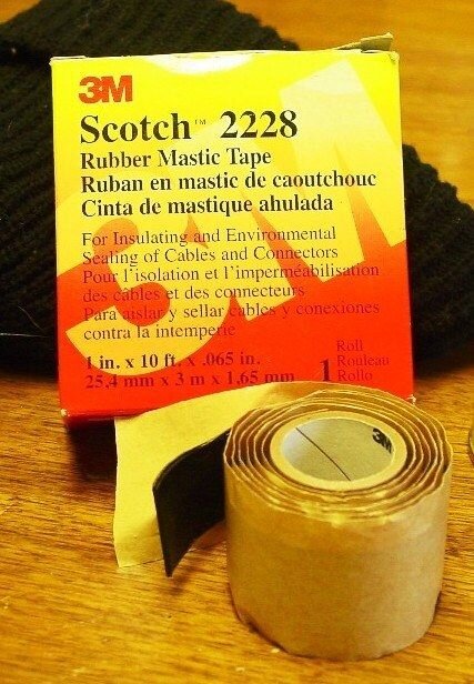

I've had great luck with rubber mastic tape - sticky, stretchy rubber - unlike other sorts of tape there is no adhesive layer. It is made of the same stuff all the way through.
I'm still using hex-crimp coax connectors. This stuff seals them up airtight. A bit of a pain in the butt to work with as it likes to stick to itself. Keep it warm for best workability. Wrap it clockwise around the connector so you tend to tighten rather than loosen the nut as you wrap. Start at the bottom and work up so the layers lap like shingles on a roof.
It forms a monolithic blob that is however easily cut away should the need arise. I have a couple of examples of connections using this stuff that have held up for 15+ years.

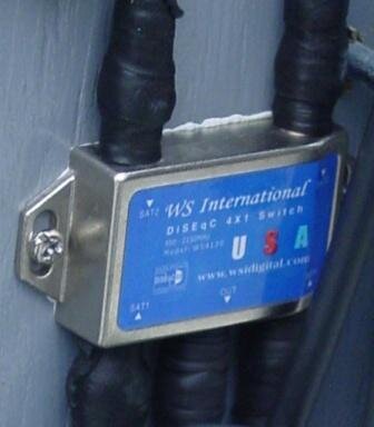

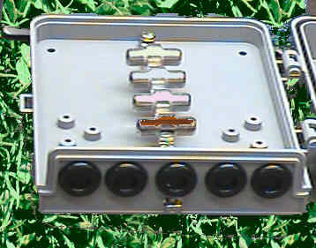

A guy is selling on EBay a pretty good weather box for DiSEqC Switch (item # 310131862458). I bought one of those - its well designed, made in Vietnam that surprised me - and fits my Chieta switch pretty well. Some European made LNBs like Invacom, GT and such not only have outstanding specs, but also a plastic weather jacket to cover F-connectors. Digiwave sells a bigger plastic weather box that can fit several switches at once - of a standard size usually placed by prof. installers.

What I don't follow about that listing are the photos above where it says
DiSEqc Switch Water Proof & Weather Resistance Case ONLY
(Switch and Grounding Block Sold Separately)
The pic shows a grounding block for four cables. (each with two female F connectiors) The weatherproof case has five pass throughs for cables to go inside.
Guess you can only use the block for two cables to pass through. the third cable can go inside and stop.. :p
Also, the product comes with a "DOA" Dead On Arrival warranty against any defect. Return product within 60 days without question asks.
That's nice to know... :D
I got one, and its actually much better weather tight than you would expect. Nice little box, I think the guy designed himself. Never seen anything like this short of big pro boxes. Many people use just one DiSEqC switch, so this box is all they need. You're right about grounding option, but I guess that's not its primary purpose. LOL about DOA, but in fact its hard to open its cover, as it sits tight. Its good to complement it with rubber Weather Boots like this (EBay item # 400045338846) to cover F-Connector ends attached to LNBFs and the Motor.
If you wrap a layer of vinyl (Scotch 33, 88 or equiv.) backwards on the area to seal then use the rubber self fusing tape (Scotch 130C or equiv.) for the outside (sealing) layer you can split the installation with a sharp knife etc and peel it open if/when you need access to the connectors with little to no self fusing tape residue on the equipment. This is a part of a standard termination proceedure for low and med voltage (>600v rms) wire to wire motor terminations.
I'll give that a try, but I think I will only wrap the nut with vinyl. That way the nut will not get gummed up, but I'll still have mastic in direct contact with the threads and the coax. Thanks.
