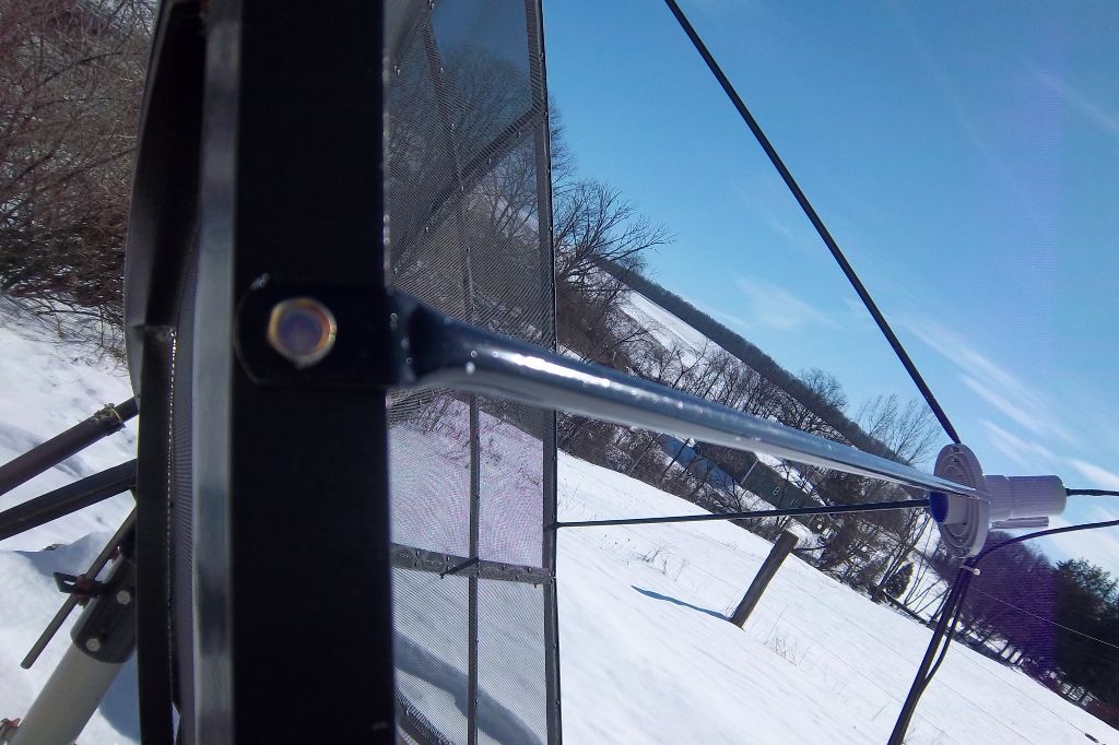

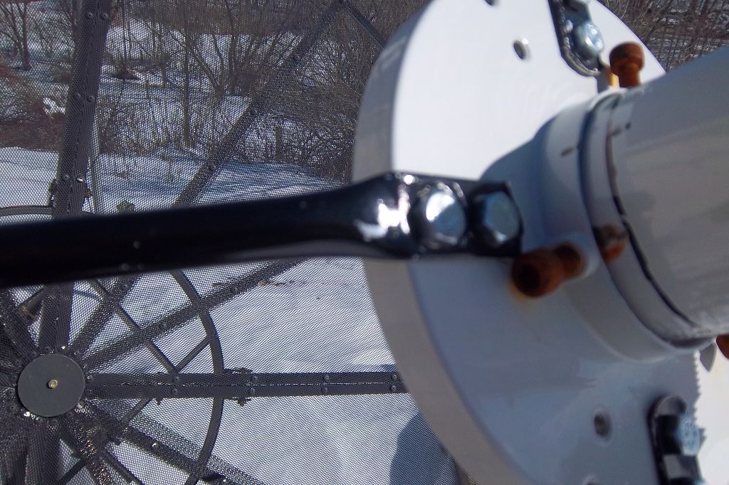

The holes may have paint in them but should be visible on outside rim of dish. Once I found them, it just took some time to get the arms attached & bent and the scalar centered. I bolted the lnb arms to the scalar first, then bent the four arms slightly toward the dish. Attached the top one (or closest to the top) first, then then bottom, then the sides gently bending each end into place and tightening hand tight. Once all four were attached I tightened them down and used a tape measure to check from several points around the dish edge to the edge of the scalar, gently exerting pressure on the scalar in the direction necessary until measurement is equal at all points checked. This gets the scalar facing the center of the dish and ready for your lnb. :)

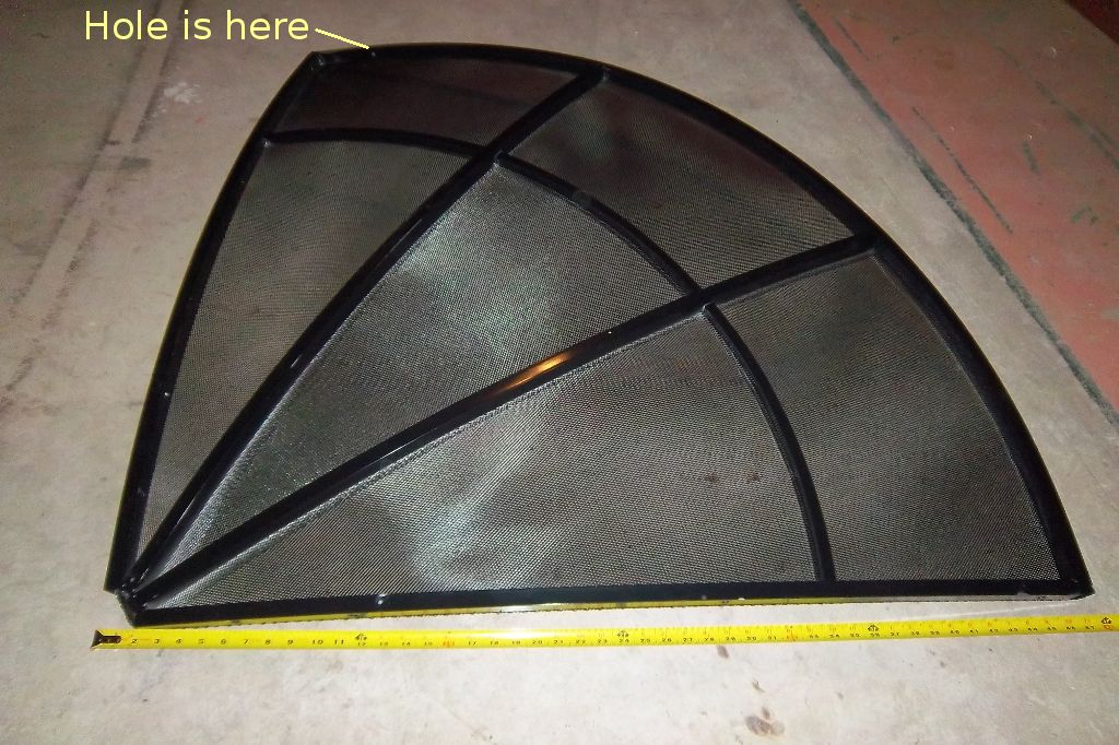

I did not see any holes them again I'm 68. Maybe my eye site has is play tricks on me. Anyways, how far down is the hole from joint? This is in case I can not find holes.
Not sure of exact measurement but close to the edge where the panels join, about 6 inches or less from the edge. I have pics somewhere on the pc that I took to post here to show the individual parts when I bought it last year. I will find them and post one if it shows enough detail where the holes are located. :)
Ok here is a pic. I added a line pointing to where the hole is relative to the edge where the panels join (assuming they haven't changed the design since last year).

Yes I did. Not on rim but instead 5.5" below the rim. I'll have to take the arms down, gently, and reposition them. Hopefully I won't F.......ed them in the process.

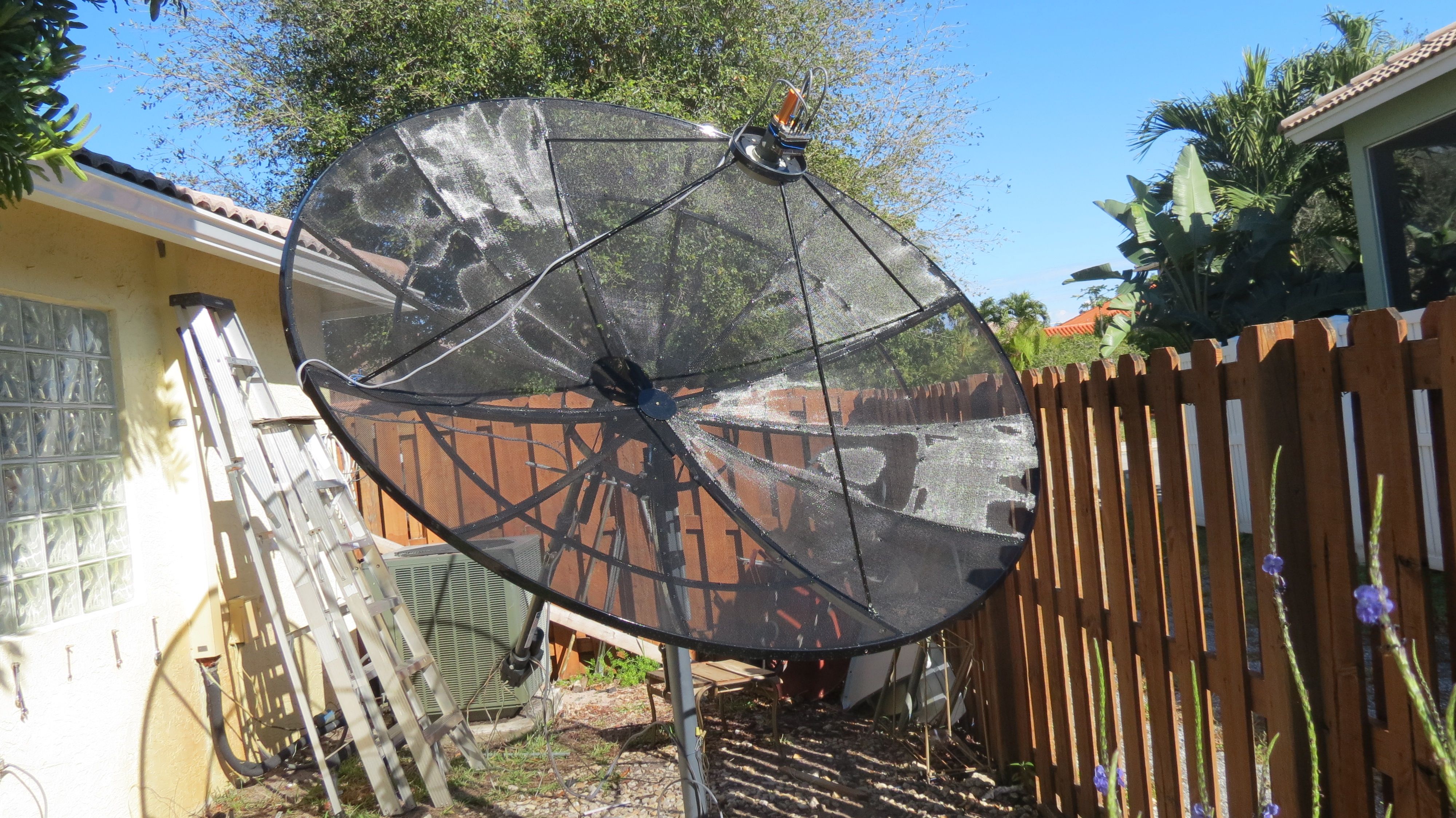

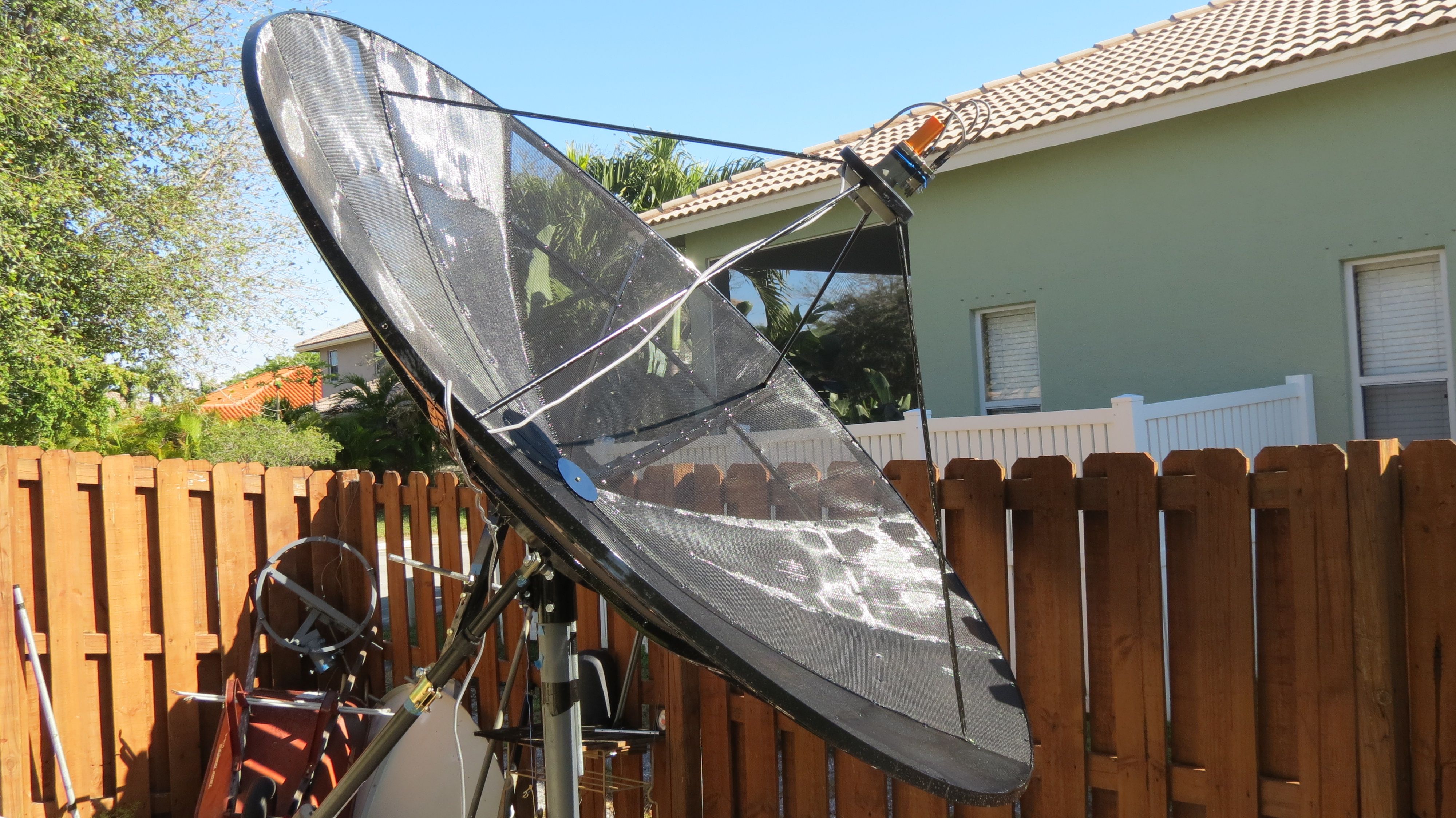

Well, I'm done putting the dish together. Here are 2 picture of what it looks like. I'm still having issue with LNBF cover...too tight. It is a heck of improvement from my 6".
nice to see your reception improve! keep the polar mount & ring from the 6'. if your ku reception sucks on your current setup & you need to install a large ku dish the polar mount can be adapted to fit a large offset dish then use an 36v actuator to push it around. its a better solution than those wimpy small diseq h-h motors like the sg2100s.
