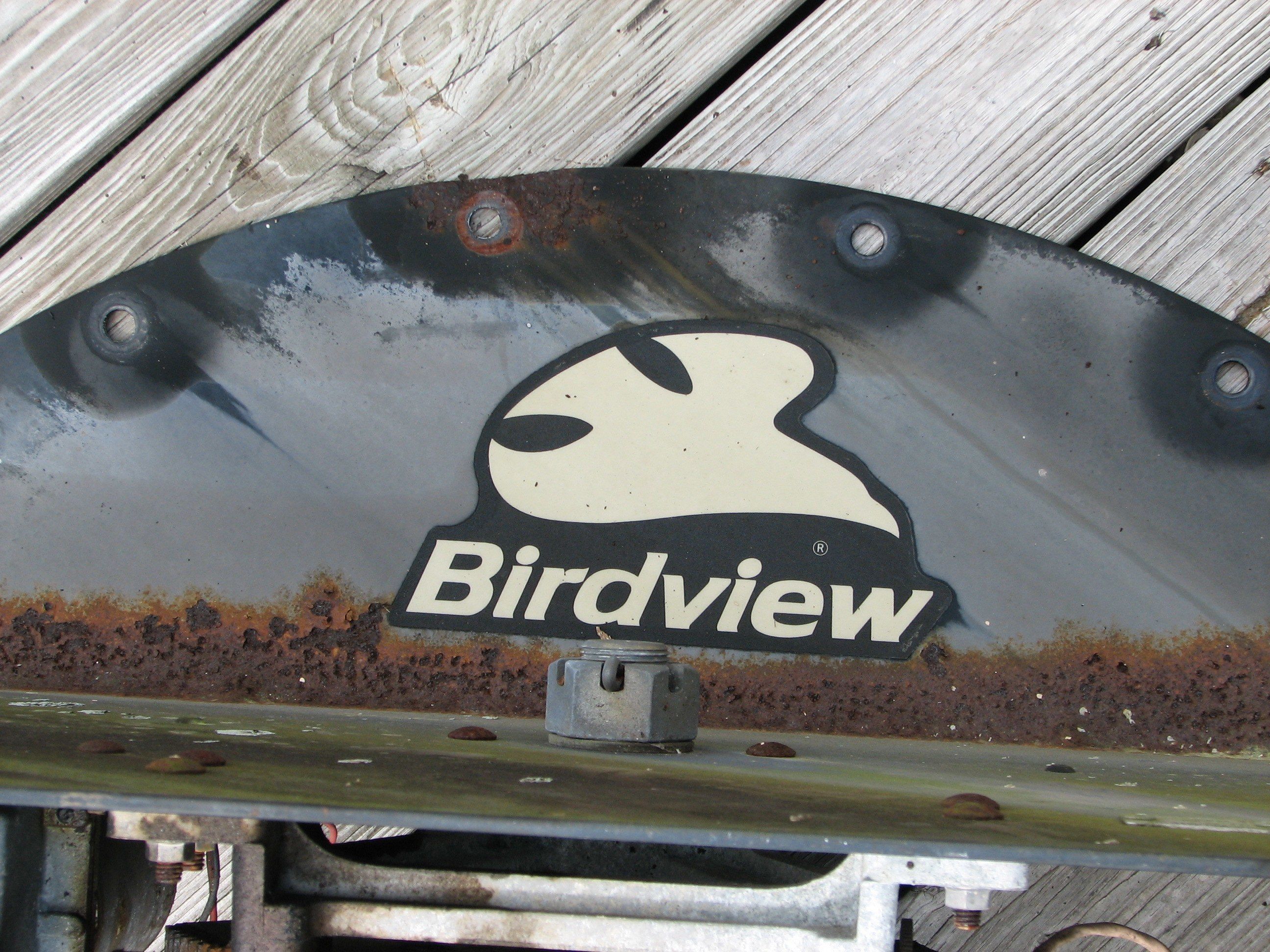

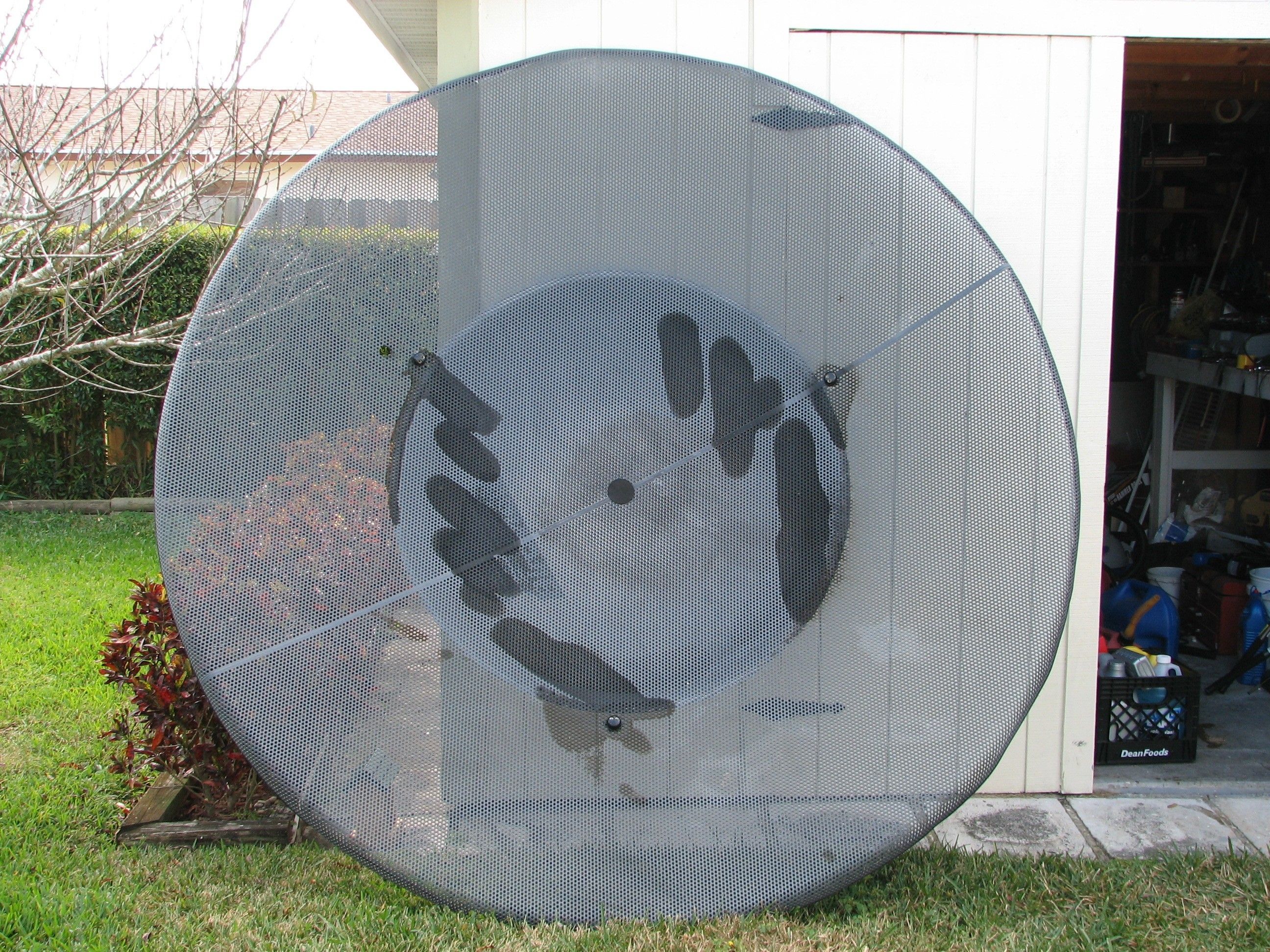

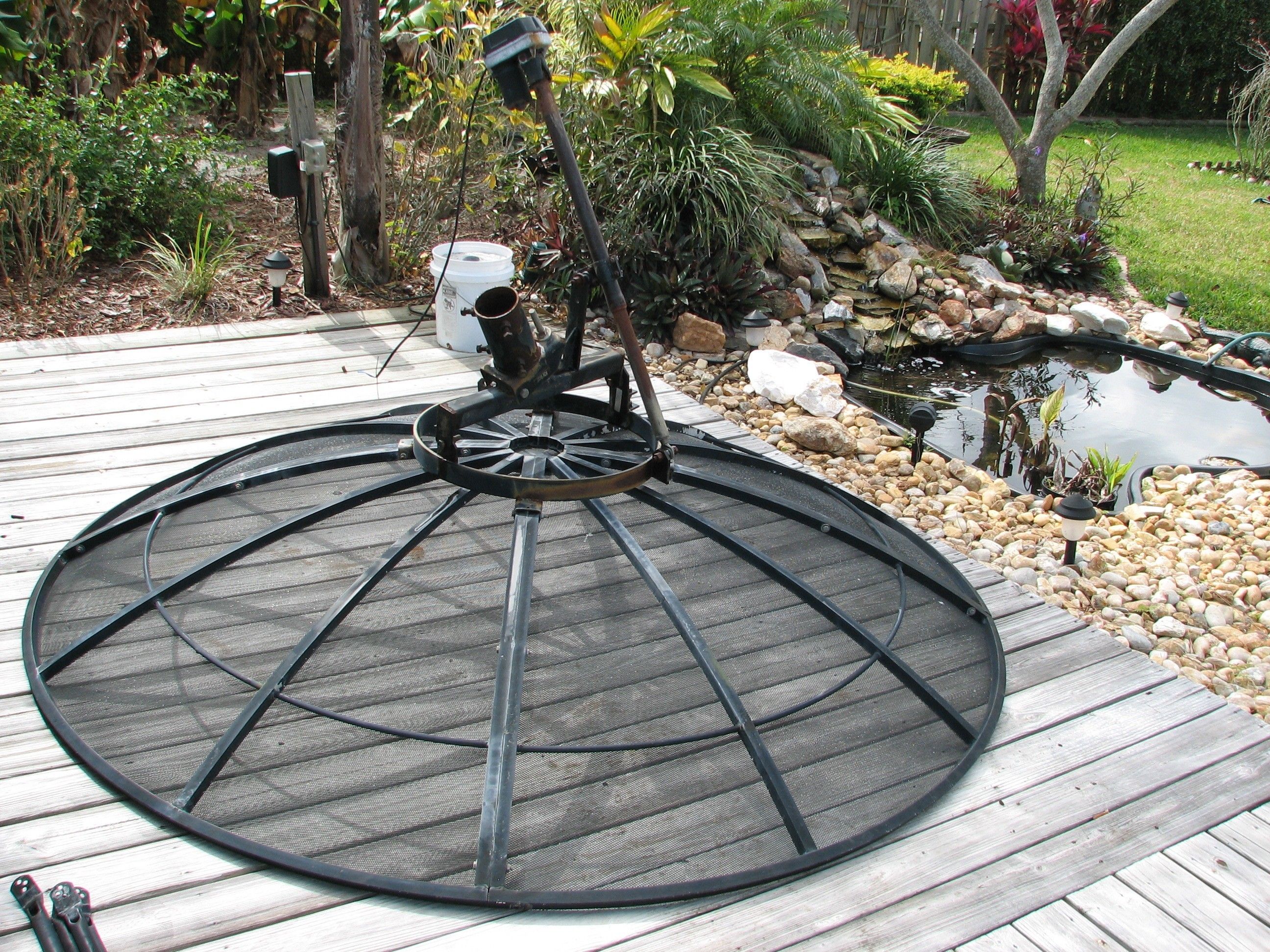

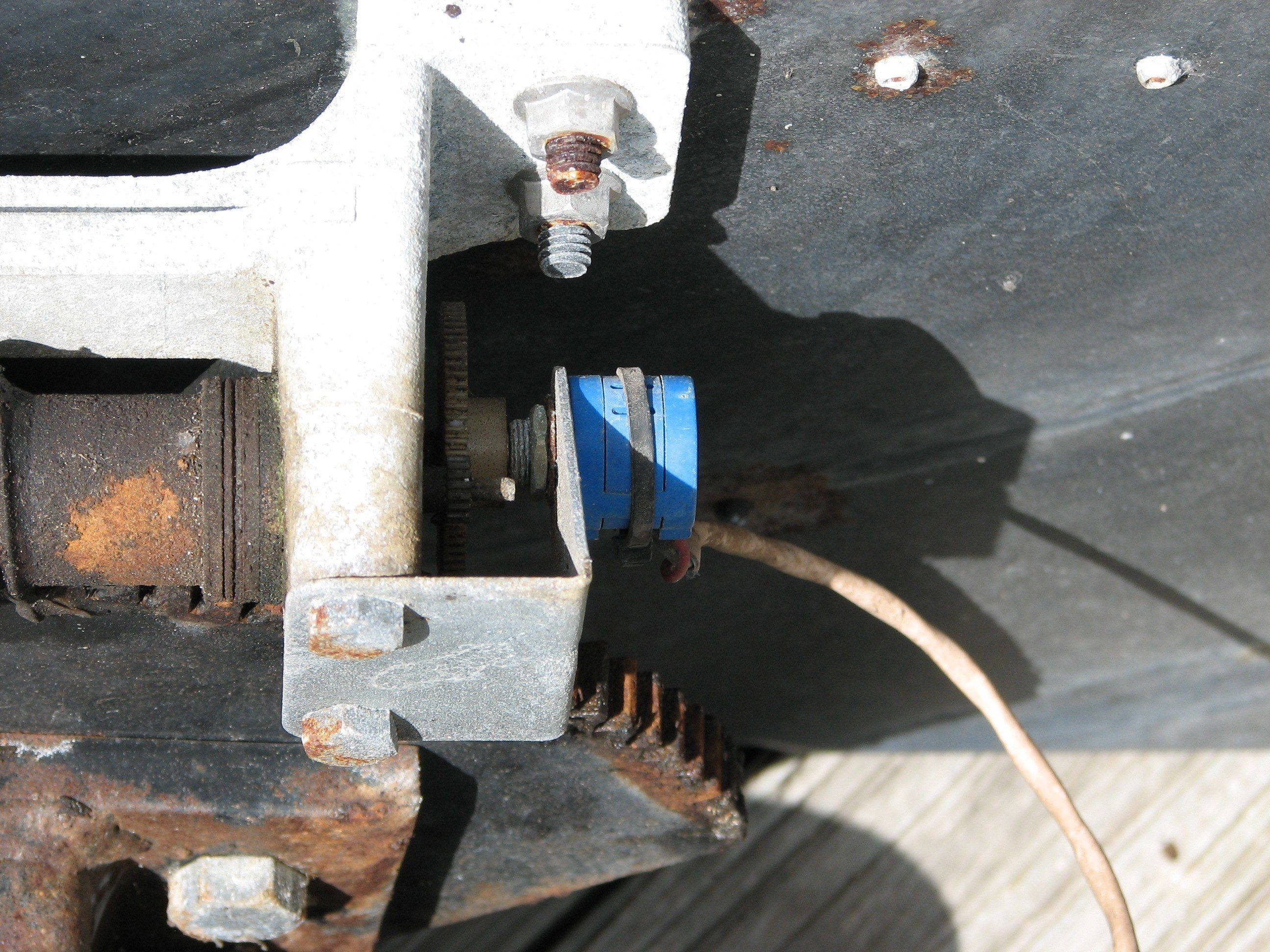

Here are some pics of the dish. And yes Anole if I put the tape measure down in the dish it is 8 foot. Now one question, the blue thing in picture three is the old potentinometer right not the reed conversion? I have had great luck with everything coming apart easy,so I know I could not get lucky enough to have the conversion. Oh yeah,the motor even runs fine.

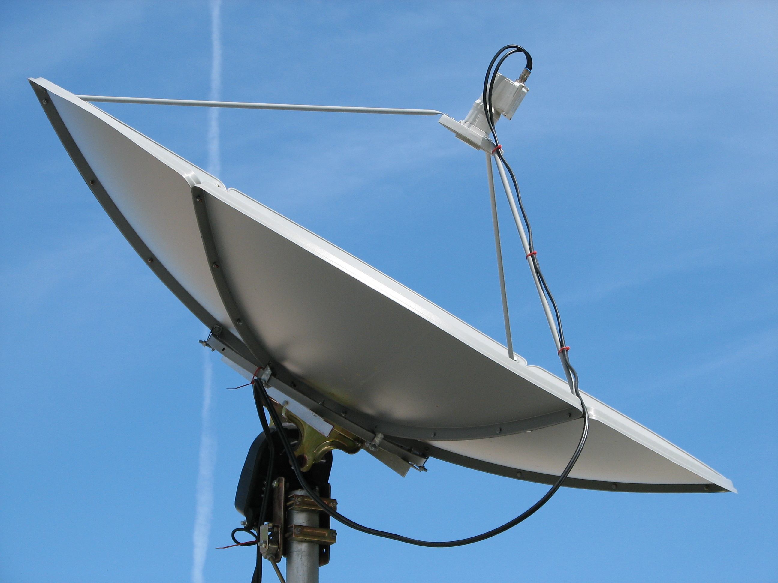

Here is a pic of the 8 footer I harvested this morning.Dish is in great shape but needs a new actuator.

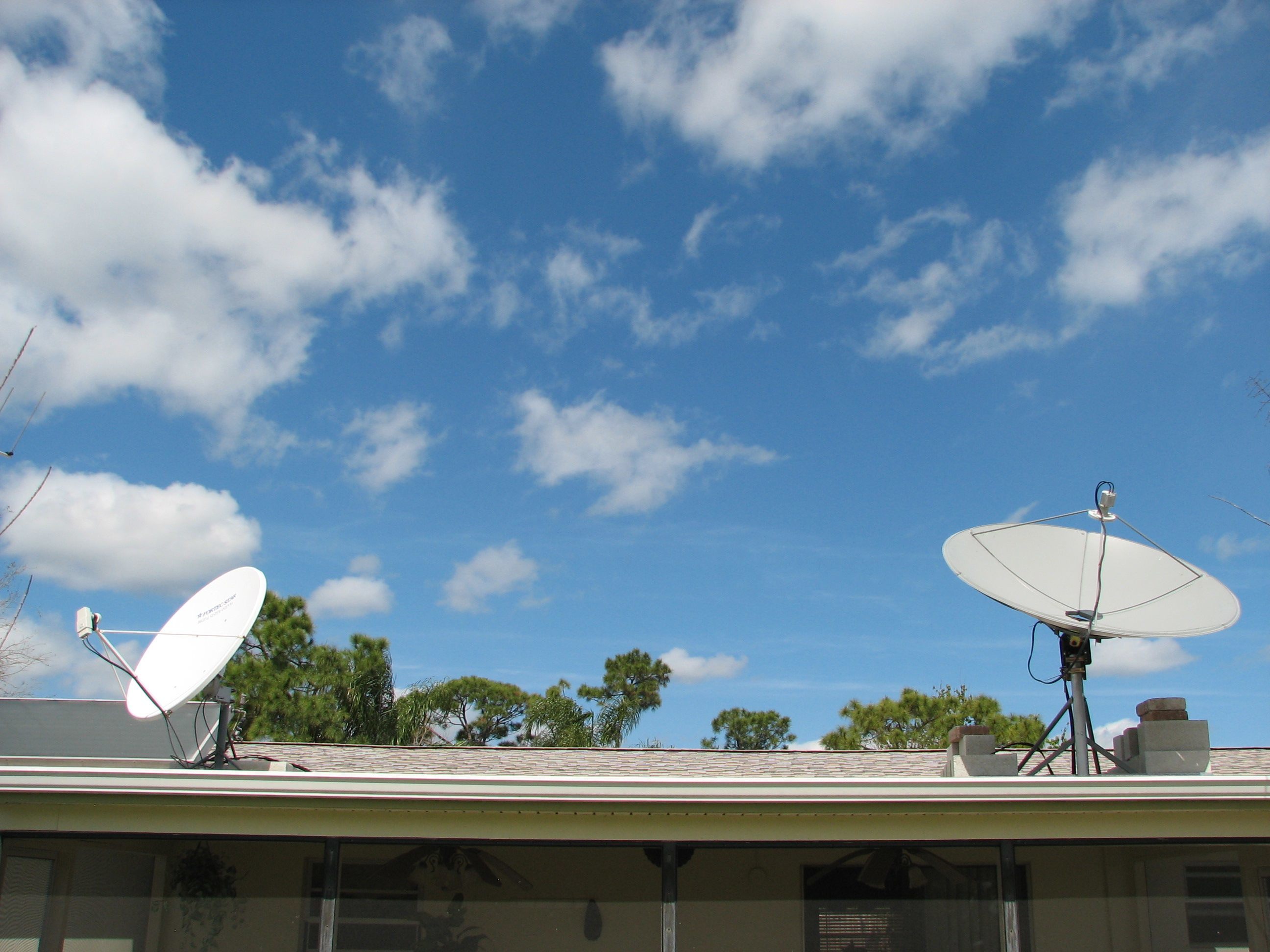

Here are two pics of the soon to be obsolete current setup. A 1.2 meter Fortec on a stab HH120 motor and a Generic 6 footer on a moteck 180 motor. Both have dual feed LNBF's on them connected to a 4x4 switch feeding four recievers in the house.

The blue cylinder at the end of the worm shaft is the potentiometer.
Note the gear reduction to run it.
Regular pots go about 270°, not even one full turn.
I'm sure anyone with that pot can tell if it goes around more than once.
At one time I was wondering how many turns the worm made, moving the dish horizon to horizon.
Because, there are 10-turn and maybe 20 or 25-turn pots available.
But it was only idle curiosity.
Multi-magnet wheels and reed switches are the order of the day. :cool:
Thanks for the pictures Comtech! Looks really good. I hope when you say obsolete, you mean the Birdview or the CM will become the main part of your system, and the 1.2m and 6'er will still be there for back-up or multiple receiver uses. And please don't mean that they will be coming down......? Please don't say that...!
Nope nothing going bye-bye. I will keep the 1.2 for Ku, put the channel master 8footer on the roof here in florida,take the six footer to South Carolina with the Birdview, put the dielectric plate in a bsc621 on the six footer for some atlantic sats with my 1 meter for Ku up there.I spend more time here but I cannot find a place for the Birdview with a line of sight.
