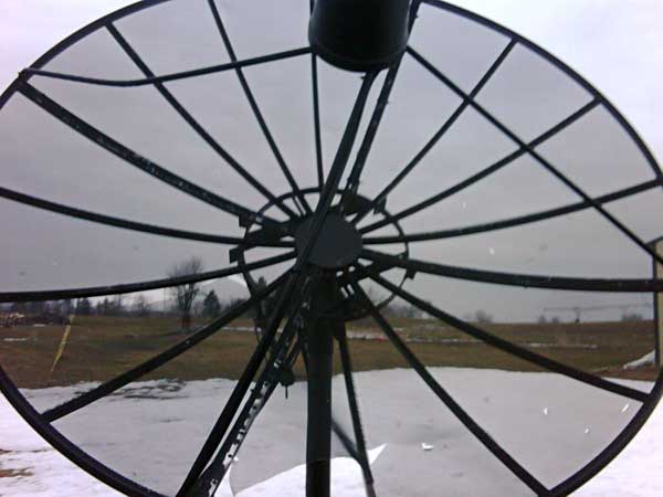

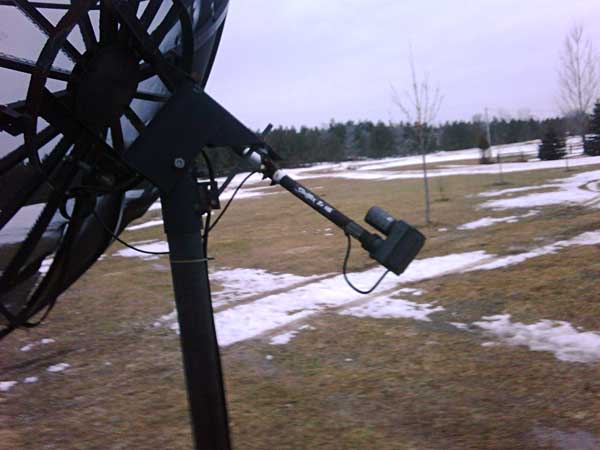

friend of mine sent me these pics.. dish is mine if I want it. All I have to do is go get it.
but I figured I'd add this one in for help in making sure the dish is worth it.
Friend guessed that it's between 8 and 10 feet in diameter.
the mesh is very fine. like window screen (good Ku dish?)
but there is a tear in the bottom and one feedhorn support is bent.
but the price is right if the dish itself is worth it.
any ideas what it is? is it worth getting and fixing?
thanks!
this would make dish number 3 if I get it.. I think I'm hooked ;-)

parts is parts:
Dunsept -
Hard to say much about the dish.
Those pictures don't really show it too clearly.
Without better pictures and an understanding of your need for (another?) BUD, it's difficult to advise.
Also, how far away, what's the cost of gas, do you have your own trailer?
How much do you think the recovery mission will cost?
Don't forget, you need to rent some friends (and feed them). :D
If you're hard up, and dish-hungry, it'll probably receive okay.
I'm sure you can patch the mesh. Doesn't even have to be perfect.
If you have a specific need in mind, perhaps you could continue dish-hunting, and leave this one behind?
I set out to get a very specific dish (kind of a hard-headed plan) and eventually found one, so it is possible.
yea.. she took them with with a phone. I guess it's not that I _need_ that dish.. it's just there and available.. also a friend of mine who lives in metro detroit is looking for a setup and he could use it too.. just wasn't sure if it was really worth it.. ya know? is it some super duper special dish, or just some plain thing that's not worth it..
I have trailers available, and this person would also bring it to work for me, and then we'd just unload from her trailer and put on mine.. so no gas cost or anything really
Well, if you don't even have to go out and harvest it... :eek:
...and they're gonna deliver it for free...
That's kind of hard to turn down. :D
But as to being anything special, I don't think so.
I'm sure some of the eagle-eye folks will identify it from where the LNB arms intersect the dish.
You might find the motor, the LNB, or the panels to be good as spare parts.
Or helping your friend get started would be a generous thing to do! - :up
I'm thinking of a dish recovery as a several hundred dollar expense.
So, if the dish is worth the time, the work, and the cost, then it's a bargain.
I put a higher value on an H-H motor, good condition, and maybe a solid or commercial dish.
At your trivial cost/effort, it's hard to turn down.
(they delivering the pole, too?)
