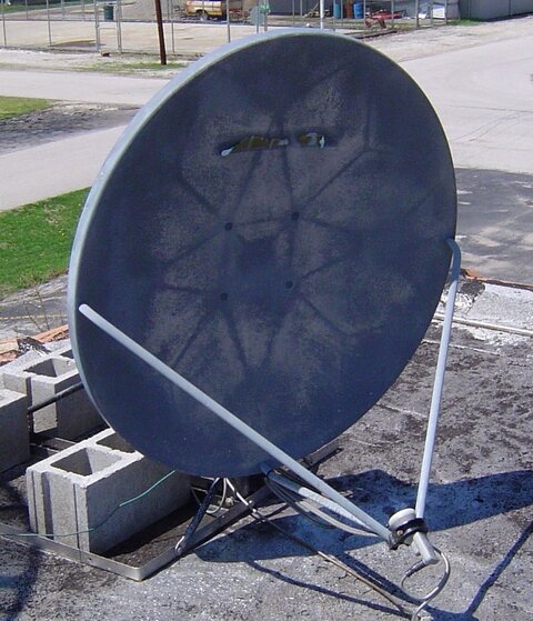

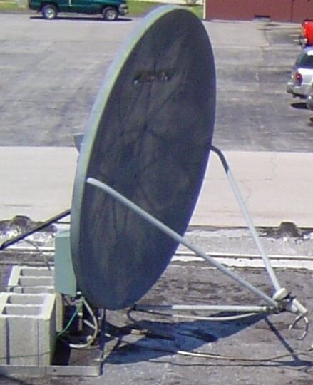

Ok, I thought you might be able to look at these pictures of my 1M Primestar when I had it pointed at Hispasat, which if I remember correctly was at about 14 degrees elevation for me.
Take a look at the angle of the feed support arm from the bottom. Also, not pictured is the back of the dish which was almost touching the mast, but not quite.
I'm sure that is why Anole and Pwrsurge suggested inverting the dish, because from the look of your pictures, the feed is not yet low enough for 8.5 degrees.
EDIT: If you want an accurate reading of the angle of the dish, place a straight edge across the face of the dish from top to bottom and that will give you the true elevation of the dish.
Thanks for that Linuxman, your pictures indicate that I am doing things correctly or at least I am in the ballpark. I have thought about inverting the dish but after modifying the mount (a lot!) I think it will get sufficiently low.
I don't see an easy way of doing it with your mounting pole but when I hit Hispasat from my place I had to tilt my pole about 10 degrees off of plumb to get my dish low enough.
My elevation was 12.2 degrees.
