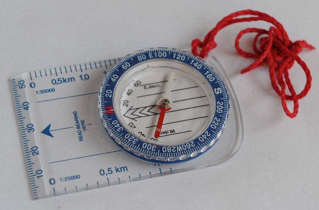

but as mentioned its not hard at all using the actual DirecTV unit; just go grab a $12 heading compass (which no toolbox or glove compartment should be without). and using a 110% plumb/level mast and the proper coordinates, you should be good within 20 minutes
