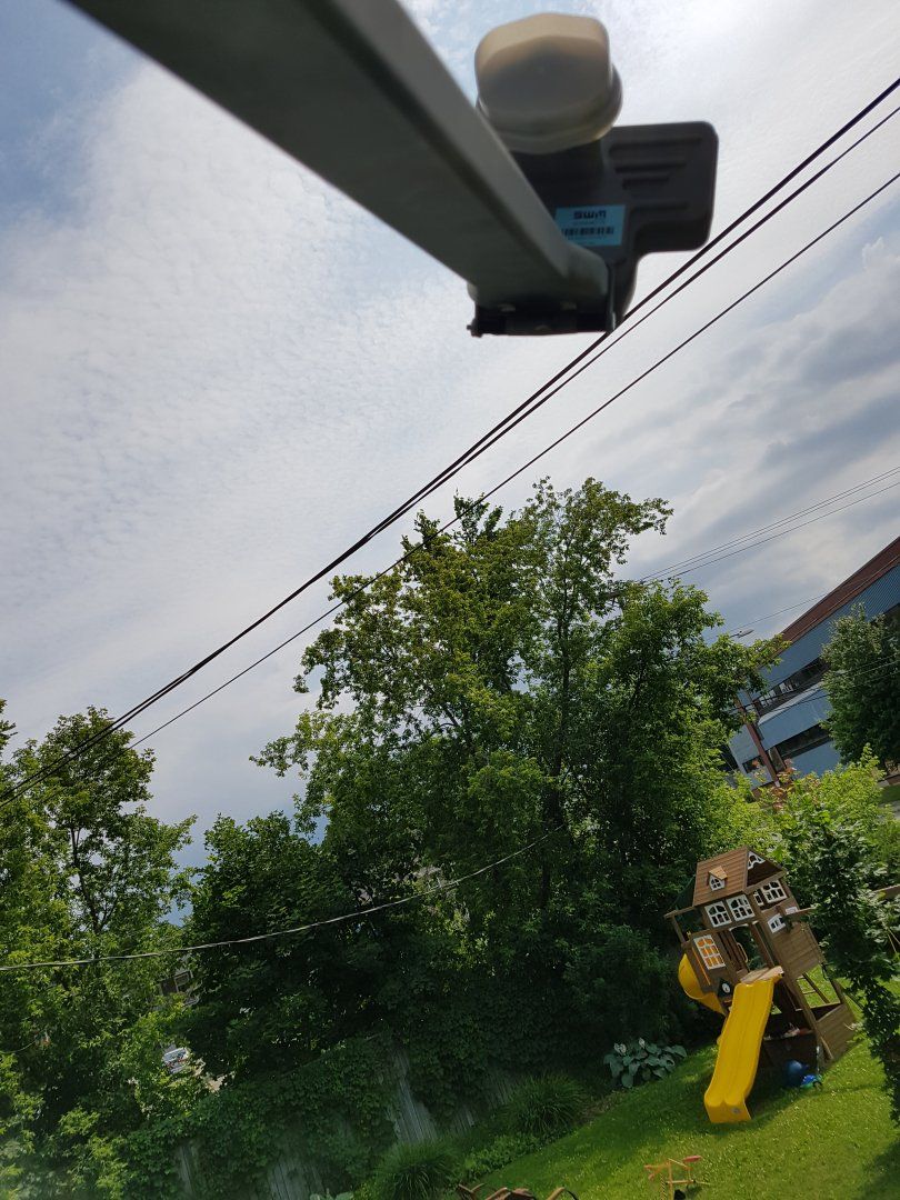

I've setup a few dozen slimlines over the last few years just casually for buddies moving etc. This one here I'm stumped. I'm getting 98% on 101 96% on all 103s but on 99ca I cant peak higher than 70% or 81% on 99cb. I just spent nearly hour trying every combo of adjustments I can think of to no avail. I don't know if it's an los issue or not. Here is a picture of LOS
Any tips ?

The los is probably higher than you think. The actual elevation angle is in the antenna menu setup. Your skew may be off a bit. Are you trying to align the dish with a meter or just the signal strength menu? There are smart phone apps that will locate the satellites for you. They aren't exact, but will give you a good idea of where the sats are.
Just using the meters in the menu. Used dish pointer as always to preset the dish
When you say the LOS is likely higher than I think do you mean the tree likely is blocking to an extent ?
No, I mean it's probably higher so the alignment is probably the issue. That's why I suggesting using an app to get a general idea of where the sats are located.
Well I moved it to a spot I thought would be better LOS 103 now lower and 99 now a bit higher. The fall when the leaves clear will tell the tale. If in the fall I can't peak it any better than we will get a new dish.
It really shouldn't matter what time of year ...
If the leaves are off the trees in the fall and you point it, it won't be any better than if you point it now.
