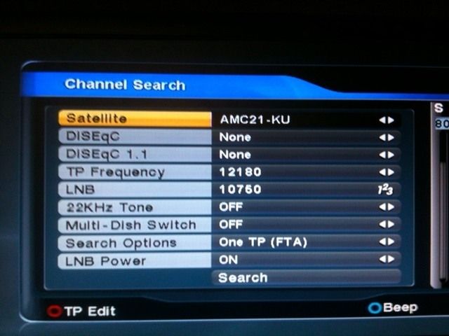

I am looking to aquire the signal for AMC-21.
I am aware of the dish pint settings.
But can someone please tell me what the DSR200C settings should be?
This is a fixed dish setup BTW.
Thanks, Mark.
Hey Mark,
Just rescanned 125W Ku with my CS5000 - try TP 12175H4444(SC ETV) instead of the 12180V30000. Use the red TP edit button to delete old TP & SRs, then add your own.
