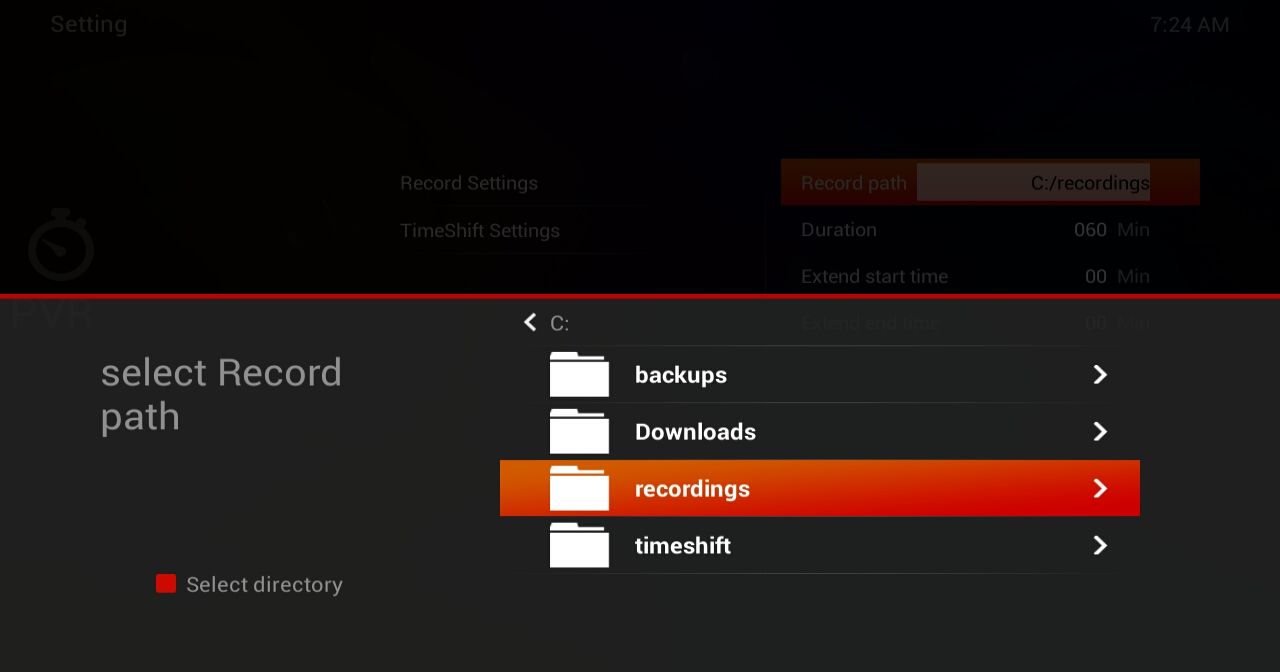

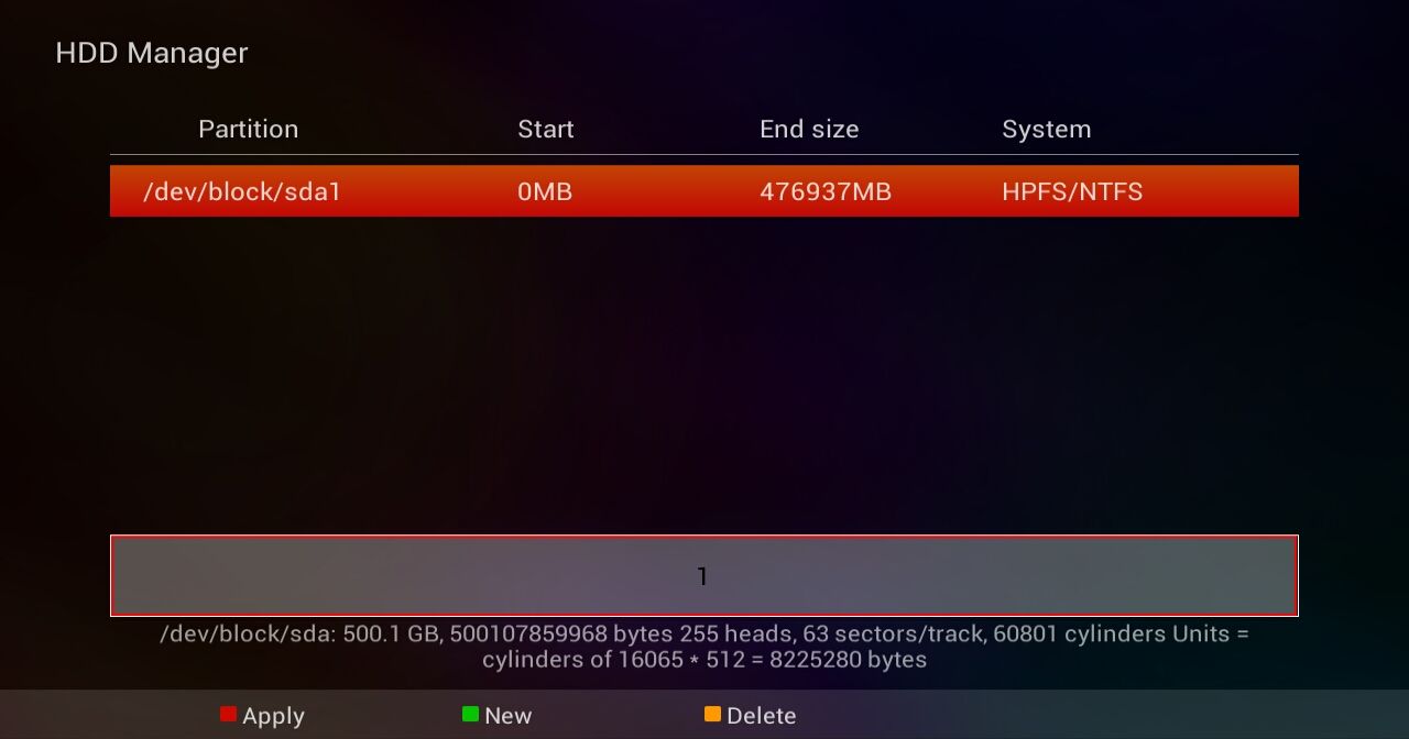

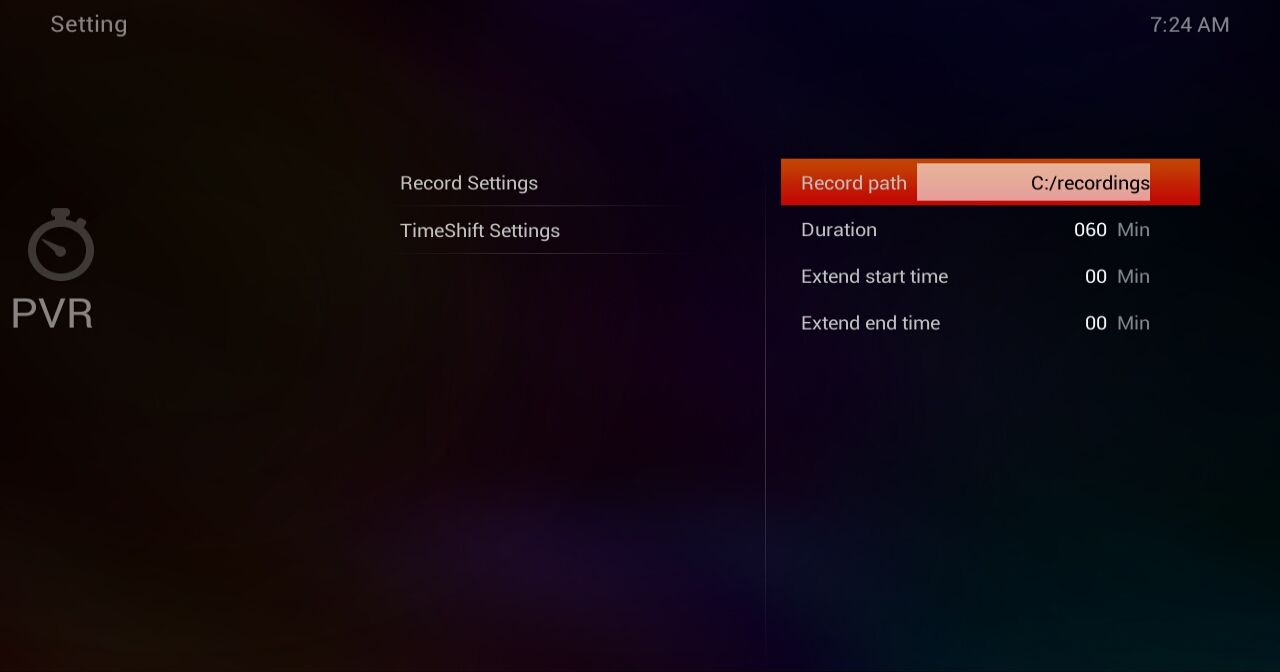

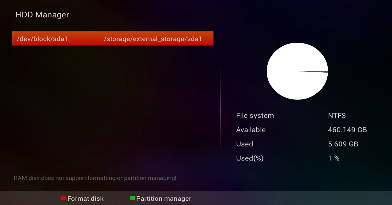

Now that that issue is wrapped up, I am still having problems with recording timers not executing.
I have my A3 set to get it's time from the internet and it's 100% perfectly in sync with the atomic clock on my wall and my Macs. So I know it's not a clock being wrong kinda thing.
I deleted all the timers and made new ones from scratch but they aren't executing..
The timers that move the dishes a minute before the recordings start are set up as "tune to channel".
I set them up because it takes about 30 seconds to move the dish and let it lock onto the signal. So if I want to record at 7pm I move the dish at 6:59 then a separate timer is supposed to record.
It seems that they don't record for some mysterious reason at random. It always moves the dishes but doesn't always record.
And the disk is extremely empty. There are only two recordings on it from previous saturdays.
I have no idea what's up with this thing.

Logic tells me if the timers move the dish, but timers do not DVR and no one else is reporting DVR timer execution errors, the problem is likelyrelated to the drive.

I think you still have to put 1 minute buffers between shows, just like the microHD. So, say if you have a recording for 1 hour at 9pm, and a second recording at 10pm for an hour, you'd set them as: Start time: 9pm, 59 minutes, Start time: 10pm, 1 hour.
The first show will record 59 minutes, and have the 1 minute rest time before firing the second recording. The second show will then record 1 full hour. If you have a 3rd back to back recording, the second show would also have to be 59 minutes.
At least this is the way I've been doing them.

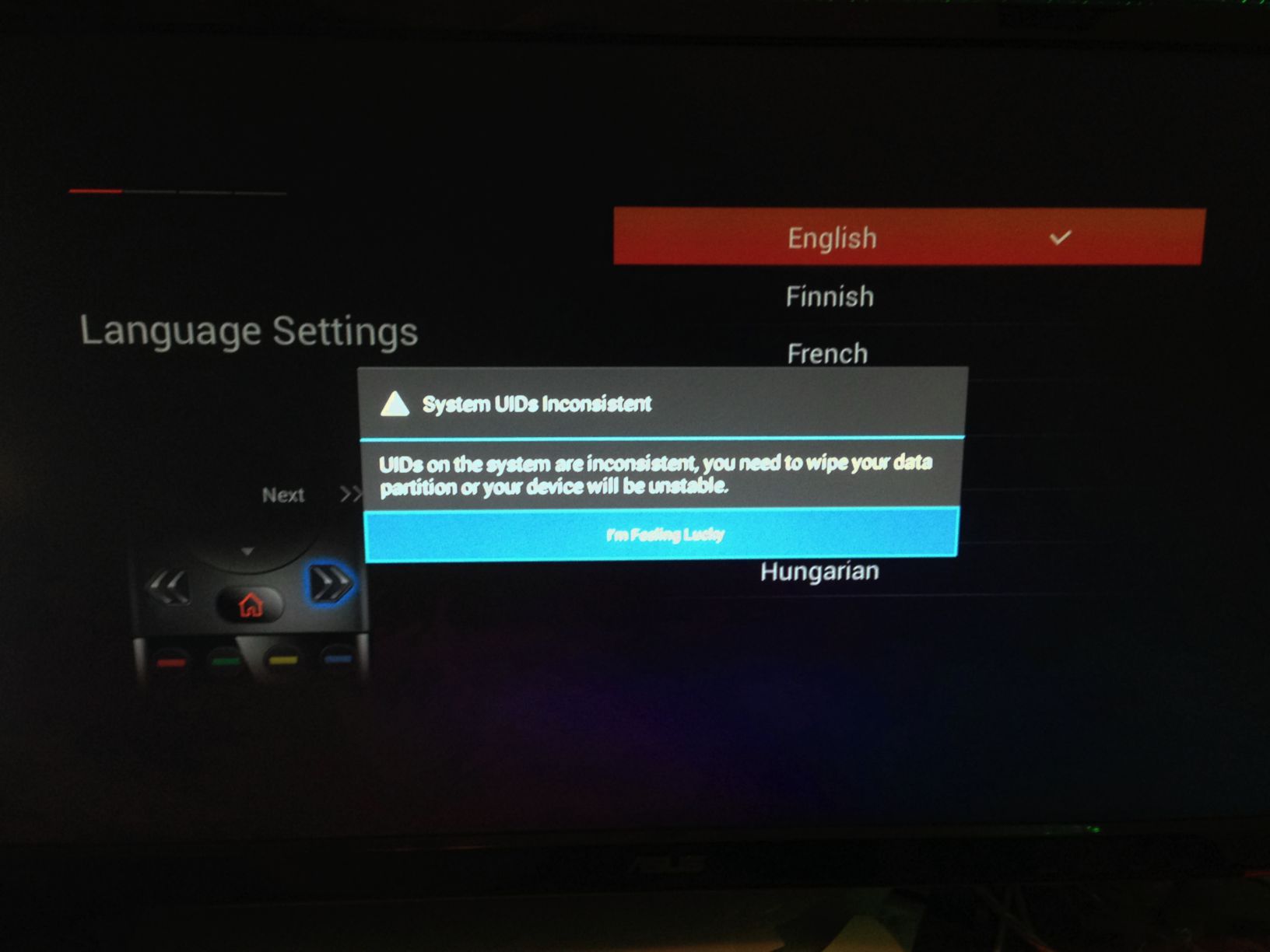

My A3 just nuked itself. It was locked up and would not respond to the remote control, the web interface or my USB keyboard.
It was still playing a TV channel but was unresponsive otherwise.
I had no other choice but to pull the power cord on it.
Three times it stuck on "boot" and after waiting like 10 minutes each attempt I finally unplugged to for 15 minutes.
When I plugged it back in it came up and said "UPGRADING" and I could not stop it from this.
It then came up with a screen that said the UID was corrupted and that I should erase my data.
It forced me through what appeared to be the setup routine for a brand new machine, asking me questions about language and such.
When it finally let me past that it was WIPED.
All the American stuff is completely gone, it freaking reset itself back to the freaking EUROPEAN stuff and it is freaking RUINED AGAIN!
I DID NOT MESS WITH ANYTHING! THIS THING DID THIS ALL ON IT'S OWN !!!
My A3 has been rendered useless to me.
NOT BLOODY HAPPY...........
Bah humbug....
Not sure what could have caused the lock-up, but It will only take a few minutes to restore to the NORTH American ROM from the back-up of the original factory files. Once restored, you could install your user settings if they have been recently backed-up.
What exactly were you doing, watching, etc, right before the lock-up.
It is aggravating but at least it is an easy fix with your back-ups.
