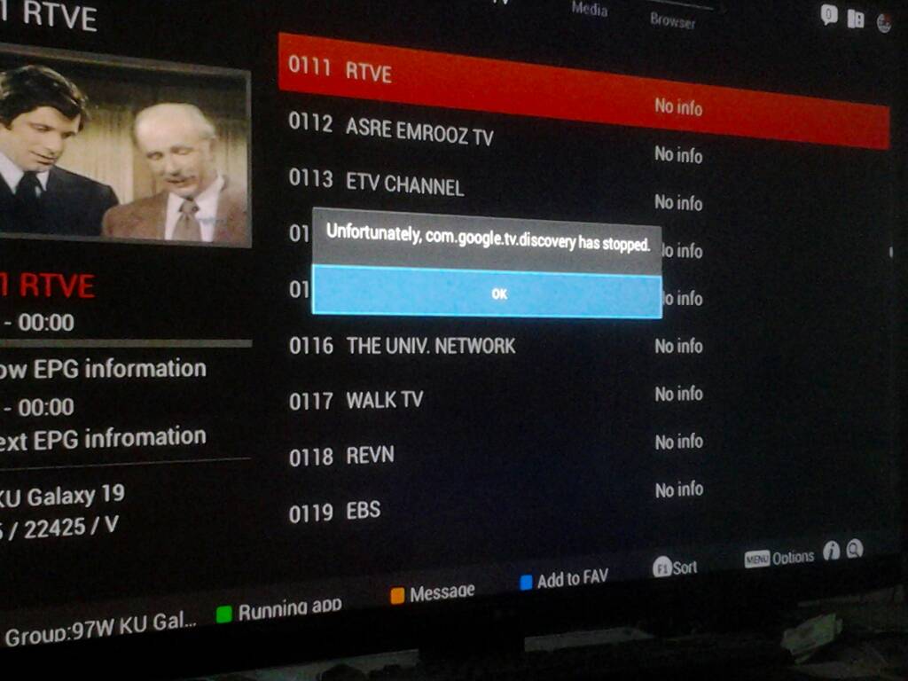

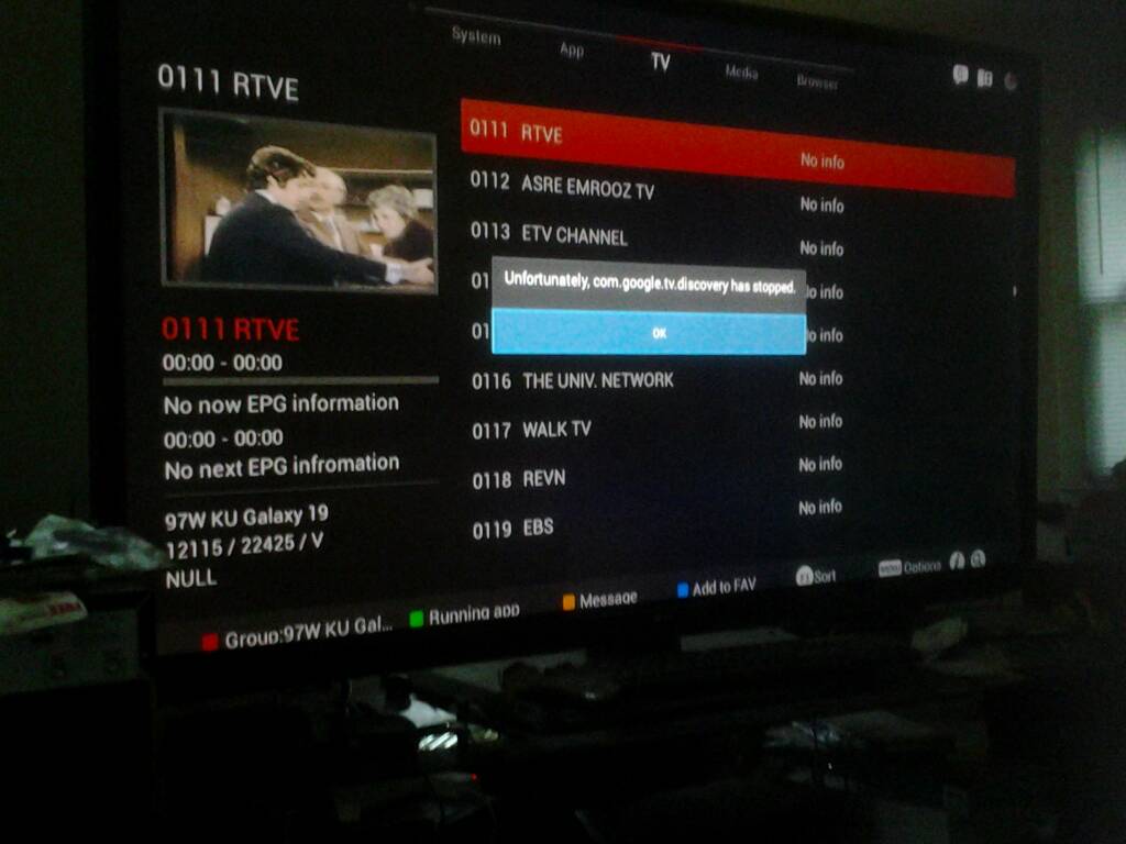

Hey, anyone know how I can get rid of " unfortunately, com.Google.tv. Discovery has stopped " ? I've already done the recovery screen thing so I don't know what's going on.
Have you tried doing a Restore?
Sounds like an APP you have is not playing nice.
Sometimes un-installing and re-installing can help.
Yeah, I done it a couple of times delete user data clean cache to no avail maybe I'll just start uninstalling apps the problem is that screen doesn't go away it's really hard to do anything because it's always in the way demanding attention.
