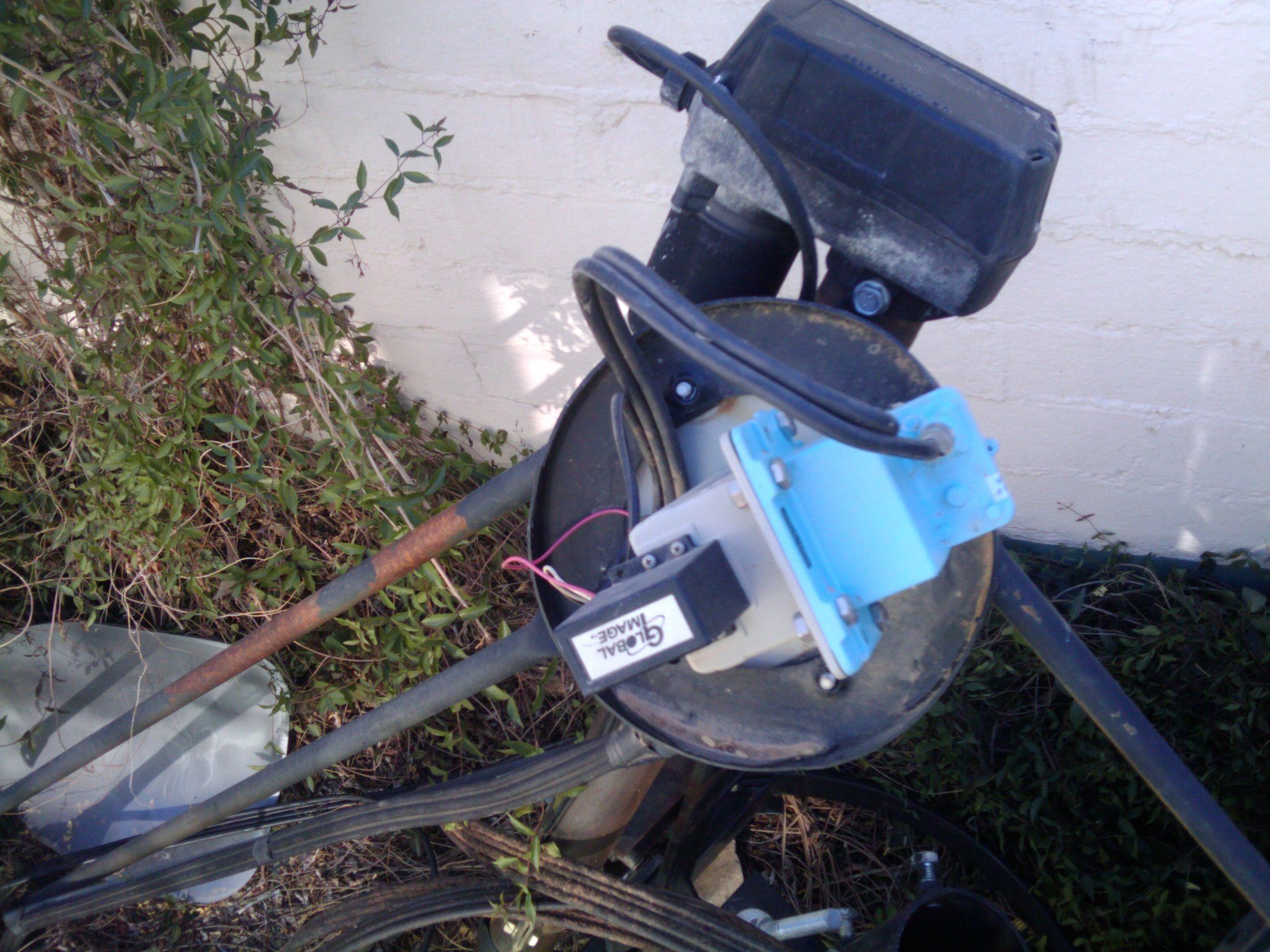

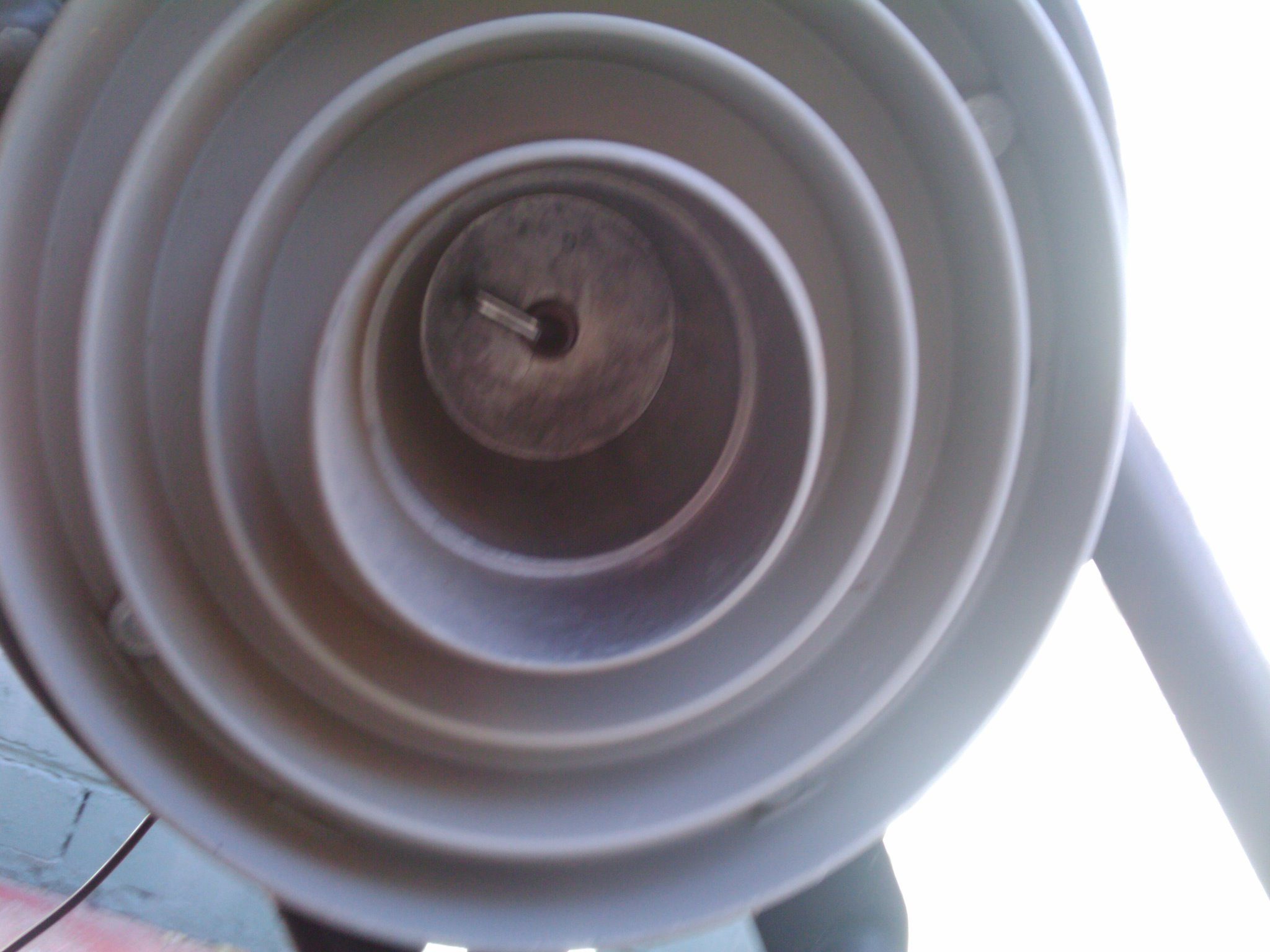

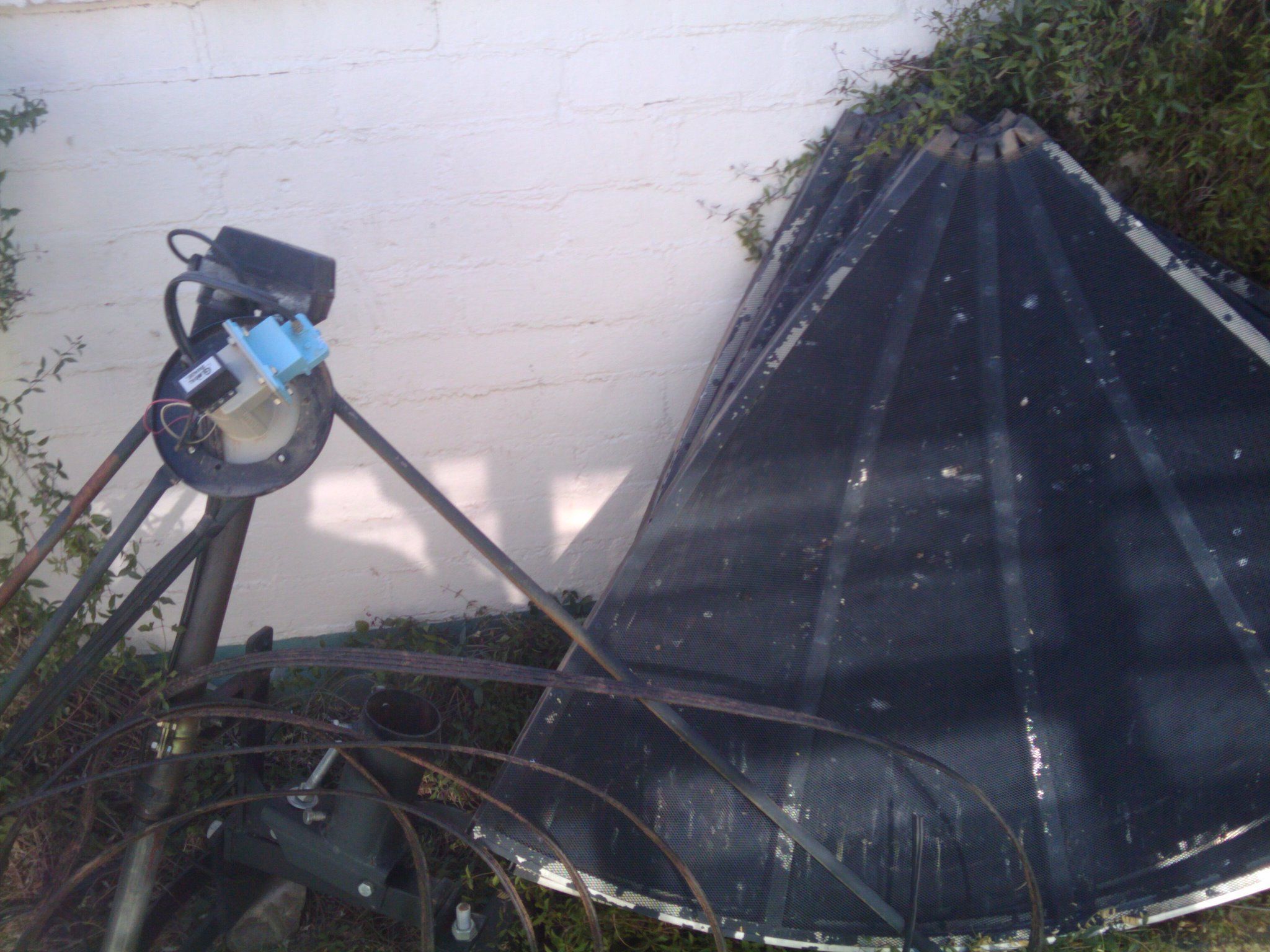

hello attached are the photos of my c-band dish I had to jump in to non pda mode to do this this non pda mode isn't verry blind friendly wish there was a simpular interface I had to also click on the switch text editor button to get this to work anyways attached are the photos can some one tell me if all is there if I am missing anything besides, gbox, cable wire crimps to fix the cable? my mom also took some photos and is emailing me the this weekend I will post those as well fore better shots I don;'t know how these came out sense I am unable to see them. Hank

That seems to be a pretty complete pile of parts, once you get a pole set for it, and have the bolts/nuts to re-assemble, you should be on your way. If you're cable is ok, yes you'll need cable connectors. I wouldn't go for those cheap twist-on types, get the crimp-on RG6 connectors, or best would be the compression connectors. Both will need a special tool to fit them properly. I think I got the compression tool and about 10 connectors thrown in with it for about 25bucks at Lowe's Hardware store. Similar stores close to you should have one, or one of our sponsors here. It's not that hard to put it all together once you get started. With help from a sighted friend I'm sure you will both learn a lot. Just be sure you get the pole as vertical in the ground as possible, use a level to check 'plumb'. And put it where you have as clear a shot as possible of the southern sky, from due south, to southeast and southwest so your dish can hit as many satellites as possible.

You could look around for a scrapyard or a welding shop for apiece of pipe to buy. Last time I checked at a real pipe shop they wanted premium price for a piece of 3 1/2" and wanted me to buy a whole section which was about 18-20' lol. I've gotten them at a junkyard for much better price and they'll usually cut it with a torch if needed. Just be sure you get one machine-cut end to mount the dish on-put the cut end into the ground. The mount needs to set flat on the pole, to be level as possible to track the satellite arc properly. Any humps or ridges on the top of the pole will throw the mount off. You need to check that when you concrete in the pole, top of pipe is level and pipe is perfectly vertical.
has any one on here ever sold poles on the boards? I am a payed emmber so do have access to the swop board if any one wants to help out it would be appreciated. this 7 foot dish is the only one I have besides my direct tv dish that was given to me whitch I posted in another post it looks like it isn't really recommend fore fta so currently I got my cband dish only. can some one sighted tell me if this will be able to recieve ku band okay? also I couldn't feel the lmb is it on there? or is that missing? thanks guys fore your awesome support. I couldn't have gone this far with out your all. Hank
Hank, that dish should be fine for c and ku, the lnb you have in the picture there is c-band only, its the part the cable is plugged into. You'll need either a c/ku feedhorn plus a ku lnb, or just a c/ku lnbf instead. With the lnbf-type, you'll change polarity (vertical or horizontal) with voltage from your fta receiver. With the older type feedhorn in your picture you'll need an analog c band receiver , or the vbox or gbox, whatever its called now. On the older type feedhorns, polarity is switched by a little motor mounted at the end of the feedhorn, called polarity motor or 'polarotor'. Most fta boxes will not supply the voltage to that, hence my suggestion for the newer, lnbf which is voltage controlled. Hopefully some of our members, if we have any in AZ can contact you to assist. I'd be glad to if I weren't so far away!

Hank, you have a feedhorn and lnb, should be ok. It's a c-band feedhorn, with a c-lnb attached.
