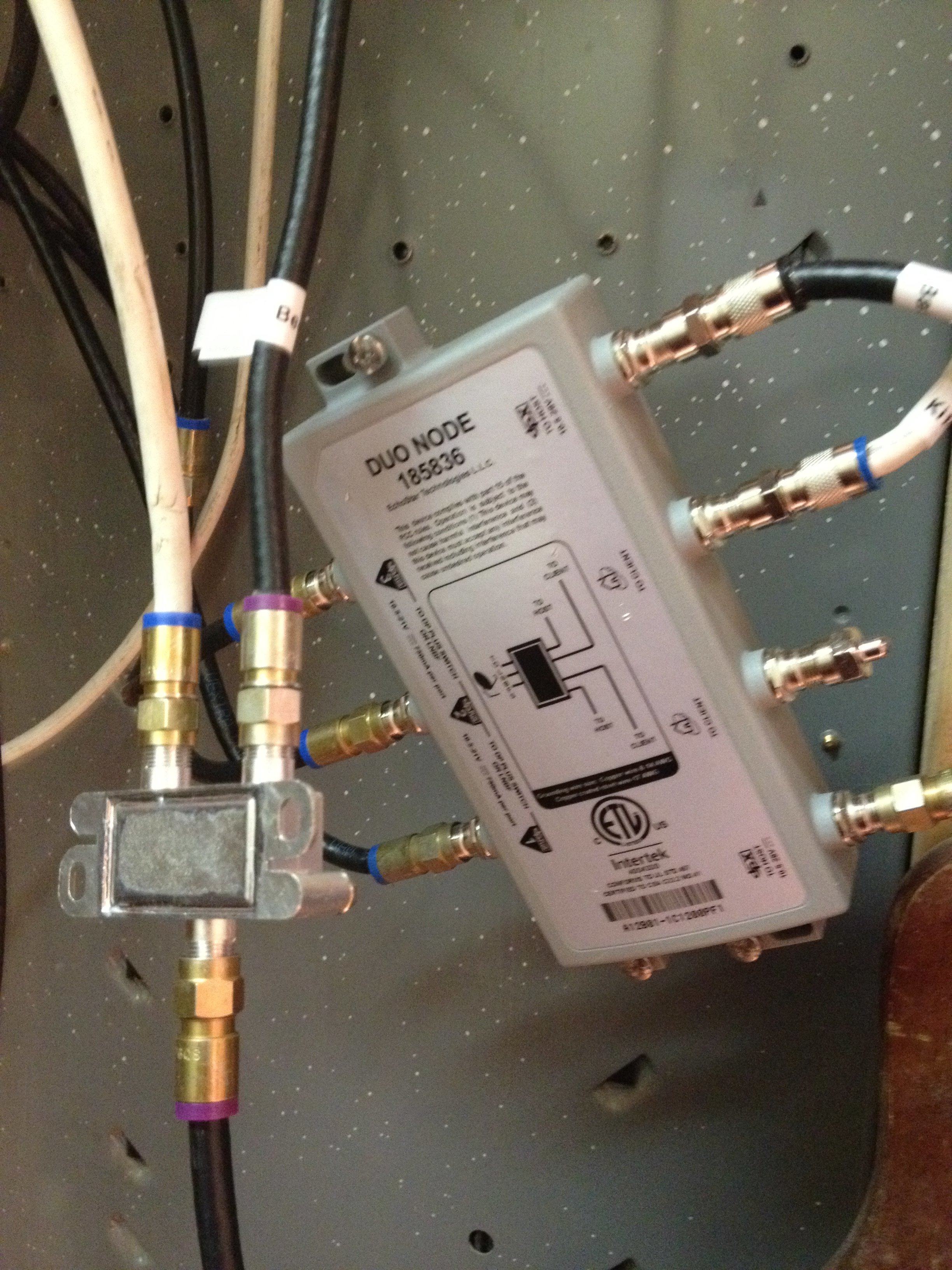

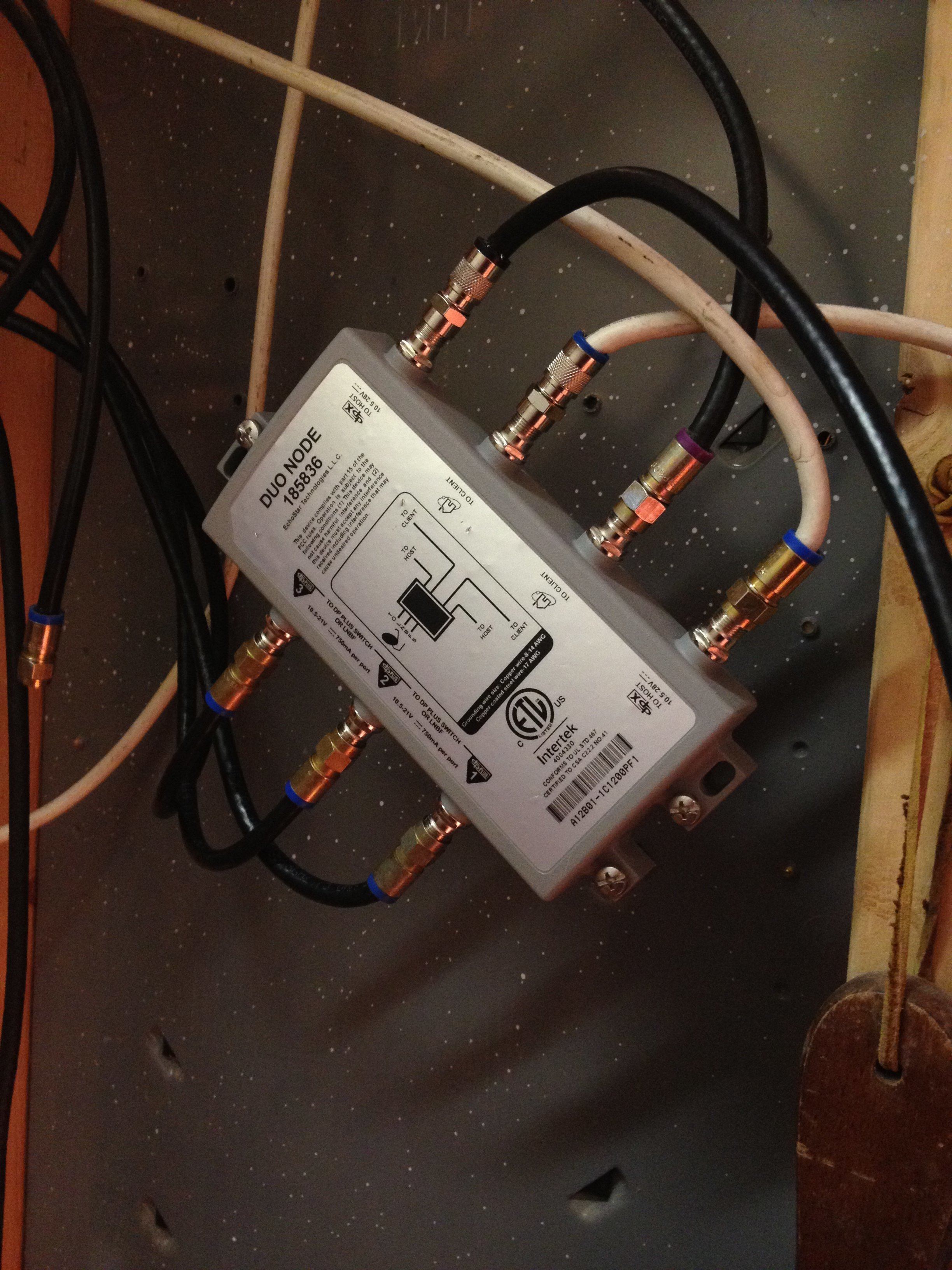

So my 2H/2J is up and running. A few note for those that are installing a 2H/2J install.
If you plan to pair 1H to 1J, the installer put a splitter on a single "host" node and the joeys on the client nodes. He wasn't able to configure the 2nd joey to connect to the 2nd hopper until he did this. he also added a terminator on the open client port. When the "joey talking to 2 hoppers" software upgrade goes out, you just need to remove the splitter and plug the other joey into the duo client node. See before and after pics:
Also, the installer told me that a 2H/3J install isn't enabled in the system. Not sure if that's true, but figured I'd post FWIW.

What if I don't want to limit a Joey to a single Hopper? I want my Joeys to see both Hopper's.
