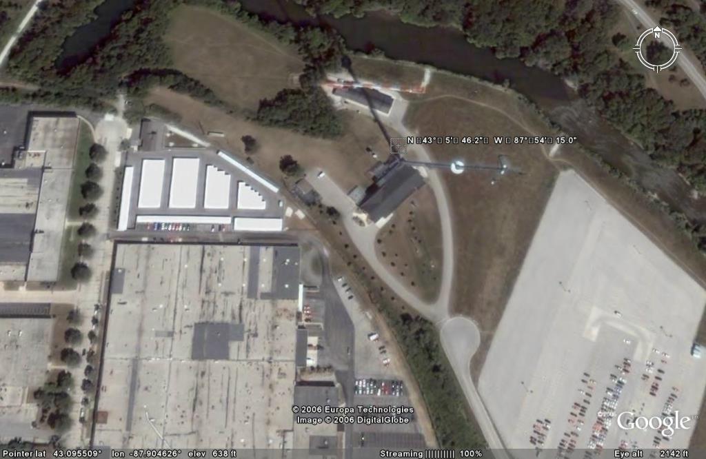

Well its about 30 miles and 93° to that DMAs towers from that zip code.
WMVS-DT PBS being the lone VHF channel; so if that is of no concern to him look at the UHF only; if he wants it all, and I would, look at the combos.

P.S. Here is an aerial snapshot of the tower location.
