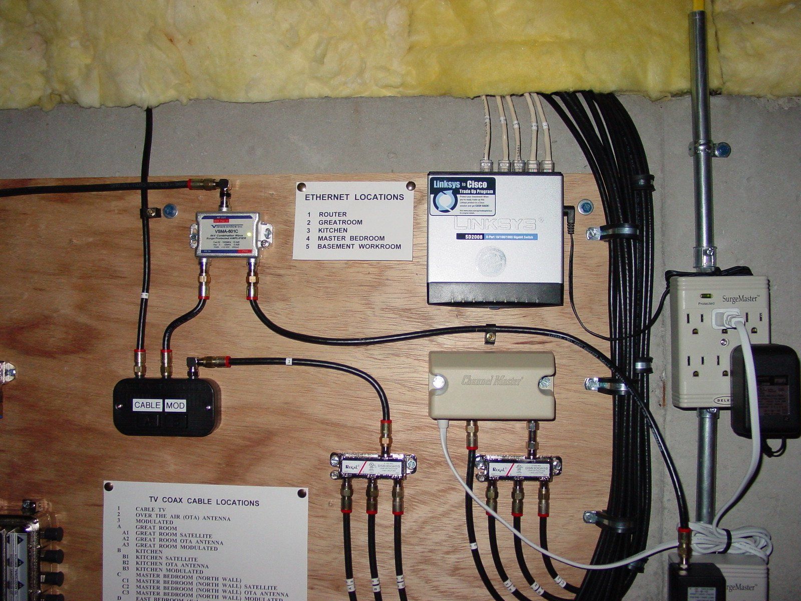

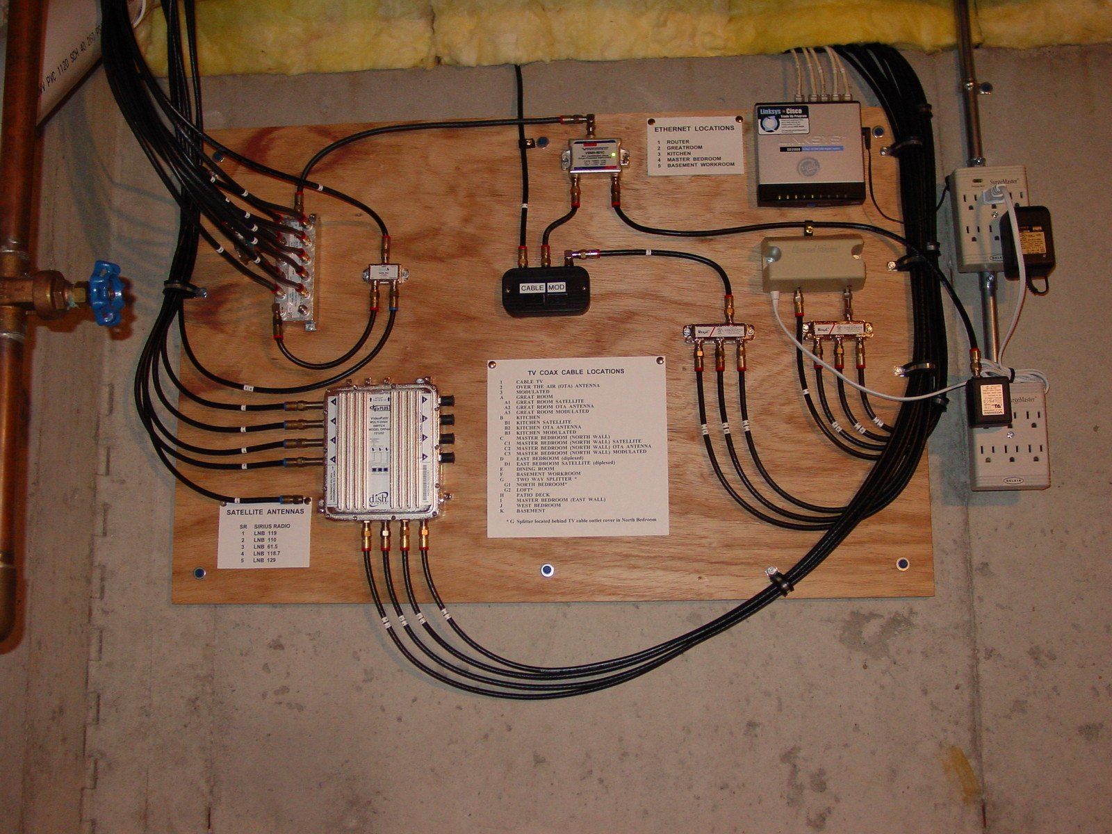

I was going to use the Super Home Node but decided to to combine the modulated and OTA antenna signal a little different. My OTA signal goes directly to three DVRs. Also the same DVRs send out agile modulated signal to all TVs (13 locations) thru out my home thru the home distribution system. Also, at each DVR location, the nearby TV can also receive the modulated out and recorded program from all DVRs. Also, have basic TV cable service going to an A/B switch if Satellite and OTA signal is not available. Everything works great. The Super Home Node is really just a splitter turned back wards.

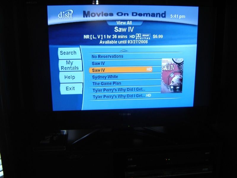

Could someone post a picture from DISHOnline menu where is the "HD" version of movie marked or described.
I did scroll thru 439 movies on 622 yesterday and checked a few items like Transformers, but don't see any hint if it HD or SD.
Is this what you're looking for? I saw at least 5 or 6 HD movies, all for the cheap price of $6.99. :)
