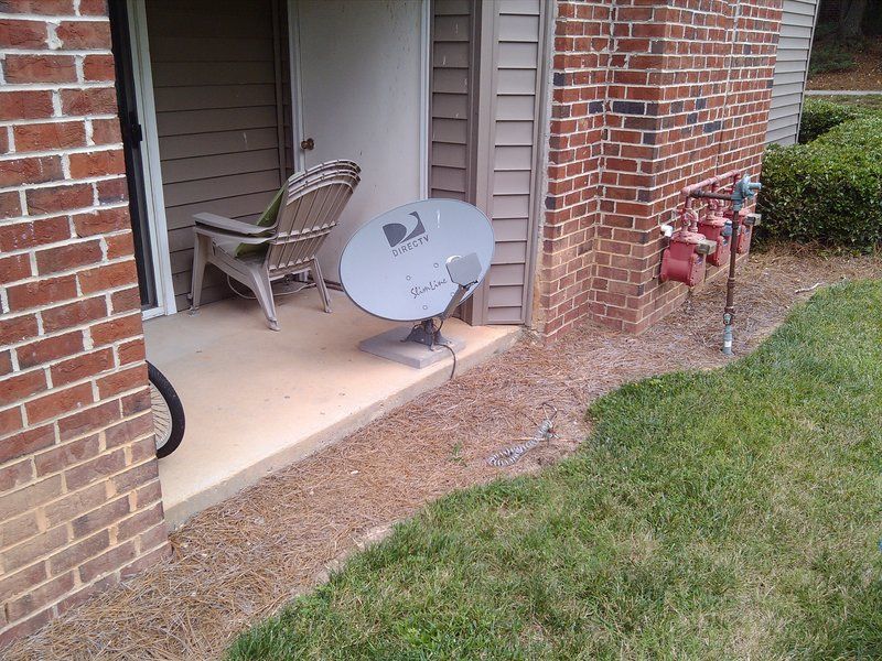

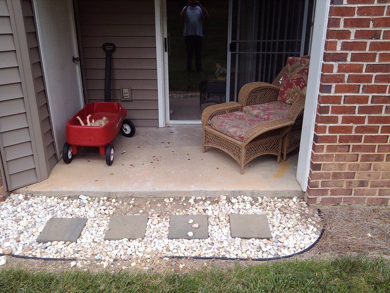

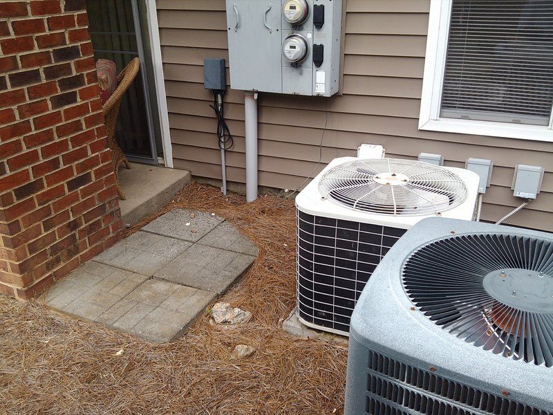

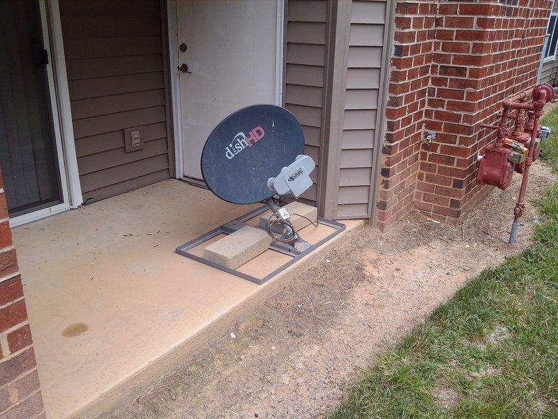

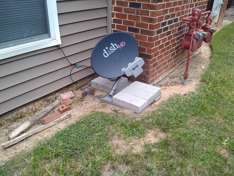

Here are a few pics if you'd like to give your opinion. The ones without the dish are of my patio and to the left of my patio. The others are examples of what a few have done for installation. I talked to my apartment manager and she said normally you need to have it on your patio, unless you have area near your patio where the landscapers do not need to take care of. I was thinking that area where the concrete slabs are would be a good spot to place the dish? It looks like there will be enough space for someone to get around if they need to look at the electric meters. Or maybe it would be a safer option to place it on the patio? Also, in a couple of the other pics, it looks like they are using some kind of metal bracket and then they use concrete slabs to weigh it down. Is this bracket available from the installer and how much does it typically cost the customer? Thanks again for all of your advice!

The "slab" are really pavers. If they have been there a while, they have probably settled, but if they would do any more, it could affect your aiming.
I thought maybe I could get that bracket on top and then put some concrete blocks/slabs on top of the bracket as seen in the other pictures?
I would remove the pavers entirely, then do as you imagine from the photo.
Pic 4 looks like how I would do it (except you have reverse floor plan) but I wouldn't skimp on the blocks.
Here is another tip, take a marker or tape and mark the corners of the mount on the patio so you could realign it if it gets moved.
