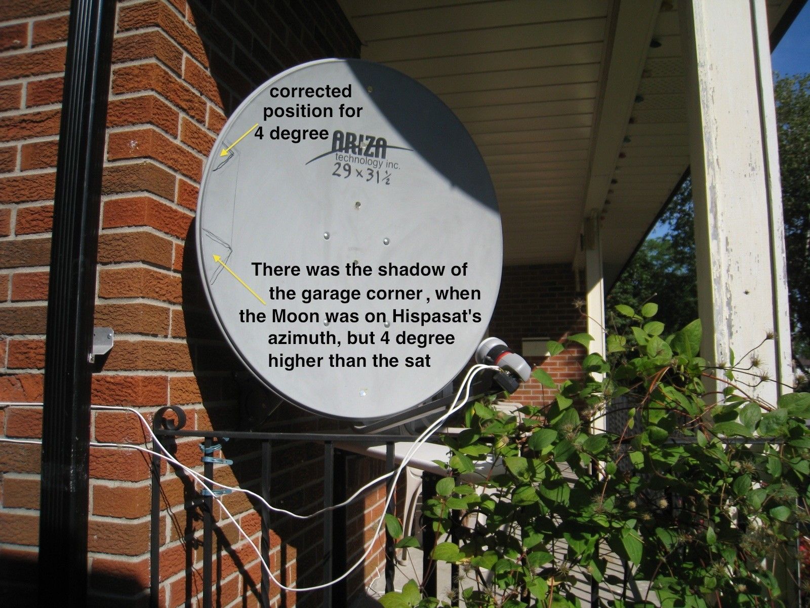

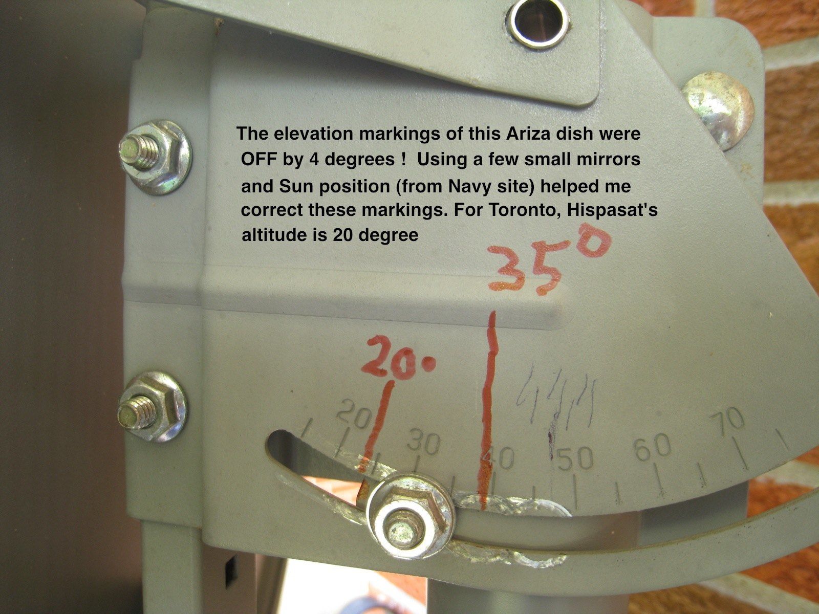

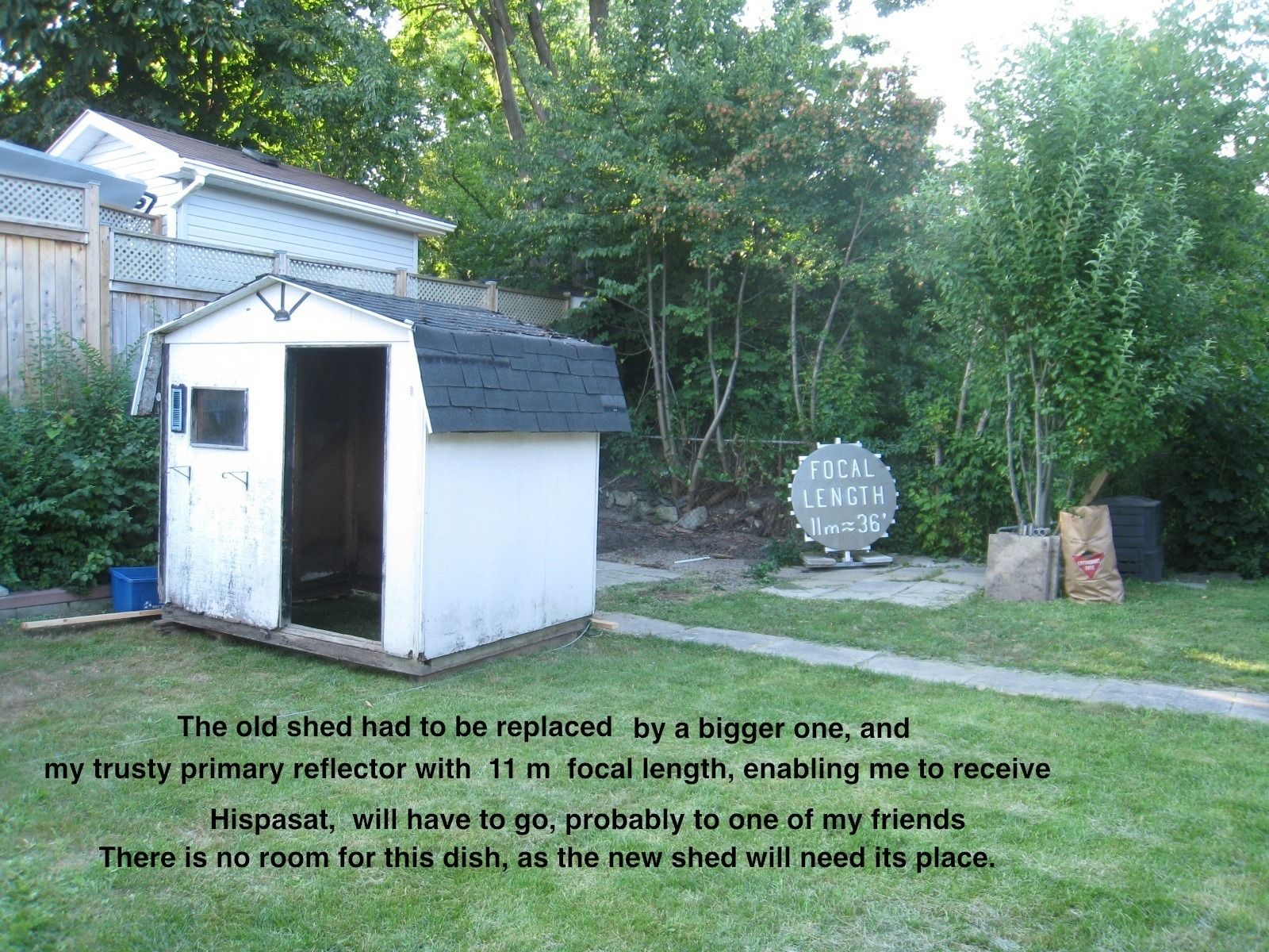

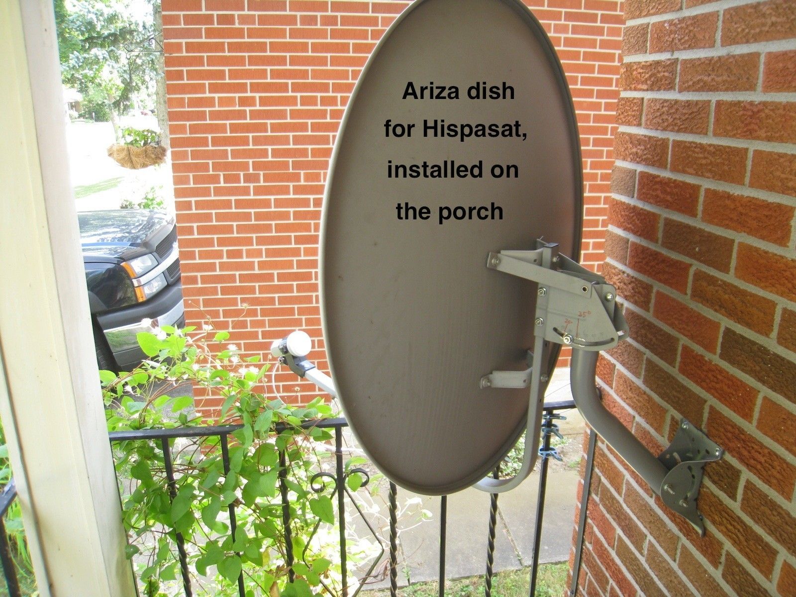

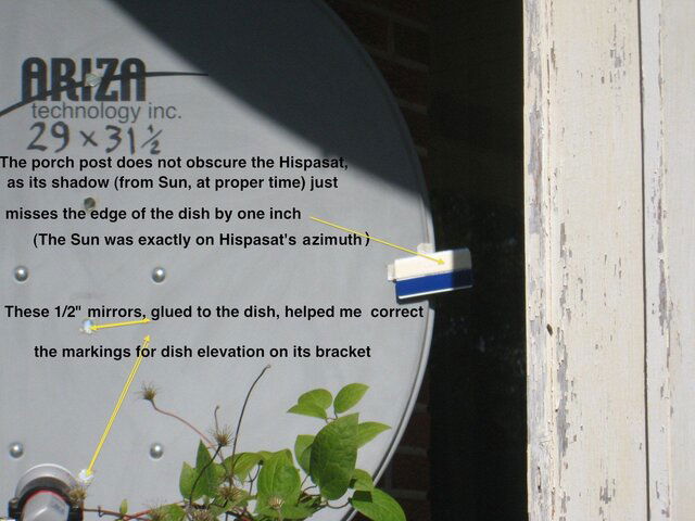

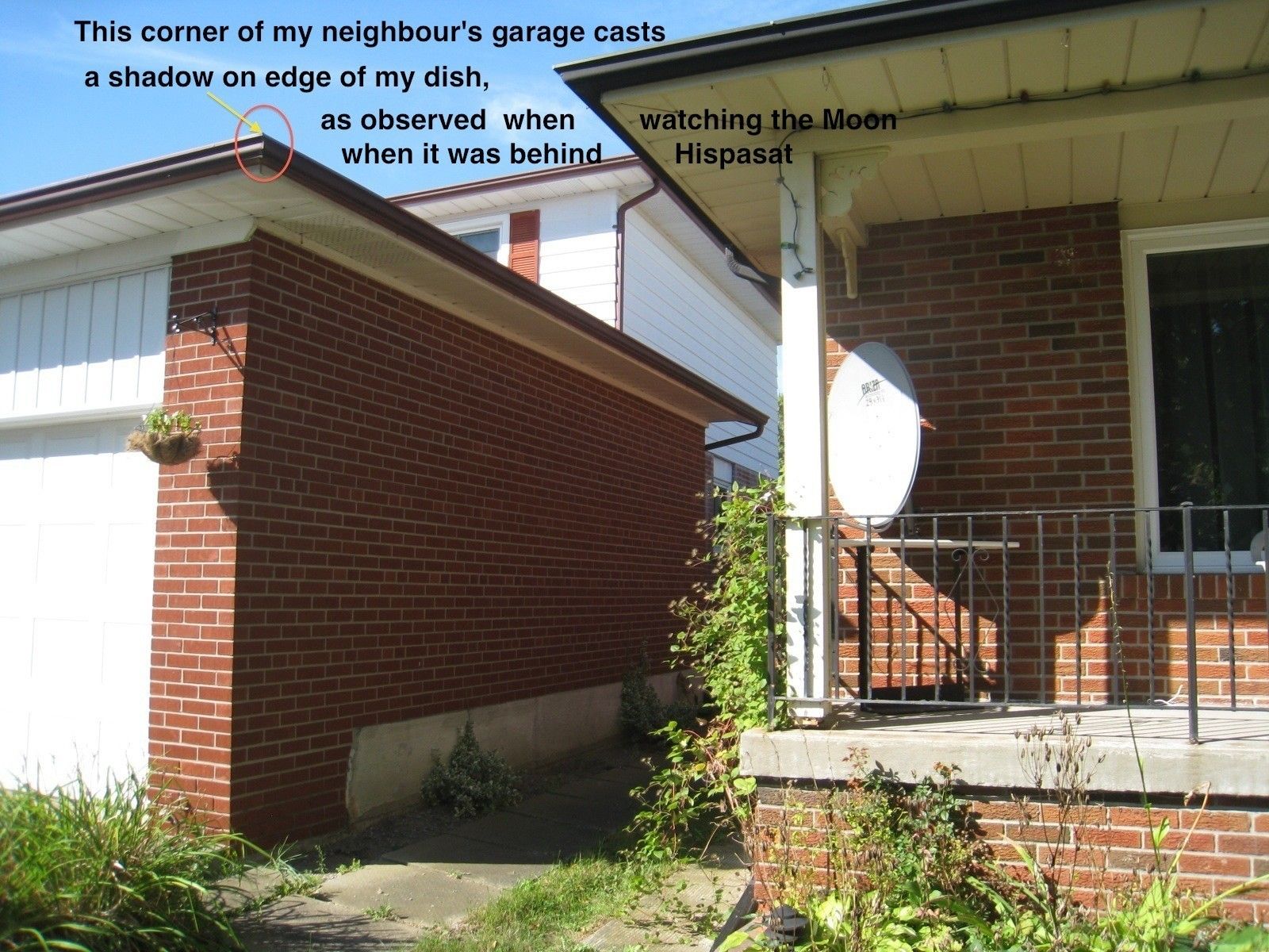

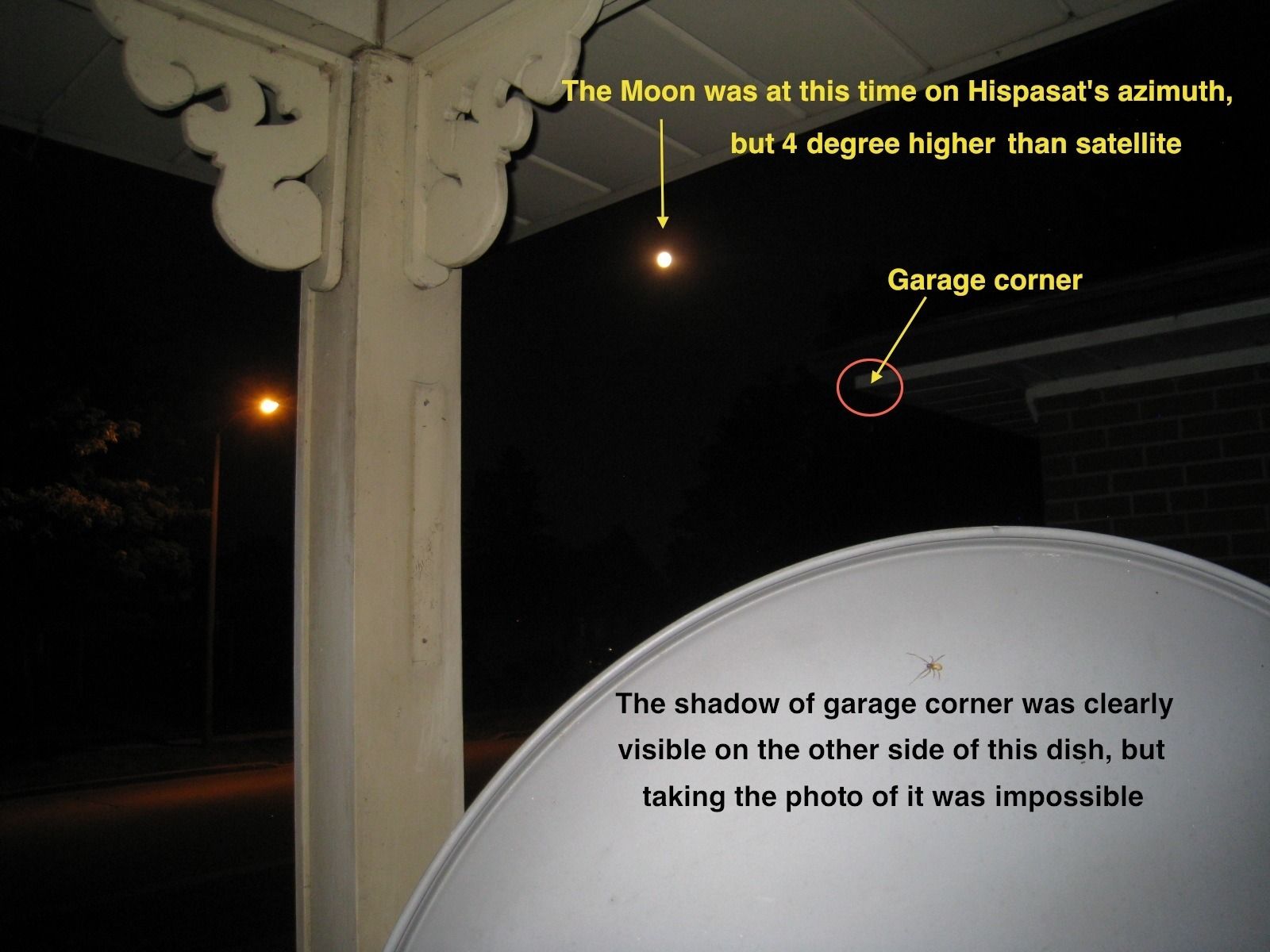

My experimental long focal length dish, shown on my avatar, finally has to retire, as I need its place for a new bigger shed (not built yet). I had to try hard to find a location for a regular dish which could "see" Hispasat. More description on included 7 pictures. IMG_0848.JPGIMG_0820.JPGIMG_0955.JPGIMG_0954.JPGIMG_0956.JPGIMG_0863.JPGIMG_0822.JPG

During the summer I have to be creative to get 30W here because of the openings in the trees to the east. I have tested out several dishes when I had the experimental test setup and found on a clear weather day I could even get away with a small Dish500 converted with a universal LNBF. I first pointed with on old Primestar dish and had a signal immediately.

Thanks, Tron. It works now, with even better quality than my double reflection system. Had I figured out this "tunnel" from my porch to Hispasat earlier, probably I wouldn't have made this double system - but it was fun to build it.

Well, there is no shed now (the old is dismantled, and new one waits for base: gravel and 25 patio stones). Another thing, I personally dislike installing dishes on roofs, running cables from roof and under soil or under patio stones, which are around my house.

Like I said to Primestar, I do not like dishes on roofs. Too prominent, dangerous to install and difficult to service. Not solid, unless one finds the joists, all the messing with silicon... running the cable over the gutter... I prefer to investigate, measure, observe heavenly bodies - squeeze the last inch of "tunnel" to Hispasat - instead of hard work:D. Other members, like Chapelrun and Dan Rose also like to conceal dishes.
I have run traditional RG6 (78' of it) on South and West wall of my house, using - instead of plastic clips, anchors and drilling - just a glue gun, bridging with hot plastic of upper and lower bricks, where the RG6 was in the gap, on the mortar.
These cables you noticed, are not CAT5, they are just ordinary 4 conductor 22 AWG telefone cables. I described that they worked in a contest post run by pwrsurge, page 9, post # 52. Interesting, Quality was in the range of 40, but the Strength was only - 1 % ! And it worked, even with obscuring 40 % of the dish with metalized styrofoam. These tel. cables were also attached to the brick wall with glue gun, now it is very easy to remove them without any trace, no holes to fill. Cheers, polgyver
