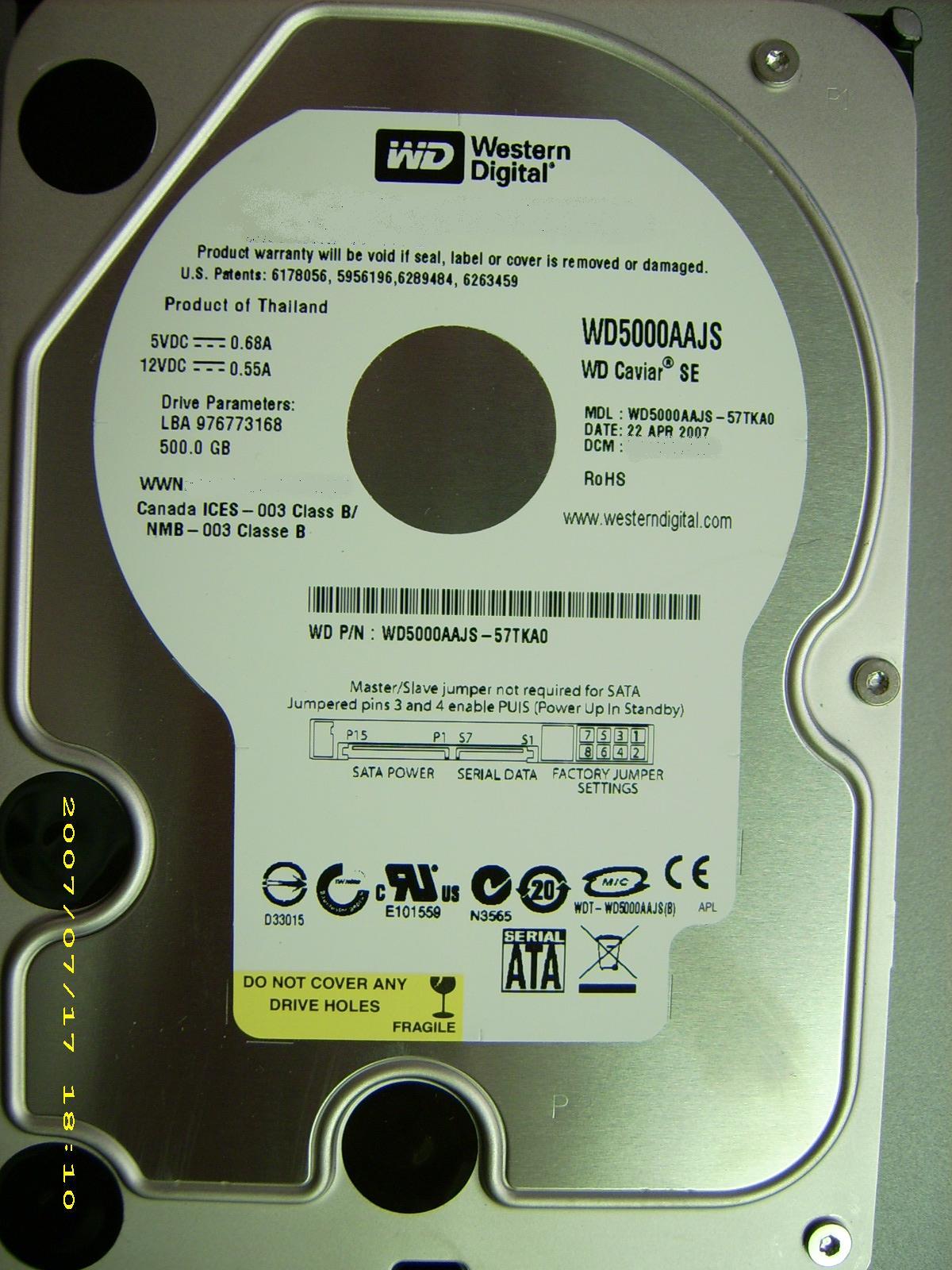

External storage for 622HZ doesn't work at all - no messages, no menu - nothing !
The DVR have WD 500 GB disk, but somehow AT&T/2WIRE make available only 19 hrs HD content for us. :(
