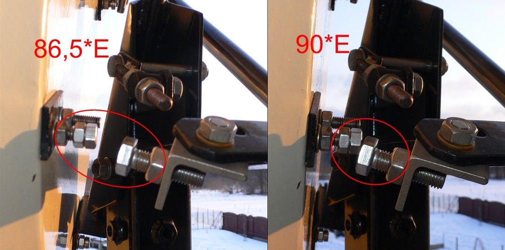

I make this gap controllable by mechanical means, so, never get flop-overs. At the same time West/East separation is not less than 125 degrees. I call this measure- mechanical stop ScreenHunter_582 Dec. 27 22.50.jpg with that you can even remove actuator from antenna and antenna will still stay in the most-East or most-West position.
Reactions: ayelvington
