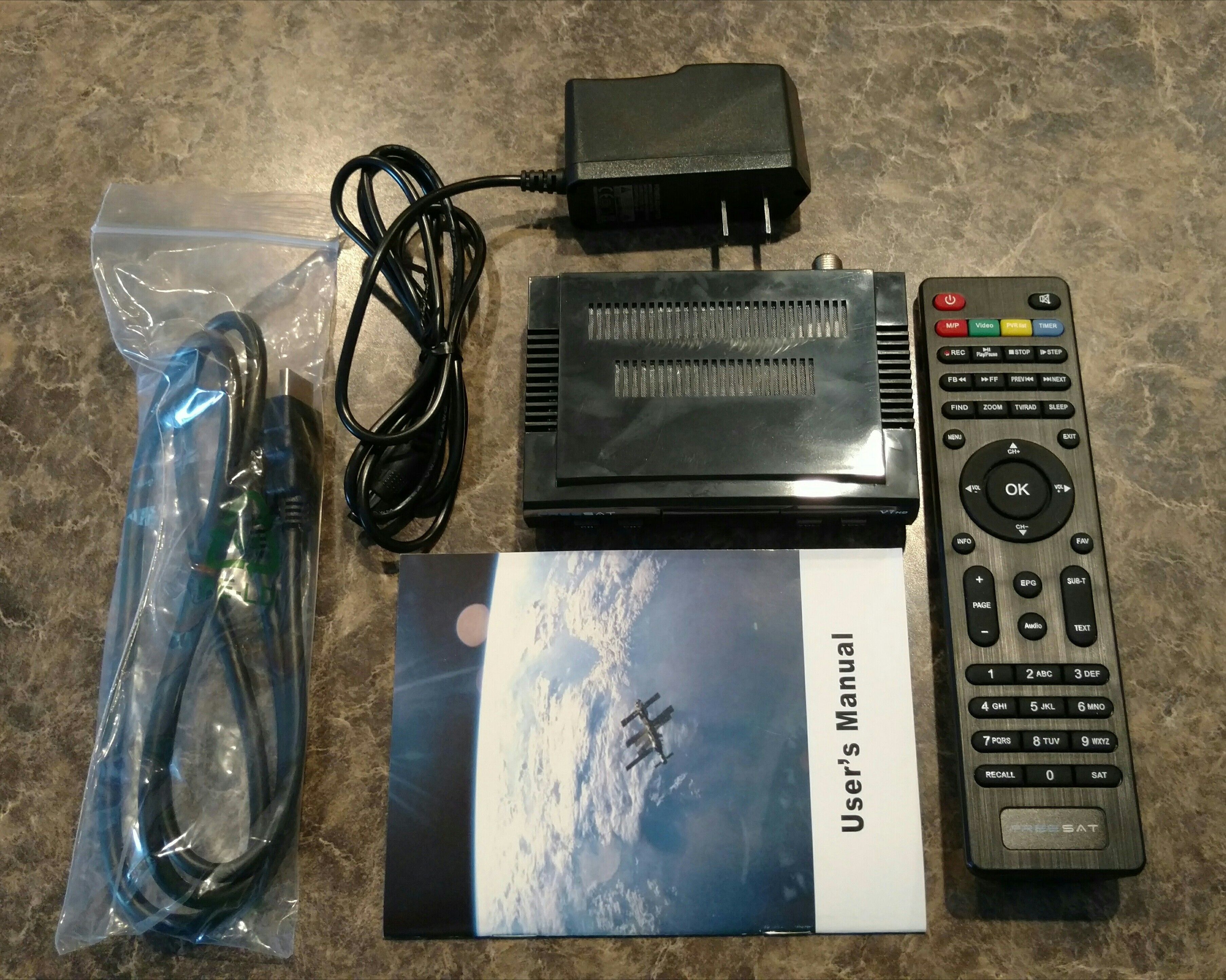

This thing is Tiny, it seems like it will have a hard time dealing with heat dissipation issues.

The size and weight is amazing! The entire chipset is covered by a heat sink that seems well attached. The case is well vented both on top and bottom. Ran heavy HD programming for 30 minutes and the heat sink was warm to the touch, but not hot as we have seen on other STBs. The PCB hardware build is very good.

This thing is TINY, as can be seen in this photo... I can echo what Brian said, for less than a pizza and a few beers, this thing performs well. It gets the troublesome Heroes/Movies!/Decades transponders with no problems. The signal is booming on them off the 8' channelmaster.
