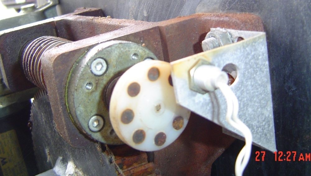

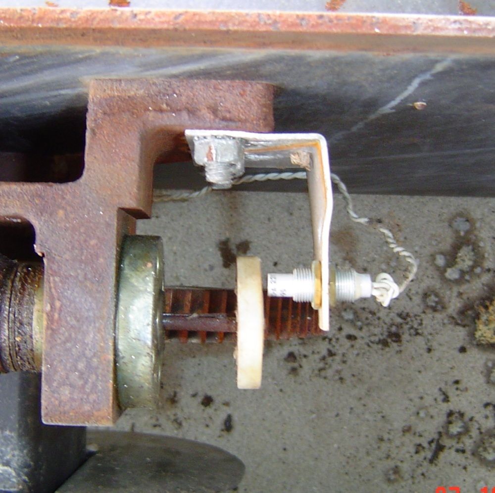

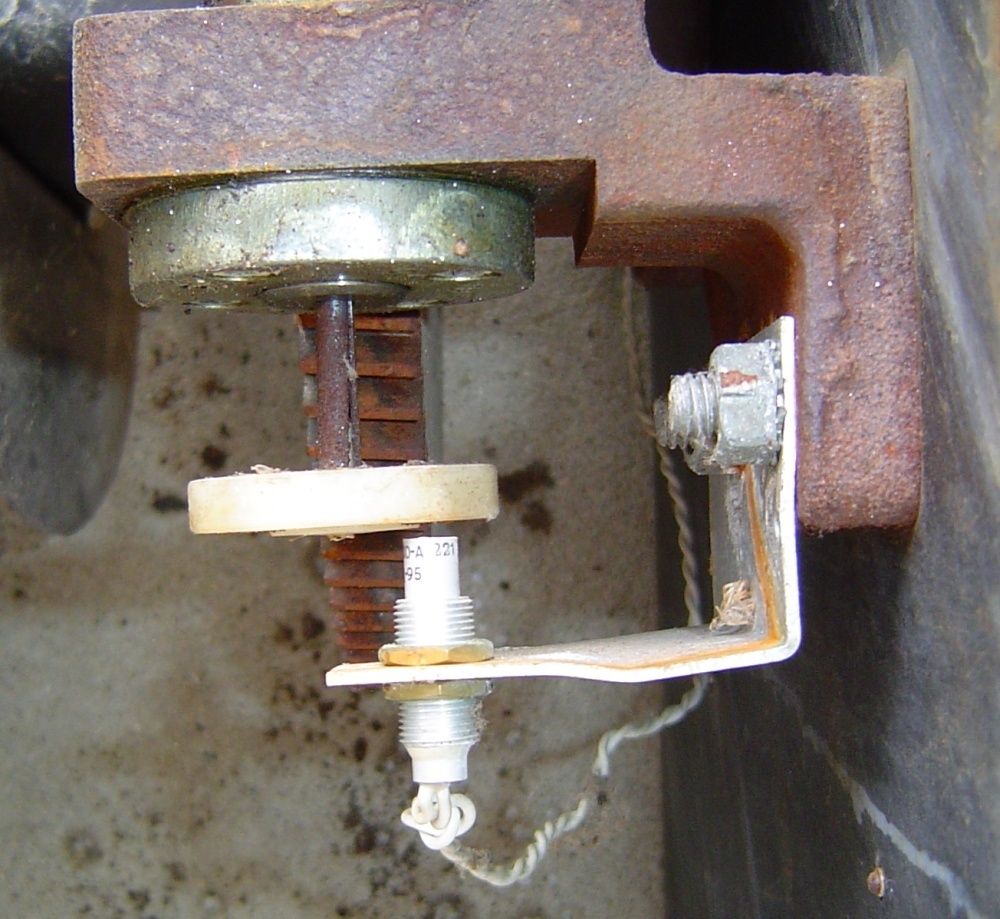

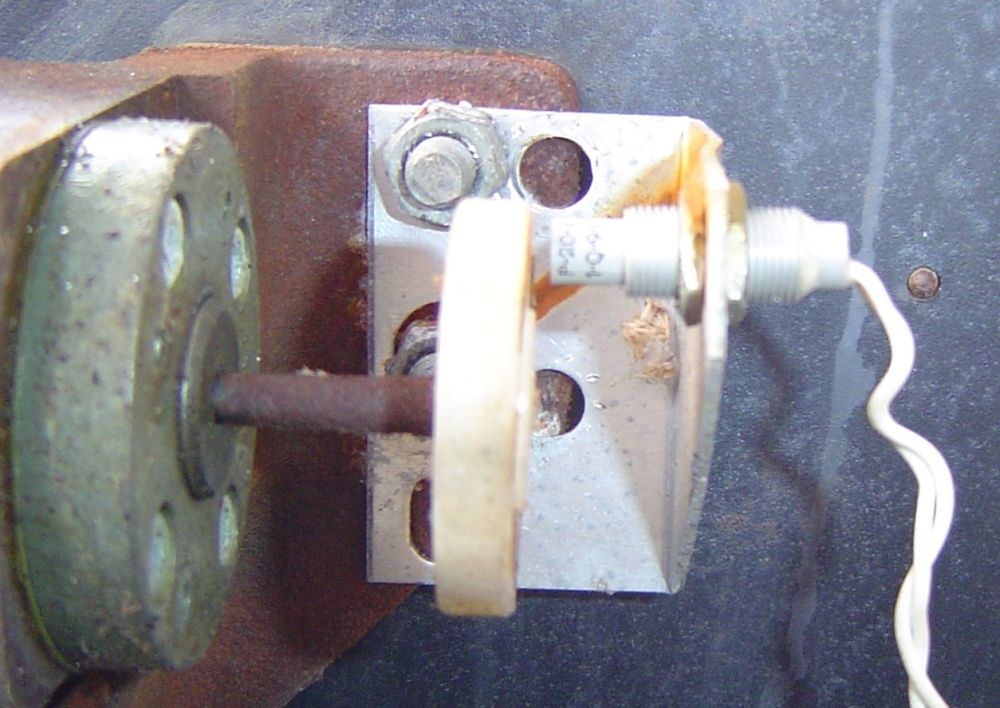

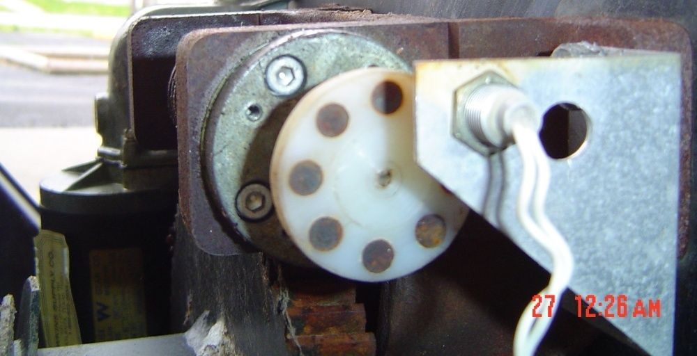

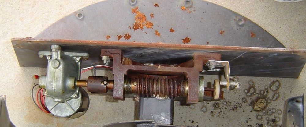

I wanted to update this thread with pictures of the old-style reed-sensor conversion kit that was put on my 3rd Birdview dish by a professional installer.
As you can see, it is much different than the Skyvision version, and it only has 8 magnets in the wheel. I don't know if it will give me enough pulses or not. Even with a GBox V3000, it would only be 16 actual counts per revolution.
But I also wanted Bryan to see this to get an idea of how to mount on the other end of the shaft.
Here are the pics.

if you added another sensor or two (and i thought you found sensors somewhere cheap) to this magnet wheel would it get you what you want. i've yet to add another sensor to my superjack actuator but thought ithis falls into the same area. guess they would have to be offset in timing to where no sensor counted at the same time.
Fred
Hey George.
No, I didn't find anywhere that I could buy exactly what is shown in the picture. I scarfed one off another actuator here, but that might be a good idea to maybe mount another one on the back side off-set to this one to get it to use 16 magnets for 16 pulese.
Then maybe the GBox would count that as 32. :)
