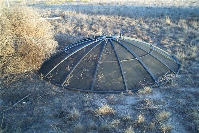

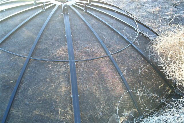

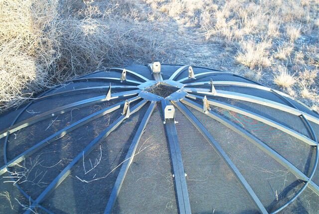

10' good condition dish .
Removed the rest of the hardware yesterday afternoon / nite .
Seperated it into 4 sections & got it home tonite .
Wyr

great find!
Wyr[/QUOTELooks like a good quality find at that!!!
Congrats!
jeff

Thank you . :-)
Hope to get it up and going by some time this weekend .
wyr
