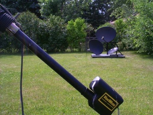

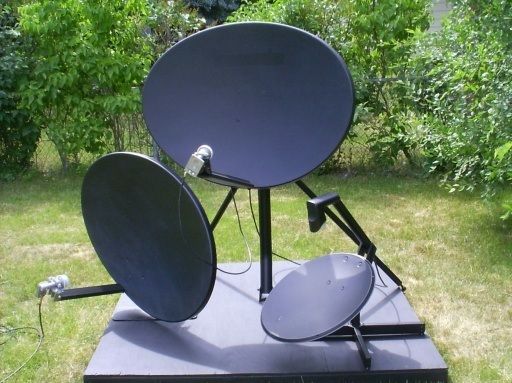

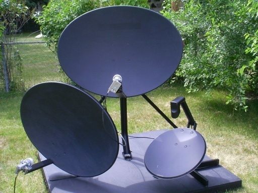

I have been digging holes for poles for years! Have a one in my back yard. But the latest thing I have been using is a small platform to mount all my experimental dish at ground level.
The nice thing is its not permanent and can be positioned anywhere in the yard depending on the time of year and tree growth!
As long as you have good line of sight to the satellite/s you are after ground level is the BEST place for a satellite dish!
See picture below!
