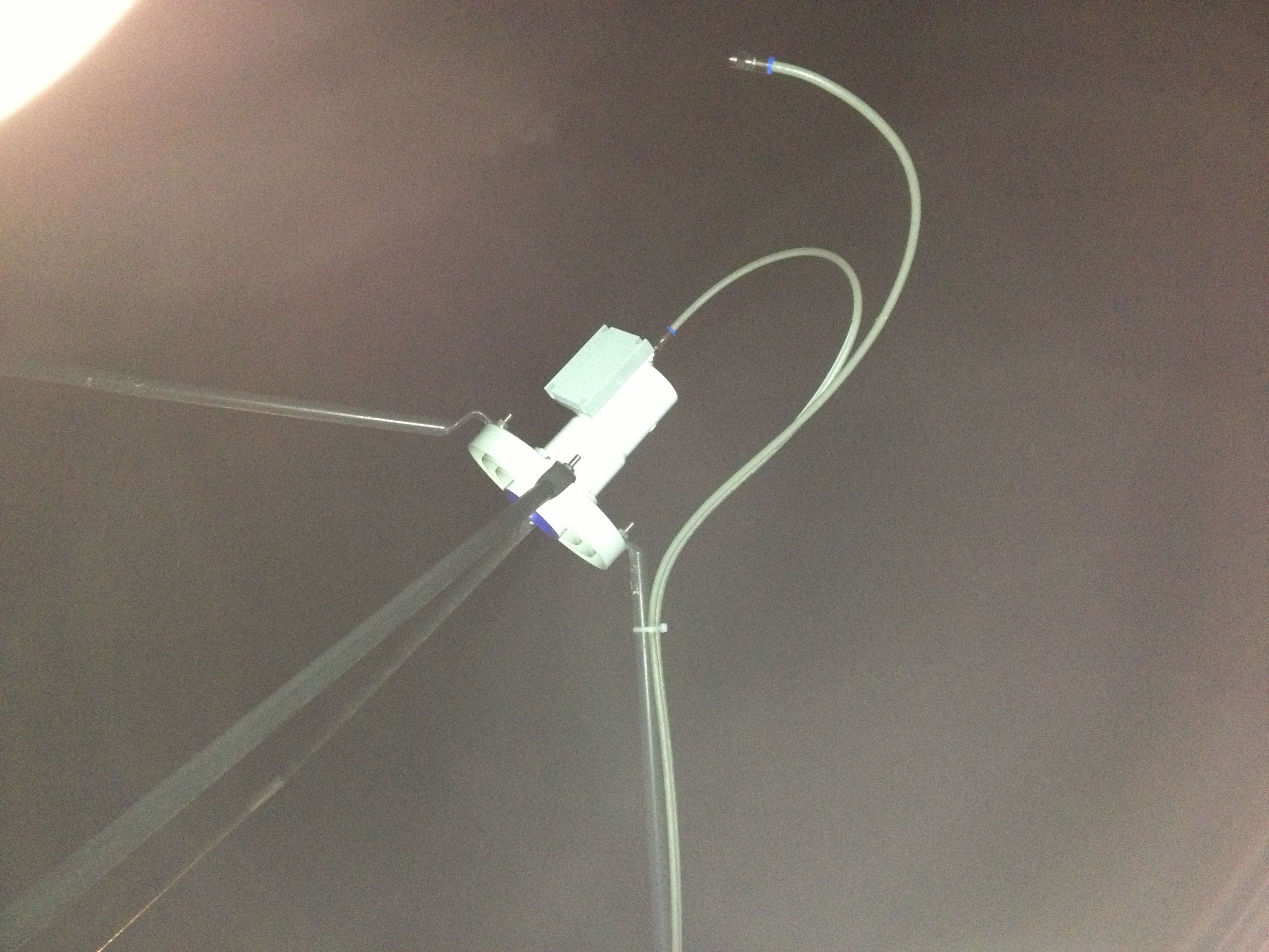

10 foot sami
All but 4065
Using a different scalar ring "chaparral"
