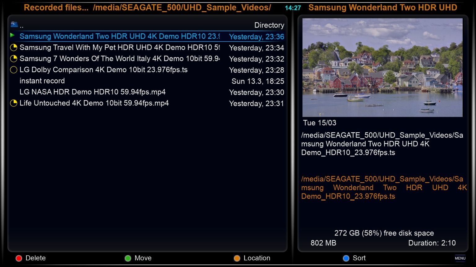

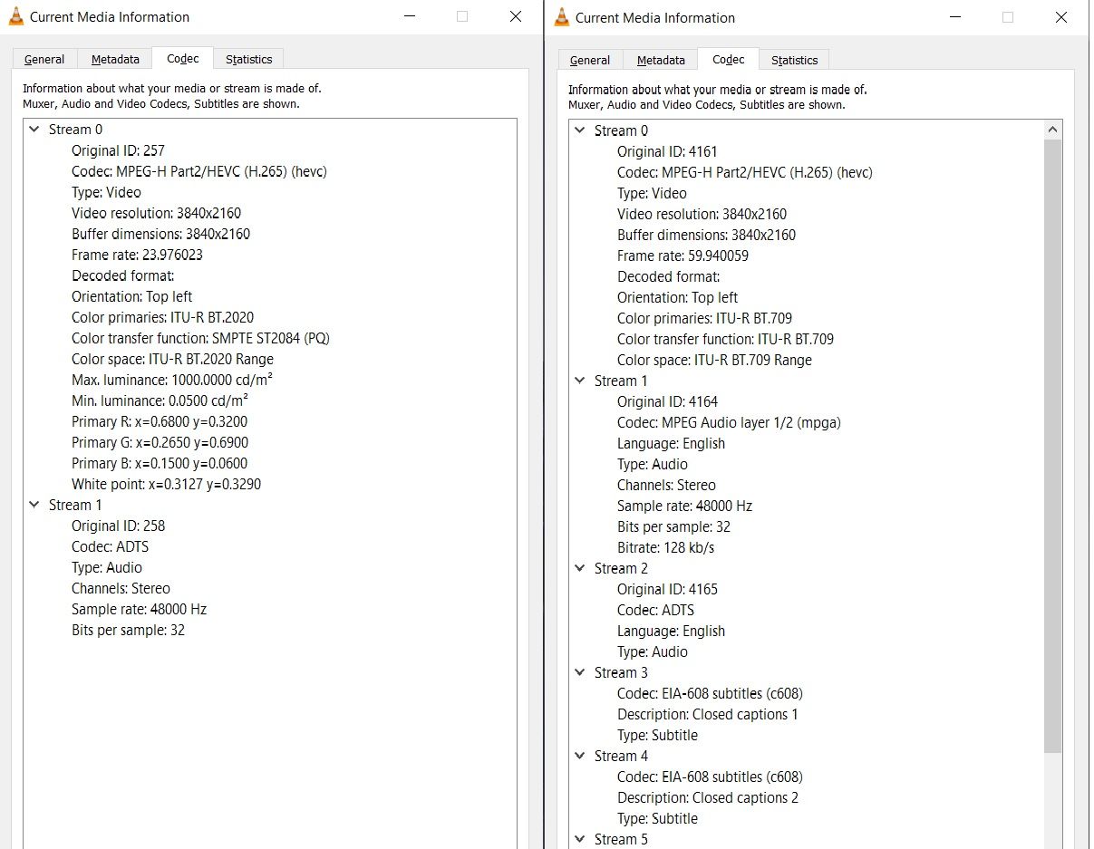

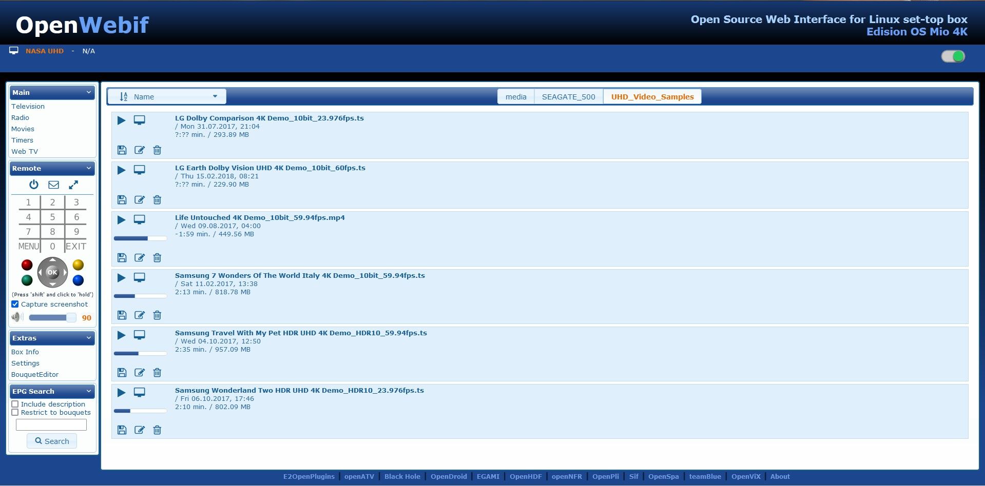

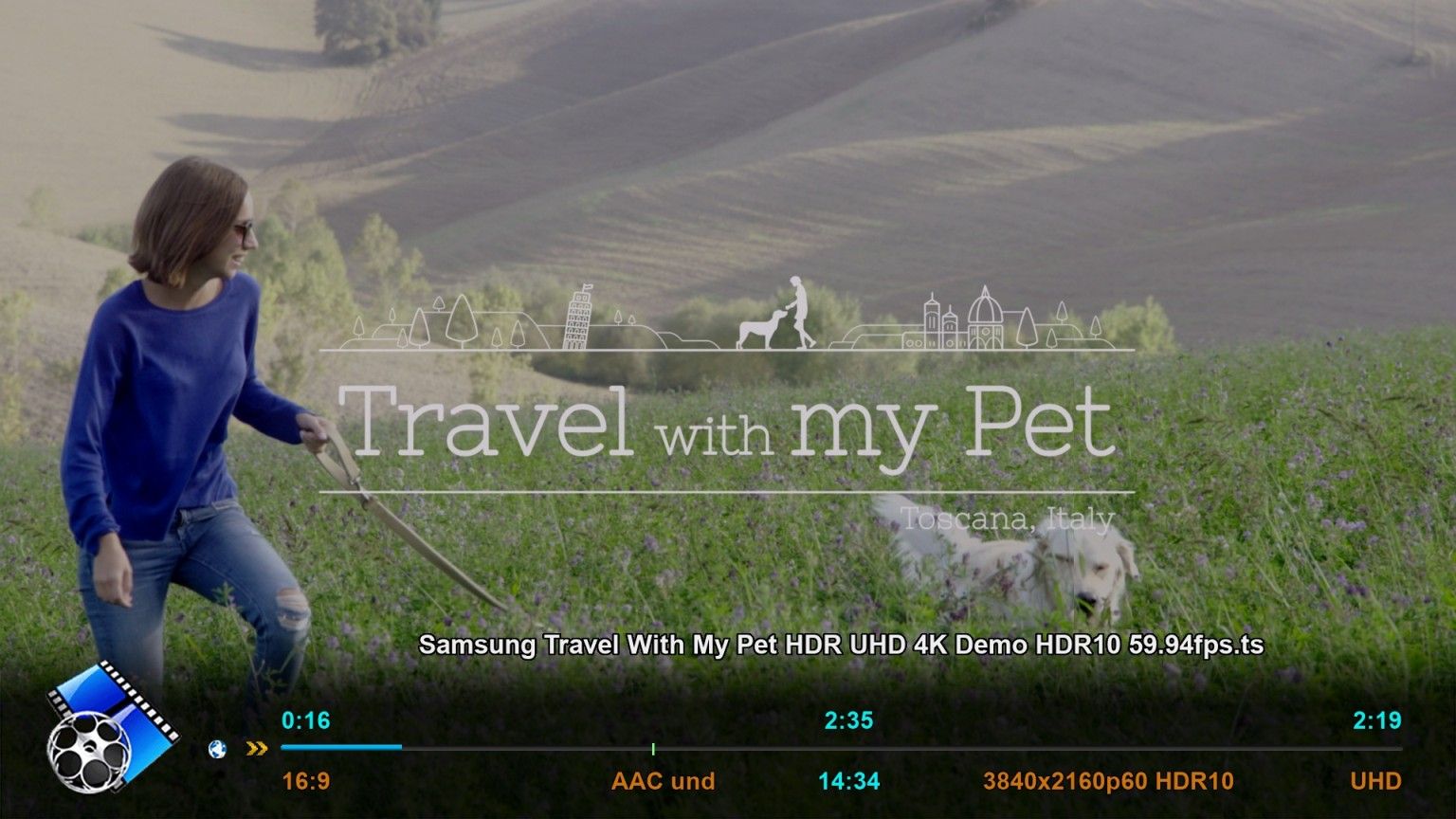

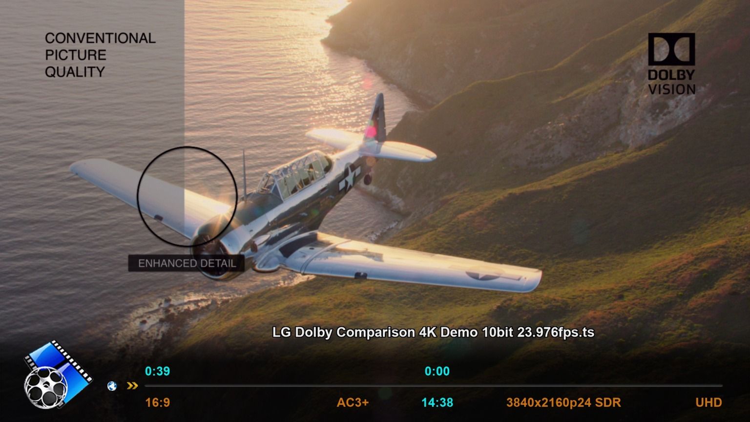

I have several different 4K video samples saved on the Seagate HD attached to the Mio. The only two that don't play are a NASA instant recording made on the Mio and the LG HDR NASA Demo. Both those do play fine on the PC. The rest of the samples I downloaded do play without problems. These screenshots are through OpenWebif.Mio4K_4K_samples_screenshot.jpgMio4K_LG_4K_Demo4.jpgMio4K_Samsung_4K_Demo.jpgMio4K_Samsung_4K_Demo2.jpg
There's a bit more 'gook' in the NASA (right) stream than the Samsung (left).
