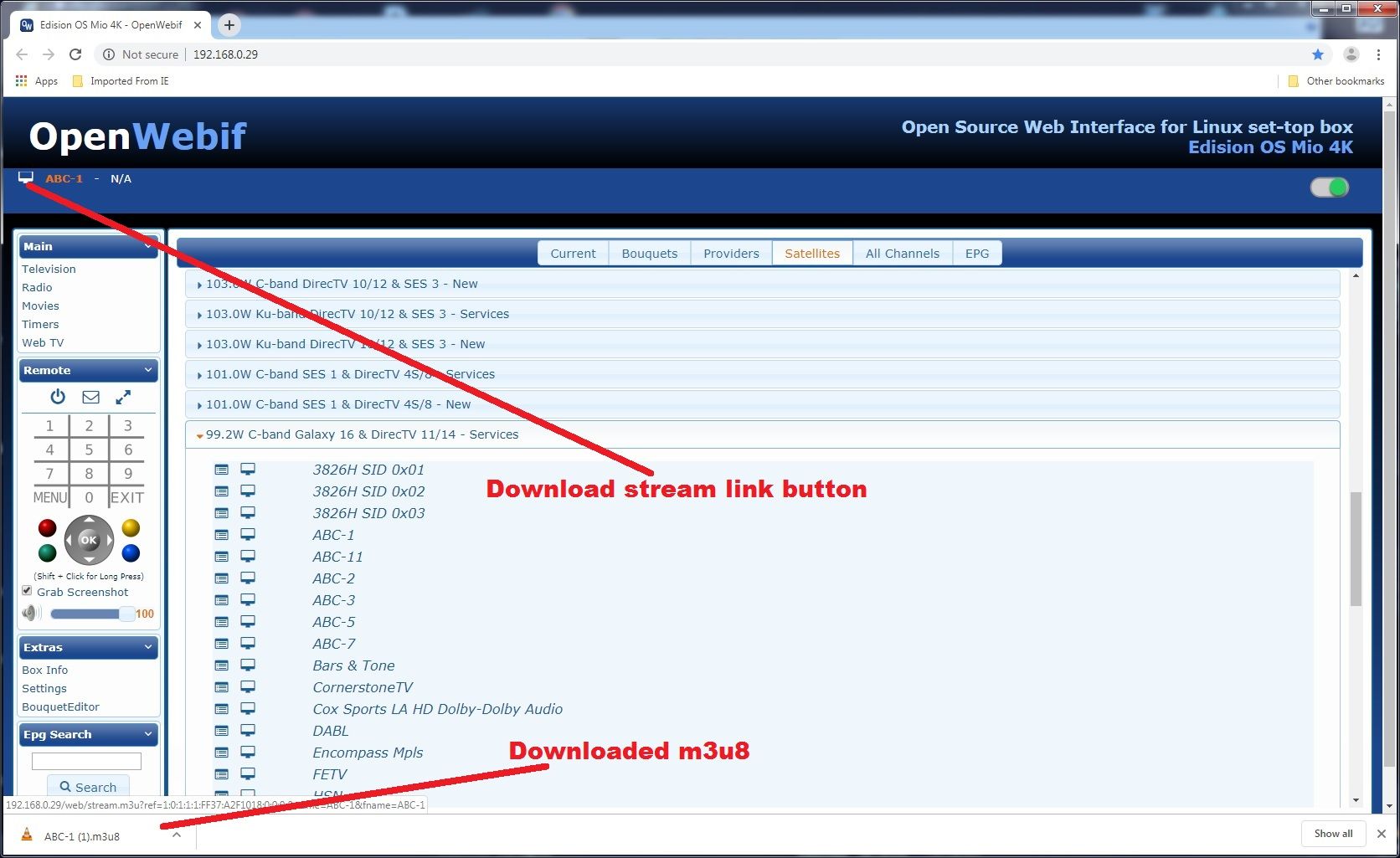

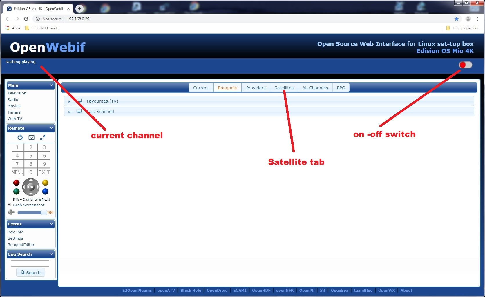

Since I managed to start Open WebIF in the Edision I decided to see about streaming the elusive 4:2:2 ABC/CBS channels. I managed to stumble right into it. :) Here's what I did. Started "Open WebIF" by entering the IP address of the Edision in my browser (chrome).
Now since the Edision was turned off at the time, I turned it on with the on-off switch.
The current channel was displayed in the upper left.
I clicked on the Satellite tab, selected the drop down list of channels for the 99W sat and selected the ABC channel I wanted to view.
I hit the Stream link button on the upper left and downloaded the m3u8 stream file. (lower left)

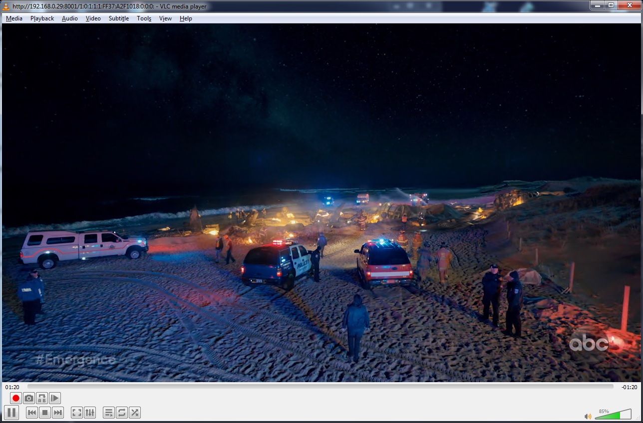

I closed my browser with Open WebIF, went to the download folder and opened the m3u8 file with VLC
Or click the TV icon beside the service name to live steam and keep WebIF open to change channels. :)

IIRC take that file path name and copy it and then in VLC go into the media drop down to 'Open Network Stream' and paste that path into the box and it should start to play back.
