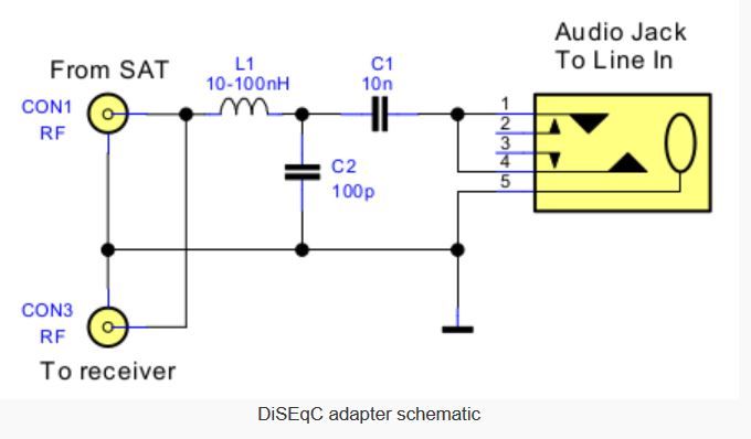

I found this page on internet that shows how to check if receiver is sending DiSEqC commands but I don't have the equipment, has anyone done this?
The article is above me here is a drawing.
Thank you
Do you have a cheapo satellite meter with the 22KHz LED indicator? If so, the LED will light steady with a 22KHz ON signal and flicker with a DiSEqC command issues. Best way to measure is with a scope. Look for approx. 600mV.
