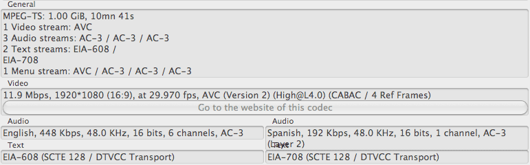

Just for giggles I took a look at one of the TS files from HD02 when they were playing "War: What Is It Good For", or something like that.
The gory details are at this link: http://www.certsoft.com/FTA/hd02.txt
Just the essentials:
