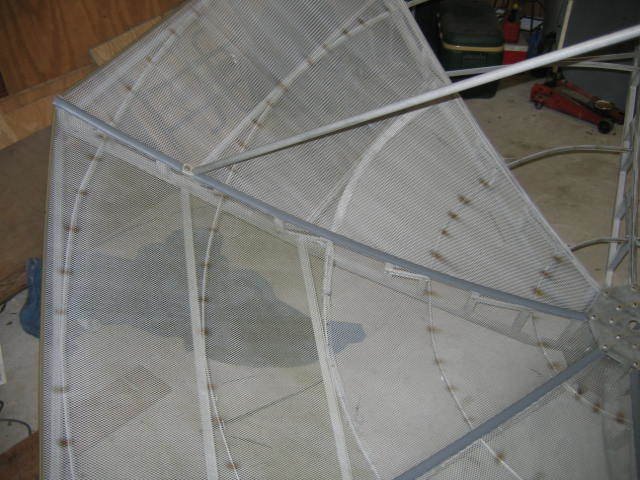

Thats a good idea Green One....no chrome though....I don't want any bling on my dish....:D
My thought was using some of the rubber moulding/finish strips they use when building fiberglass boats to finish the rough edges on the consoles, etc. Comes on a roll, don't know how much it is a foot, the automotive stuff might be cheaper.
Guess I need to do some googling.:cool:
Well so much for that...that stuff's EXPENSIVE...chrome door moulding it is....

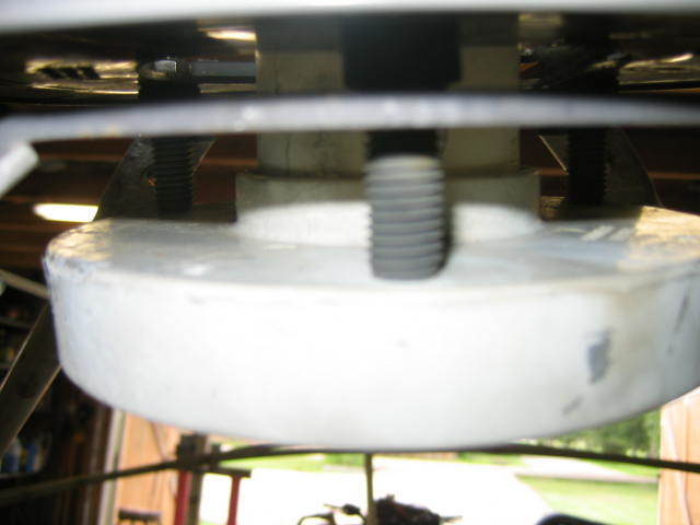

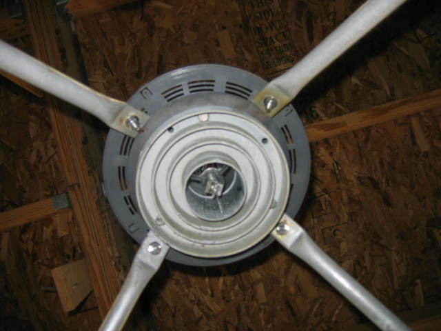

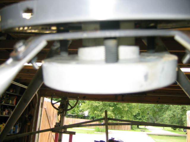

Okay fellers...Mauiguy suggested that I go ahead and install the feed before I went much further...so how in the heck do I center it again? There isn't much play at ALL in Paraclipse's mounting system...they have a steel ring that the feed mounts to, then the feed/scalar ring mounts to that, and they have nylon adjusting bolts to adjust it in and out. how do I check for centering though? Where do I measure from?
OKay, You already checked the dish for trueness using the string method. So, now you measure from the edge of the dish to the edge of the scalar ring. Measure from each of the four points around the dish. I went between the support legs so I did not have to guesstimate. (Actually I measured from the very end of the ribs, due to the flexibility of the mesh...)
As you know, you want it to be equal all the way around.
Then you can adjust for your focal distance if you wish. If all works perfectly those plastic adjusters can be moved with your fingers. However on my current dish they are way to tight and I need pliers to turn them.
OH......... this is edited because you mentioned the very little play in the feed mounting system. The problem I found was that when tightening the feed poles they would some times "twist" a little. This slight twisting then torqued the feed plate a little etc etc. When I assembled it I had all of the pieces loosely bolted together and then tightened them. So a slight twist on one pole had an effect on othr poles. (hope you follow this convoluted explaination)
I have another quad pole feed system for another dish that the plastic screw move easily. Over tightening of the scalar ring will make them harder to turn of course.

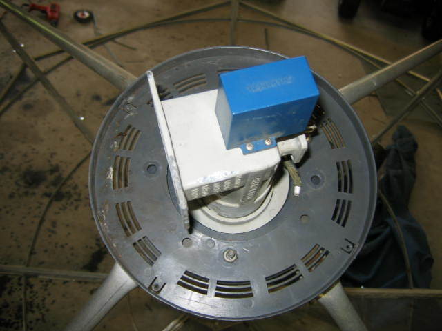

Okay. I am gonna change out the feed when I get the dish up, I want to use the voltage controlled LNB I have on my 7.5 dish, but I wanted to get it close before continuing with the meshing process.
What did you tell me your focal distance was? Mine is 53.250 right now.:D

My focal distance is 52.625 This is measured from the center of the dish to approximately ¼ inch inside of the feed throat. The 53.375 focal distance is what is posted in the paraclypse chain drive book. I have a note here that earlier models had the 52.625 focal distance. I tired both when I assembled my dish because I had fabricated four feed poles that I made adjustable. I found that for my fourteen foot dish the 52.625 was the best reception.
There are so many variables that it is difficult to say categorically what is correct for your dish. I would try it as it was when you picked it up, then if it is not good enough you can play with it to get the best reception.
When measuring for feedhorn centering I ,measured from the end of the rib to the edge of the scalar ring. It makes little difference what the distance is, but it certainly makes a difference if they are not equal distance from the end of each rib. I used four ribs to measure from Those were the ones that did not have a feed support leg attached to them. That way you have an unobstructed distance from the scalar ring to the end of the rib.
I gather that you have already tightened the poles. No problem there, but measuring them will tell you if they twisted slightly when tightening….(think of how a bolt might slightly turn as you tightened the nut on it)
Also while measuring from the edge of the dish, I would check to see that the surface of the scalar ring is in a plane parallel to the center plate of the dish. If whose adjusting screws are not adjusted properly then the scalar ring will be slightly canted. Two things will result. One, the measurement from the end of the rib will be affected, and two, any feed horn mounted on those screws will not be pointed at the center of the dish.

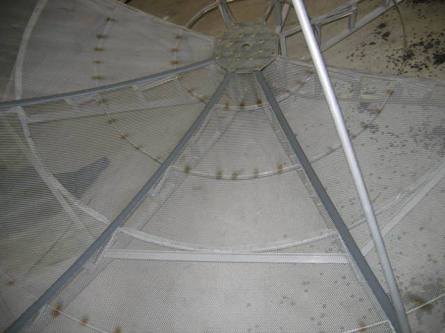

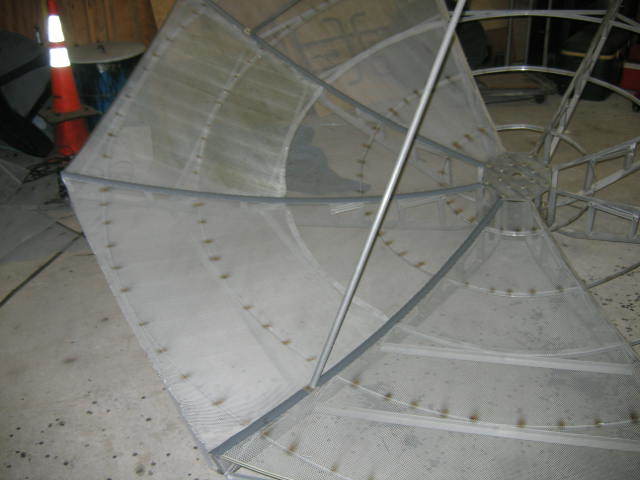

Almost half of the mesh is done. Pics in a little while. The trim pieces are looking GOOD. :up
EDIT: One half done.

Looks good.
Changing the buttonhook to quad feed should have affected neither the F/D ratio nor the focal distance as both are related to the diameter of the dish and the depth of the dish. Essentially what the quad feed did do was to provide a more stable focal point.
With the old button hook feeds, the guy witres would eventually stretch a little and the feed would then sag off center decreasing the signal.. With the new Quad feed, you lose the potential for the sag, and gain the ability to fine tune the focal distance with those plastic screws.
Once you are all set up , you will probably only need to go hit it with grease a couple of times per yuear....
That gray plastic trim along the ribs is lookin' spiffy, dude!
Ya got 'er lookin' new! - :up
I can't believe they had no factory trim on the sharp edge of the mesh.
Wouldn't a bird flying into it get his head cut off? :eek:

While cutting grass today I got caught in a thunderstorm, so I had time to make my missing mesh panels. I had to make each one in two pieces, but it is what it is.
Now, what color to paint them, silver, aluminum, or gray? :confused:;):D
