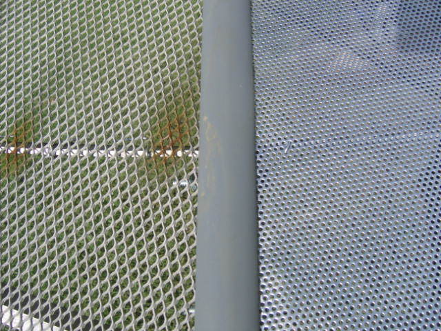

No, Anole, all I could find here was less than 1/4 inch deep. Not good at all. Anyway, I think I found something better.
I went to the blue box last night (Lowe's) and found something I am more than confident will work. Electricial cord protectors.
I could't find it on the Lowe's website, but I did find it on Amazon:
Amazon.com: Wiremold White Cordmate Cord Channel, White #C10: Home Improvement
I got a five foot piece for 4.48. :)
And its paintable. :) Has adhesive on one side, but hey, beggars cannot be choosy.

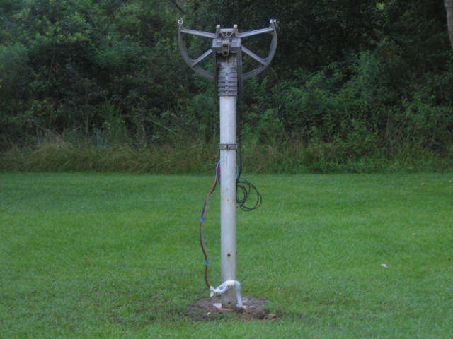

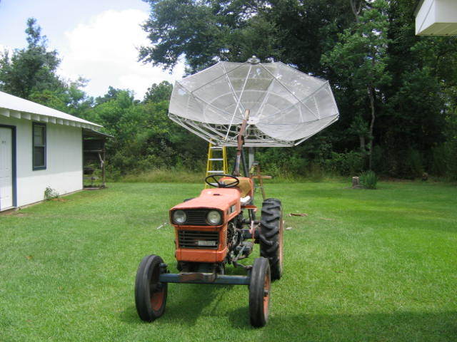

Mount is ready, dish is strapped up and ready, tractor is ready. Keith is ready. Keith is having trouble finding help on a weekday. WILL it STILL happen today? Stay tuned to find out. :cool:
Keith,
Looking good! Are you going to put some PCP pipe over the wiring and connect it to the pole? Just wondering if the critters might chew into the wiring. Hope you find some help, I know that there would be a lot of us from here to give a hand if we lived somewhat closer! Like it's too bad when I was going through your area and I was a rocks throw from your place, I would stop off there. You be installing that day and we get her done! Ah Life in a perfect World!:) However you're doing a great job there. Can't wait to see the next step! :hungry:
TOM
:D

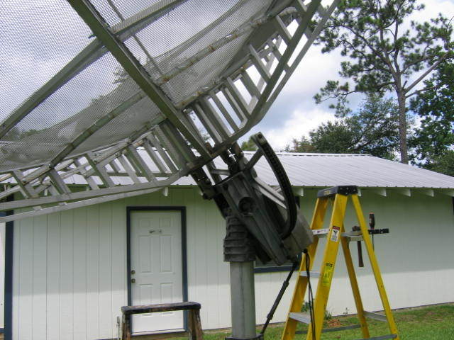

Yeah Tom I always wait until last to do the wiring, that is just temporary until I get it dialed in.
My next door neighbor came and helped me, we never even used the tractor. We loosened the pivot bolt, made the mounting points level, stood the dish vertical, and after a bit of futzing and fuming, and some four letter words, got it lined up and bolted in. Took about two hours.
You are smoking now guy!
Can't wait until you start feeding us some numbers.
Looks great!

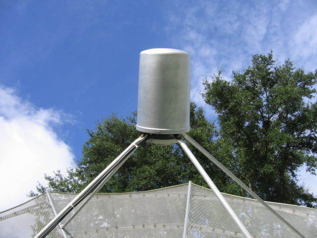

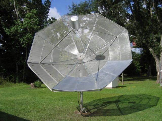

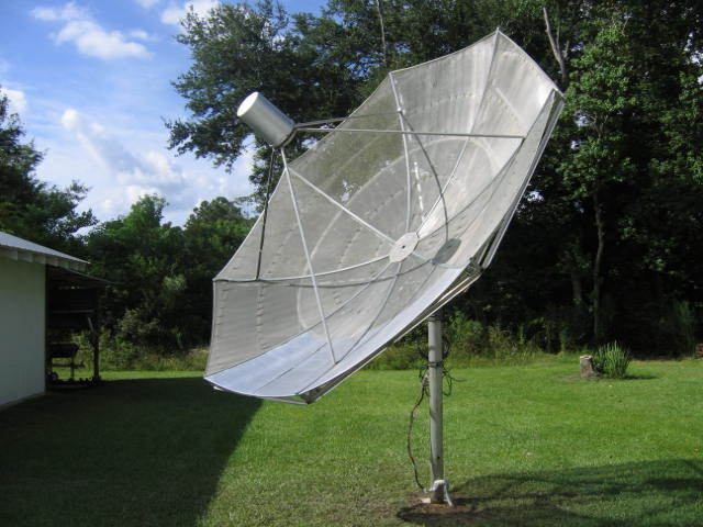

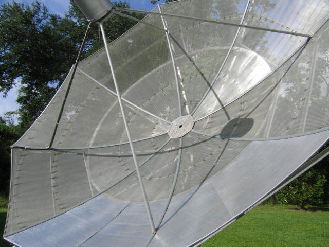

Here it is, fellas. I set the elevation and declination the best I could, but I haven't hooked it up to a receiver yet. I need to find out some more info about aiming...true south and such things...I need to look in the FAQ...

Keith,
What can I say other then magnificent job! I see from the middle picture the difference in the holes in the mesh. Are you going to eventually replace all the old mesh with new? Just curious (maybe a dumb question) if the difference in the size of the holes would change the way for you in getting a good signal?

Keith,

Thanks for the well wishes.
The mesh I replaced was blown out. I just used some old mesh I had laying around, it happened to be Ku-rated mesh from an old Winegard 10 footer. I had to piece the two outer pieces because the mesh wasn't big enough. If I can find another Paraclipse I will get my missing panels and change them out. Mauiguy tells me my original mesh is not Ku Rated, but will work. Doesn't matter to me anyway, because I intend on it being c-band only.
Trust me, you do NOT want to put 500 wire clips on that dish over and over and over...:D
