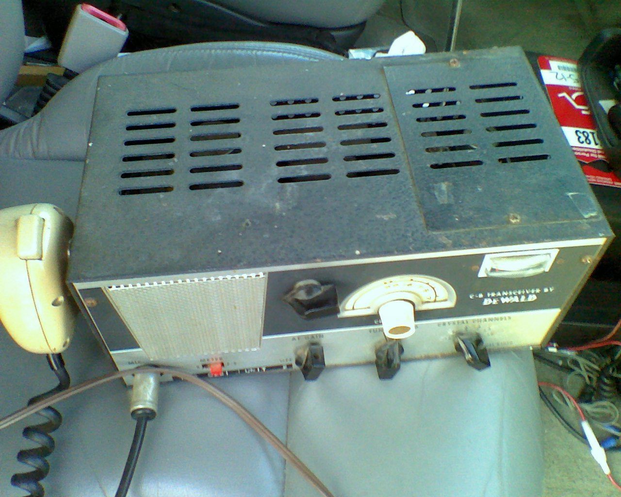

Has anyone heard of the brand De Wald cb radio transceiver can anyone help?

Rad 2.jpgRad.jpgRad 3.jpg Eurosport here are some pics for you.

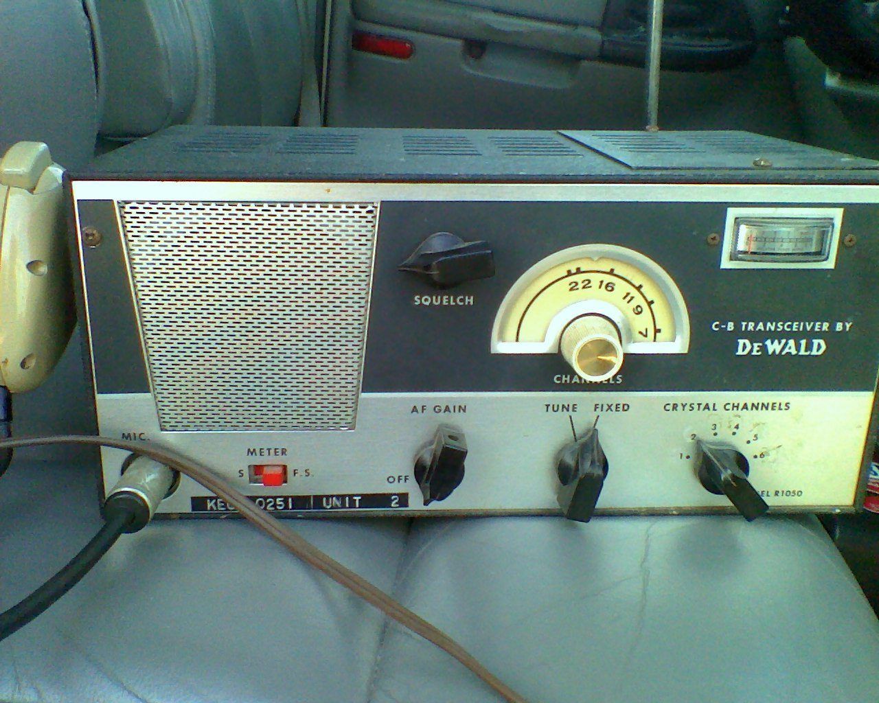

Well, you have 22 channels on the dial, which is the original CB band when it was first introduced out of the 11 meter ham band. This is for receive only. You've got 6 fixed crystal controlled channels. Those 6 channels are the only ones you can transmit on with that radio without replacing the crystals. If it hasn't been used in a couple of decades, I'd be prepared to replace the capacitors if you plan on using it as they could be dried out and you'll let the smoke out of them when you plug it in.
I plugged it up and its still works it comes to life just trying to figure out how to transmit it also has vacuum tubes in it.
Dan Rose
Put it on Fixed and use the 6 crystal channels to transmit. Key the mic and you should be on the air. If not, then there's something wrong with it. Yes, this radio predates transistors by quite some time! If you can get your hands on a tube tester, you can haul out the tubes one by one and see which one/what ones are bad to get it working again, if that's the problem. With some googling you might even be able to track down a schematic, or at least a schematic of a similar model to help you with your troubleshooting.

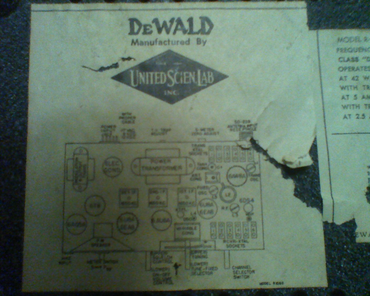

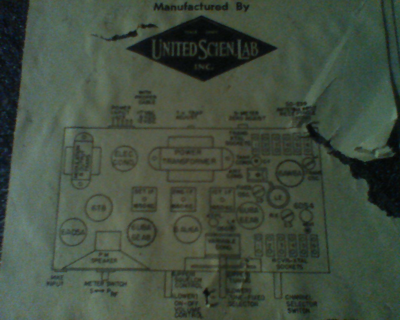

I looked at the bottom of the radio and it still had its warranty card still on it plus wiring diagram. there is also lot of people on the cb in this area but when I tuned into a crystal I can hear people talking. Is also 42 watts per channel pretty good?

Okay looking at your last photo it's exactly what I had suspected. 42 watts is the amount of power the unit draws from the wall socket, not the amount of power that goes out over the air. Power supplies are not 100% efficient and neither are transmitters. That's why you have the disparity between 20 watts PEP and the 42 watts being consumed. The pictures of the schematic are a bit out of focus for me to read it. You've got your six receive crystals in the bottom right and your six transmit crystals in the upper right. These are what determines the channels your radio receives and transmits on when using the fixed channel selector. Did you have any specific questions about this radio? Is it not working correctly?
I would like to talk on it but on the certain crystals i get drowned out by the other guys talking on it a mile a minute. lower cyrstals are you use for the lower bands under 10. 4,5,6 crystals are used around channel 19. Would this be a collecters item also? How would I talk on this radio compared to a cb radio out of a car or truck? Another funny story about this radio if you guys live in apartment where you can't put antenna up you can take a Cb radio antenna use a BBQ grill with a vent at the top. open the vent up run the antenna up through the vent and now you have a ground plane to pick signals I'll post pics on what it looks like.
