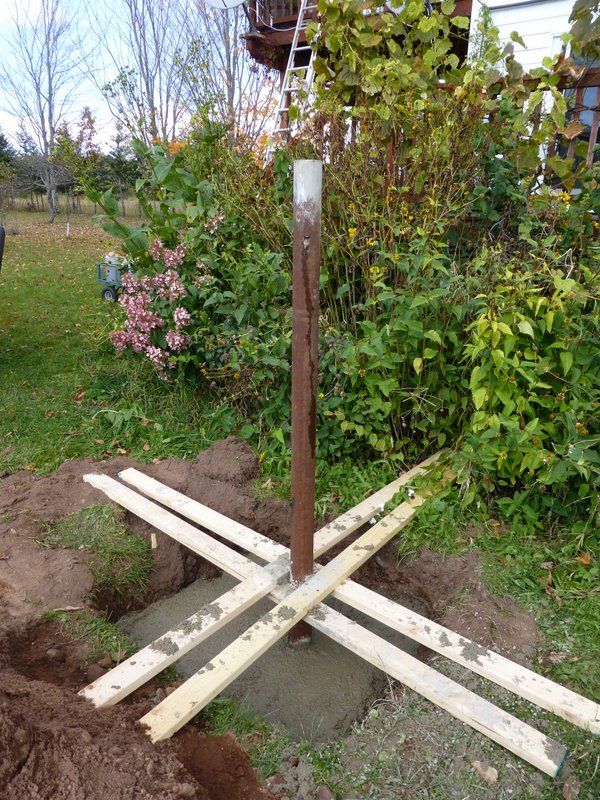

Pole in and concrete'd. Nice and plumb.
o Dug a 1 foot 5 foot deep hole.
o Dug a 3'x3'x1.5' foot pad.
o Filled main hole, and then filled pad 4 inches deep with rebar.
o Two rebar vertical bent 90 degrees to turn into pad.
o Also filled the pipe with concrete.

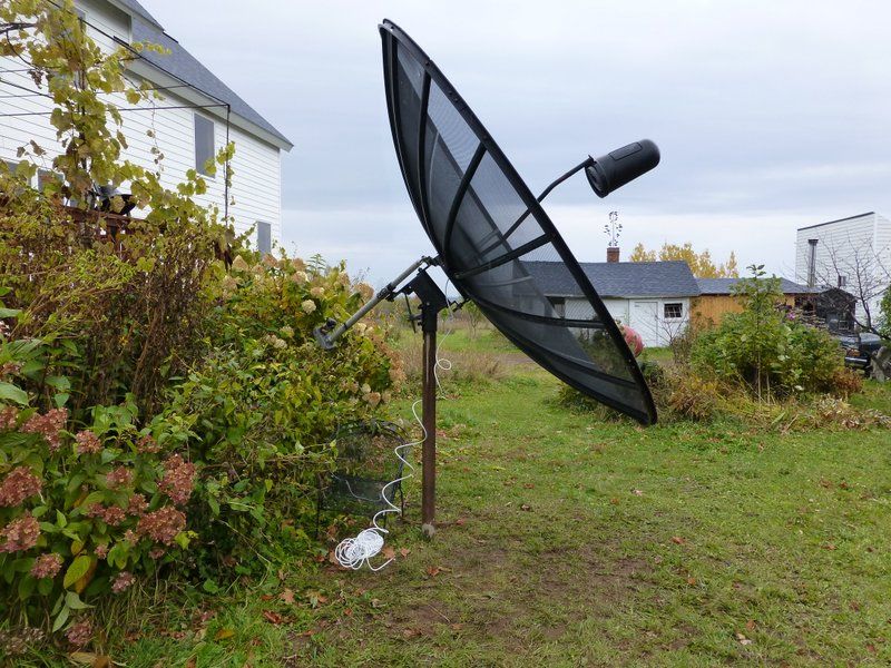

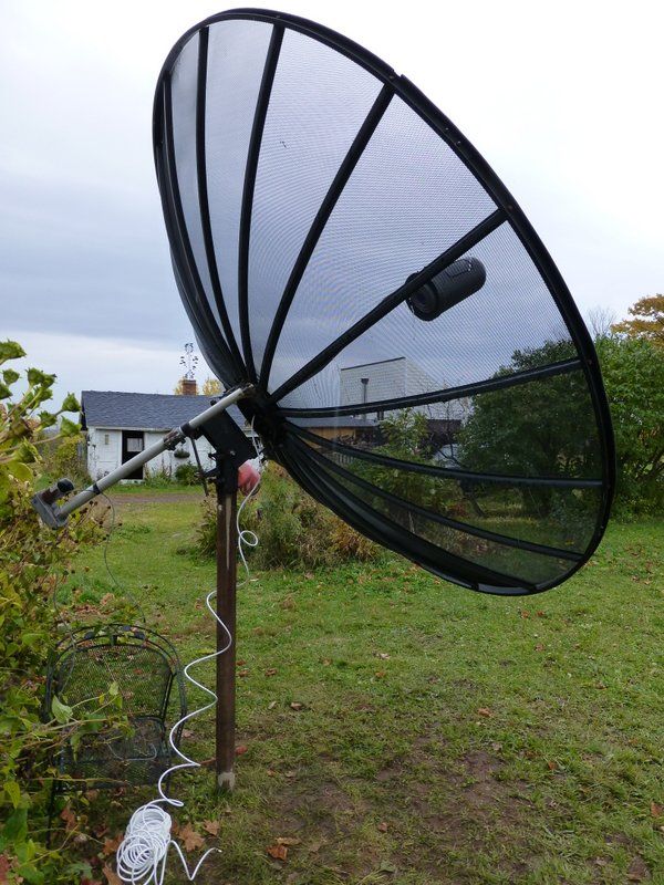

Well, i have pulled in my first signal on the 10 footer. I have locked in Galaxy17 @ 91 degrees. I have found 'The Word', 'Word Net' and 'Classic Arts'. My search on satbeams has me fairly sure I am parked at 91. Ofcourse, top of arc for me is 89 - Galaxy28. So, i am close. I have come in for a break. It's 44 degrees and a bit drizzly.
Question : to get motor at top of arc, do i just eye it and move the motor back and forth until i believe i got the dish at top of arc?

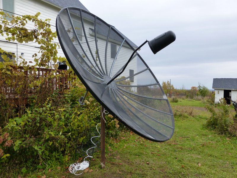

Since you have 91W, you might try peaking the LNBF on the weakest Transponder there, before attempting to fine tune the arc, by moving the whole polar mount? Picture is pretty dark, but looks like the LNBF is set too deep?
o LNBF too deep... Please explain further.... Not sure i follow...
o Wouldn't i want to make sure I'm at top of Arc being if i peak off another satellite, being the twist of the whole satellite on the mount is not quite set, and i want to make sure the polar is centered at top of arc.

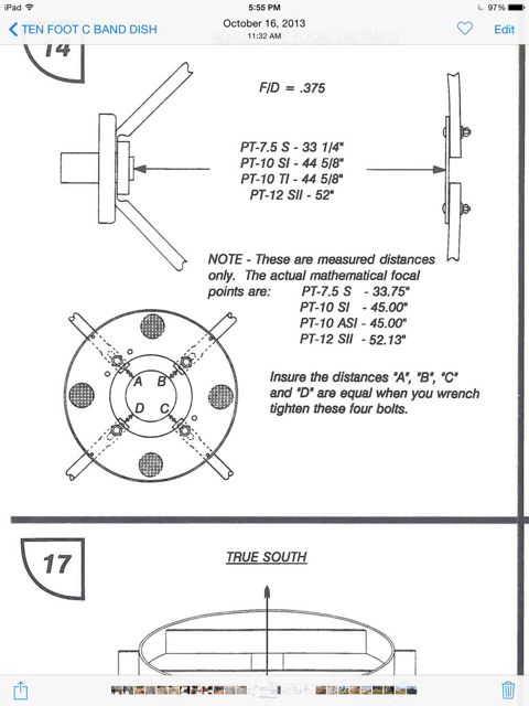

I could be wrong... But the idea is if you set the LNBF wrong and it is not peaked, then trying to peak the polar mount on the arc is an effort in futulity. I cannot tell from the pictures, but did you measure the focal length to a 1/4" inside the LNBF?
If 89W is your due South, then peak on the 3860 transponder, unless someone else has a better solution. I'm using a 10ft mesh and MicroHD as a reference. It comes in fine.
Okay, i calculated a 41 as what the setting of focal depth for the scaler ring on the LNB. Ill check that tomorrow.
