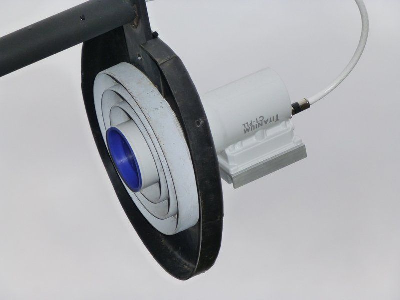

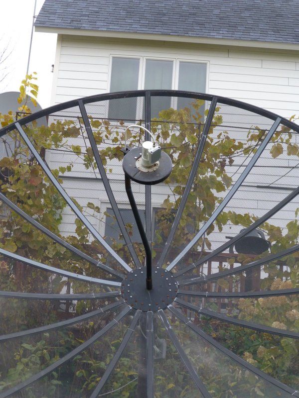

Okay, can use a little help. I am peaking and i am getting like a 80/80 sig/quality. BUT..... the quality jumps ALL over the place. Its jumping from about 50-80 and keeps grabbing and loosing lock?? I'm using Titaniums cband PLL LNB. If i move the dish any which way, the high end of the quality goes down?? Any thoughts?
For example, 99 degrees KCWY13 at 3776 H 3255 I have a level of 90 and the quality is jumping a little between 60 and 71, but it keeps breaking up the audio, and pixelating...

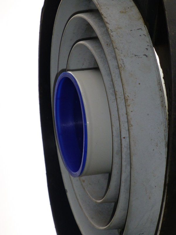

Could be a photo angle, but is the LNBF sitting correctly in the scalar and aimed exactly into the center of the reflector? The photo makes the LNBF appear to not be sitting straight in the scalar and aimed above the center of the reflector.
