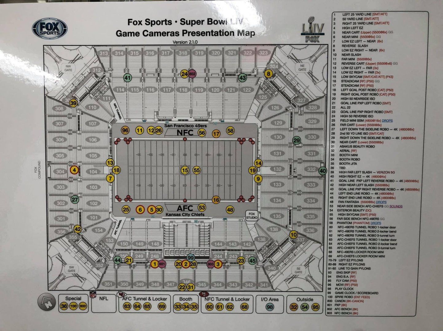

Now when I see the number of cameras they used yesterday I now know why it was up converted and not in real 4K.
If the text in red is the camera model, it looks like a lot of the cameras were 4K capable. For example:
{4800@8x} - HDC-4800(HDC4800) UHFR 4K/HD Camera System
{5500@8x} - HDC-5500(HDC5500) High performance three 2/3-inch 4K CMOS sensor portable system camera with direct 4K output
