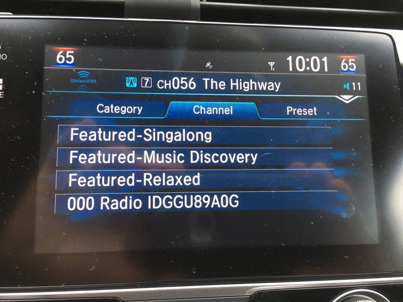

I've been in contact with Sirius for the past 4 days, without any help from them. The problem I had, was, I couldn't see all the channels that I subscribed to. When I brought up " COUNTRY ", I then wanted to see all the stations again, under that category. The screen wouldn't show them. I have a 2017 Honda Civic Coupe, and have the " ALL ACCESS " plan through Sirius. So, I take it to my dealer, they said they could't help me.
When this screen shows, I can't bring up the individual stations.

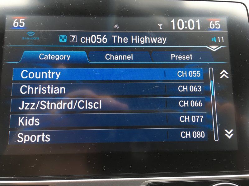

Totally lost as of now, can anyone help me.View attachment 133292

It seems like there is another totally different screen for SiriusXM. I have no idea how it works in a Honda but all the pictures show a screen with controls at the bottom for fast forward, category, channels, etc. I see none of that so there must be a different mode than what you are in.
The other possibility looking at the channels in the second screen shot is you need to have your radio refreshed. You can actually do that by calling with the phone number you have on file and you will be given that option. You must have the radio on where it is getting a signal. It may take five minutes or so after the refresh to see all the channels. (If that was the problem)

I've had it refreshed twice in the last couple of days, the screen shot that is shown, is what appears when I select channels. There seems to be a problem with the unit. I will be taking back to the Honda dealer. When speaking with Sirius, they asked if I had all the channels, which I do. I have to manually, push the channel tab, in order to select a station.
