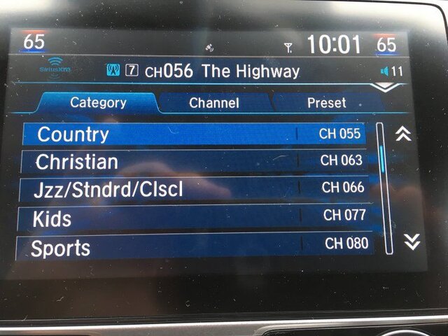

I've been in contact with Sirius for the past 4 days, without any help from them. The problem I had, was, I couldn't see all the channels that I subscribed to. When I brought up " COUNTRY ", I then wanted to see all the stations again, under that category. The screen wouldn't show them. I have a 2017 Honda Civic Coupe, and have the " ALL ACCESS " plan through Sirius. So, I take it to my dealer, they said they could't help me.
When this screen shows, I can't bring up the individual stations.

It seems like there is another totally different screen for SiriusXM. I have no idea how it works in a Honda but all the pictures show a screen with controls at the bottom for fast forward, category, channels, etc. I see none of that so there must be a different mode than what you are in.
The other possibility looking at the channels in the second screen shot is you need to have your radio refreshed. You can actually do that by calling with the phone number you have on file and you will be given that option. You must have the radio on where it is getting a signal. It may take five minutes or so after the refresh to see all the channels. (If that was the problem)
Reactions: TheKrell
I've had it refreshed twice in the last couple of days, the screen shot that is shown, is what appears when I select channels. There seems to be a problem with the unit. I will be taking back to the Honda dealer. When speaking with Sirius, they asked if I had all the channels, which I do. I have to manually, push the channel tab, in order to select a station.

The dealer is replacing the entire unit. They had their electronics wizard in today, he was baffled, so it's going to be replaced. Under warranty.

I had the exact same issue and there is a fix. This is basically tied to the Mix option within the presets and affects Honda Civics and CR-Vs.
This link outlines the fix. I've also included the steps below for easy reference.
XM Presets Problem
1. While in Sirius, go to settings.
2. Preset mix setting: Turn it on if it is off. If it is already on, turn it off and then back on. In either situation, when you turn it on, there should be a message pop up explaning how it works. If not, do a hard boot (data reset) and try again. You must get that pop up message about the Preset Mix feature after turning that feature on. It may be possible you do not need the popup message to appear. Go to step 3 anyway.
3. Once the Preset Mix setting is set to on and you save by tapping OK, go back to Sirius, select a channel NOT on your preset list, and press and hold any one of your presets. The preset button should change to MIX, meaning, you have two channels on the one preset button.
4. Now select any of your other presets and the banner message should not appear. If all is well, go back to Preset Mix setting and turn it off. That is, if you want it off. There isn't a popup message for the off setting. Your MIX preset button will return to the original preset name you had.
