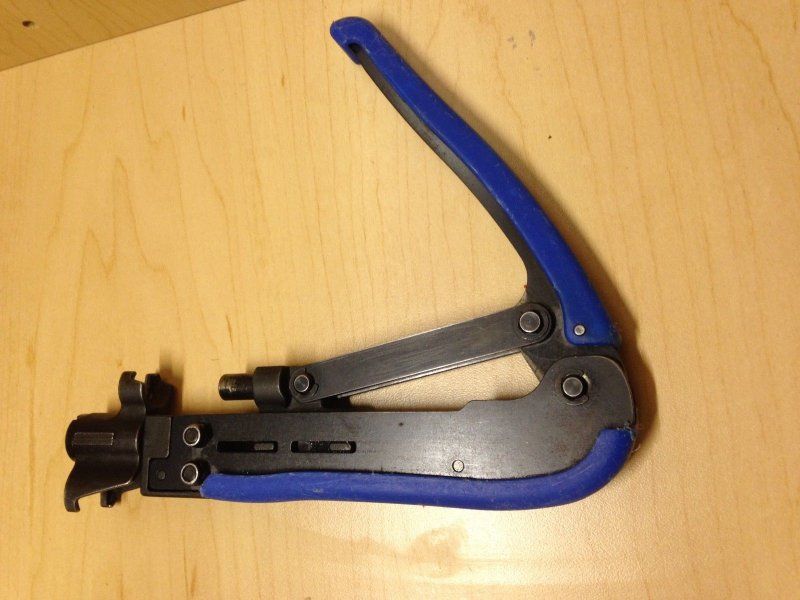

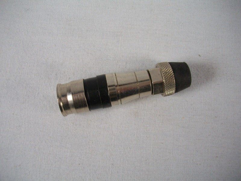

these are the connectors i use for rg7 and the tool i use to compress them and both are made by PPC. i dont really use rg7 much at all anymore only if its already there and laid for me. i use rg11 for runs over 175 ft but thats just me so...

There are some sellers blowing out CommScope branded RG7 on e-bay and if you look closely, PPC sells RG7 connectors as pictured above in IntelPennny4's post.

I do have a couple runs of RG11 running from the house to the dishes only because friend of mine had a roll he wanted to get rid of. Used the PPC connectors in
IntelPennny4's post above (likely the same compression tool), they are awesome connectors, easy to install and compress, and of course... work. Much simpler than the Amphenol crimp connectors we used in the past.
