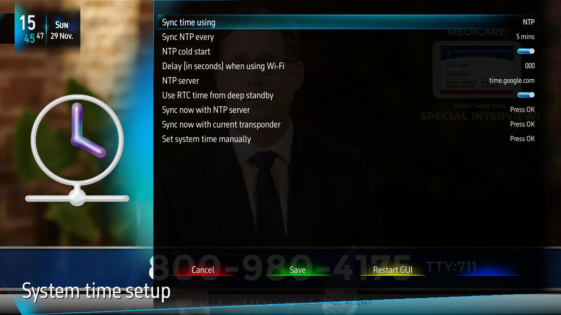

That's really odd, and I don't understand why. Here's my exact settings right now, with my Mio hardwired to my router. As I said, before I changed to time.google.com, I had big issues keeping time. That change of many I tried, was the only thing that fixed it:
Exactly the way mine is setup.
