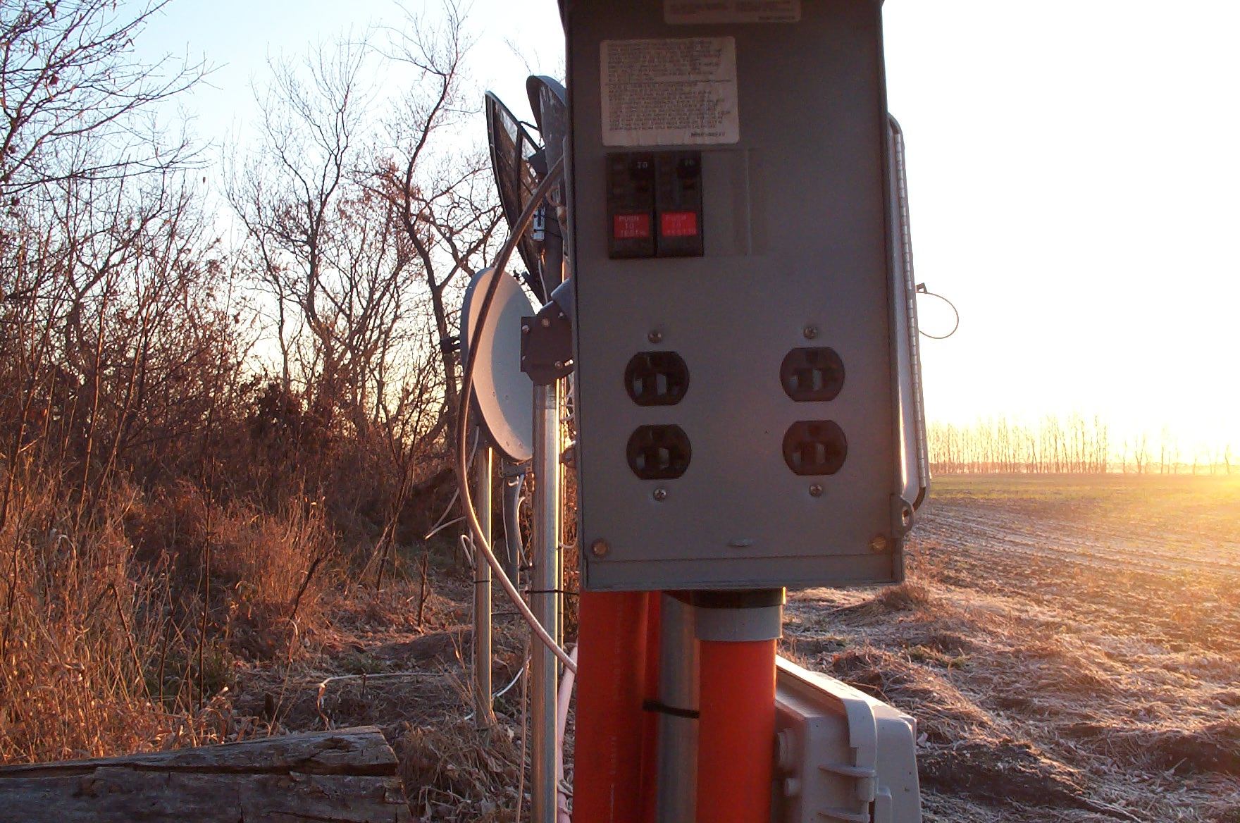

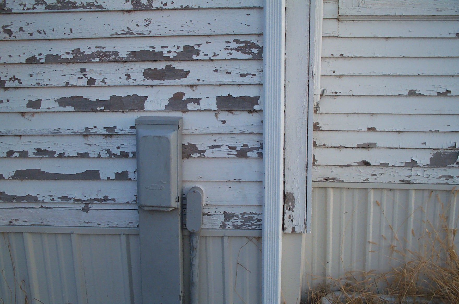

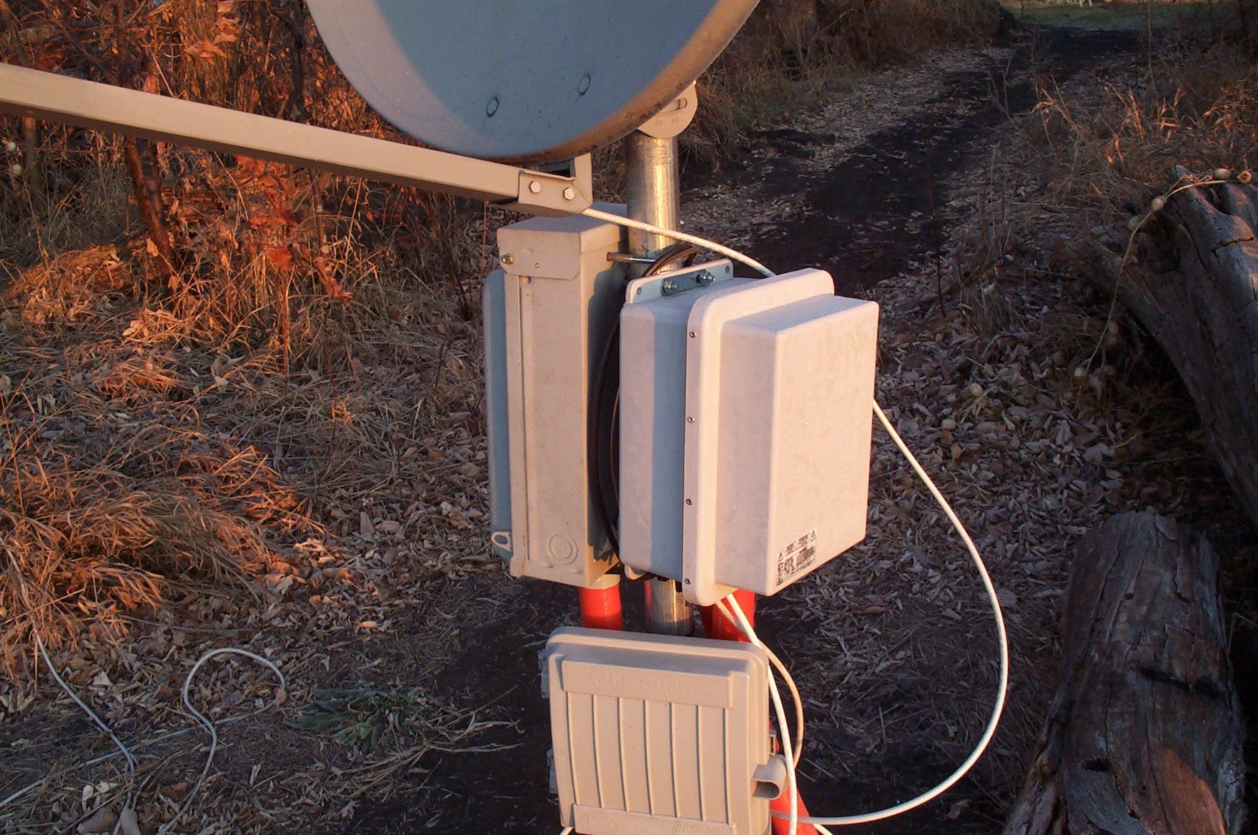

Found the pix, I scored a bunch of leftover fiber optic duct from a wind project, (1-1/4" ID) a couple of years ago and trenched them in last fall. It works with standard electrical PVC fittings.
Nice! I wish a roll of that stuff would fall off a truck near my place. :up
