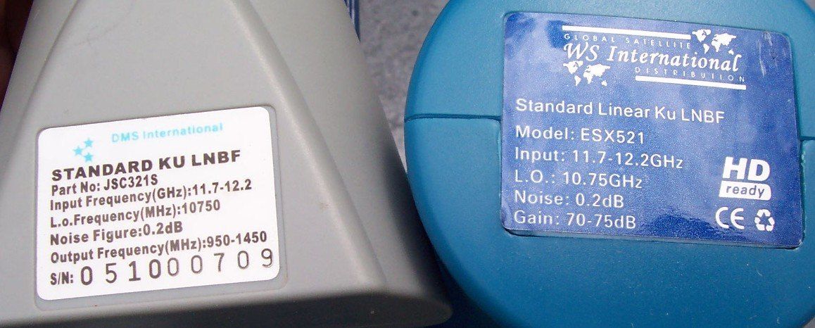

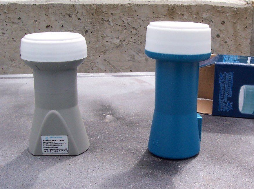

This is a review of the WSI ESX521 Ku Standard LNBF, comparing it to the DMSI JSC321s Standard Ku LNBF. Both are considered hot performers in the Ku LNBF market at this time: June 2011.
Both claim a noise figure of 0.2dB. The ESX521 has a conversion gain rating of 70-75dB, while the JSC321s is rated at 50dB gain by the mfg.

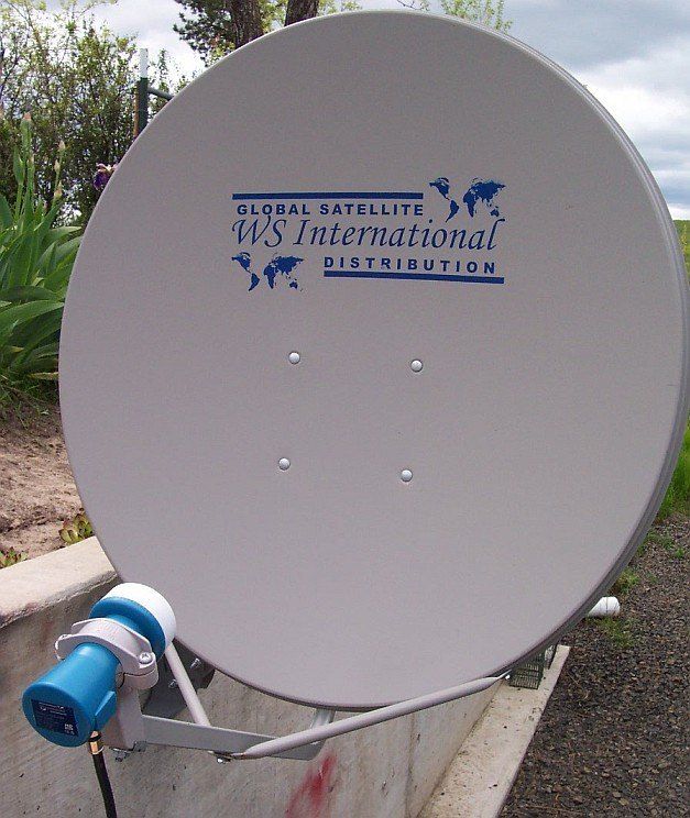

The dish used for this test is a WSI model WS7630, 76cm in size. SES1@101w was chosen for signal comparison and rating, since it has a stable signal at my location, and I have a clear view of it from my backyard test bench. The receiver is a Coolsat 6000 with the latest aftermarket true FTA software loaded. Ten feet of RG-6 coax cable with as-new connectors was used.

Every effort was made to fine-tune dish aim, LNBF position in holder, and skew for each LNBF and transponder tested.

Transponder 12060H. ESX521-69%Q, and JSC321s-72%Q
Transponder 12120V. ESX521-69%Q, and JSC321s-74%Q

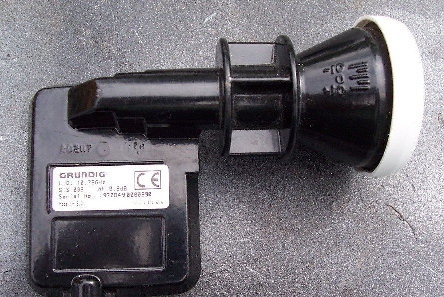

Finally, for comparison and discussion, an older Grundig 0.8dB rated Ku Standard LNBF was also tested today on SES1. The results are as follows: 12060H-74%Q, and 12120V-73%Q.
