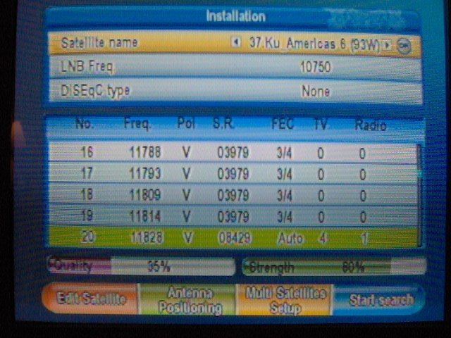

scroll down until you get down at the bottom where the frequencies are listed. There shuld be an option for "start search" (see the picture below)
Make sure to scan "ALL". Yes some stuff will be scrambled but at least we can figure out what satellite you're on (if you're not on the correct one)
