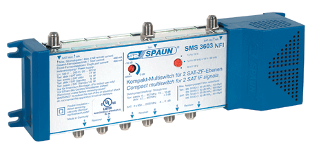

charper1 Bourbon Tester Supporting Founder May 18, 2004 18,442 6 I'm Nationwide Dec 19, 2006 #2 What type of LNB / dish do you have now; a single LNB with 1 out or a single LNB with 2 out, or any other type of multi-LNB dish?? How many TOTAL receivers will you have? Just the 2 DVRs with 2 connections each? You should be able to add a multi-switch depending on what you have now. Attachments SSMS3603NF_zoom.gif 39.3 KB · Views: 200
