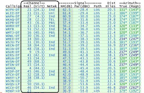

OK maybe this will show it easier...here is a tvfool report for San Juan
the area that has the black box on it...the 1st column is what the channel is broadcasting on digital (the REAL channel its broadcasting)
the 2nd is the "mapped down" channel...the one that you know (what they were on when they were analog)
you can run a tvfool report by going to tvfool.com
Now they dont list PR as a state but if you put in city and zip it will show you what channels you can get
