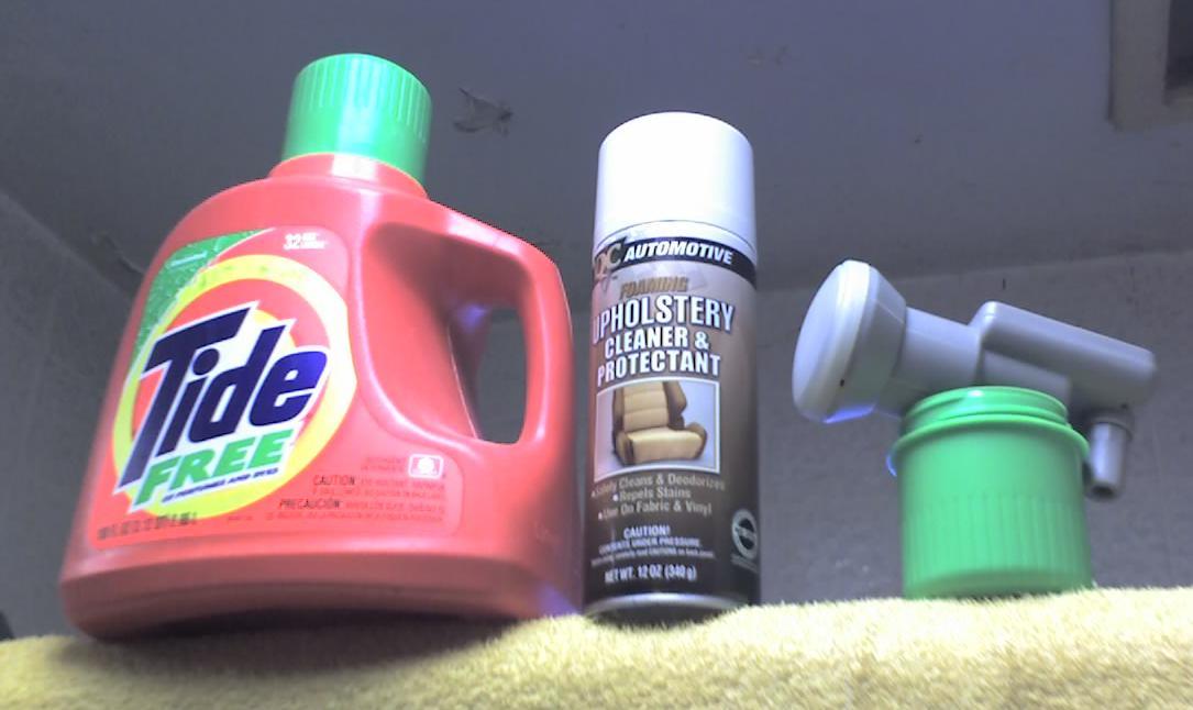

How about a big rubber band holding on a nice thick piece of a plastic coke bottle
I'm about to throw out a large empty Tide jug.
What about a big red dot of that? :)
....no, on second thought, it's the big green Tide bottle cap I prefer.
Wouldn't that make quite the statement?

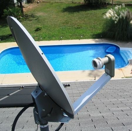

I have a neighbor who has this DirecTV dish. It's still working, and the lnb has been open to the weather for over a year.

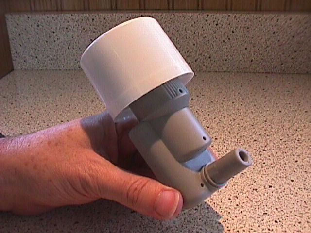

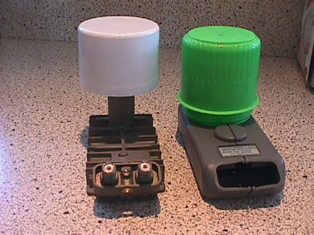

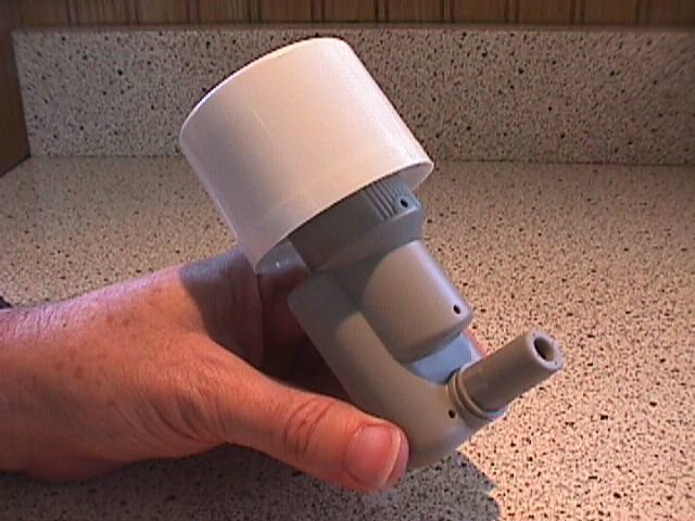

Whatever, here is the red Tide bottle and green cap, along with another likely candidate.
If this doesn't give you ideas... or at least some nightmares... well, at least I tried. :D

I have an LNB where the plastic cap turned into dust from sun damage--
replaced it with a white SPRAY PAINT CAP, it was a nice tight fit, just needed to cut around the side and silicon it to the metal housing!------looks like as the original !
