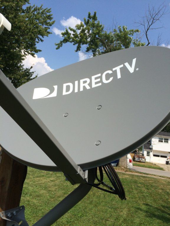

I have a SWM Slimline, about 5 years old or so. I live near the ocean so it's subject to corrosion and discoloring. My HOA said I needed to replace my dish because it looked bad - and I know better than to argue with Nazis.
So anyway I recently purchased/installed a new reflector which was exactly the same dimensions as the old one. However, it doesn't say "Slimline" on it, the color is a darker grey, and the DirecTV logo is white instead of black. Otherwise, the reflectors are identical.
I was surprised to find that after installing the new reflector (I was careful about not adjusting the reflector mount orientation), I got a 771 error. I still received on the 101 but did not get 99 or 103.
As a test, I placed the old reflector over the new one, and my signals all came back. I repeated this process 5 times. The new reflector simply does not work. Now, I've purchased an exact Slimline replacement (unused, but not mint condition) which I guess I'll have to use instead.
QUESTION: What is the difference between the two reflectors? Is it coating? Paint color? Is the focal point different but small enough to avoid observation? It seems illogical that two dishes with exactly the same shape do not present the same results.
Thanks in advance for any insight into this weirdness.
I will assume there is no difference in the dish.....Its the LNBs and the mast that holds them.....I bet your focused at different satillite because of he arm?
I appreciate the response AZ.
I used an identical arm (same length, same size - it bolted into the same holes) again except for the color, and I reused the existing LNB. I bought the reflector, arm and mounting bracket and bolts. Not wanting to alter the orientation, I only replaced the reflector itself and the arm, both of which are the exact same dimensions as those they replaced. I didn't change or move the mount.
UPDATE: Because of your comments, I just went outside and inspected very very closely, and while the arms are indeed identical, I believe I may have found a slight difference between the reflectors. The original one describes a slightly more narrow parabolic shape, as follows.
When the original is placed over the new one and pressed flush on one side, the other side is about 1/2 raised above the surface. This would theoretically change the off-axis angles of reflection and therefore the focal point just enough to where the 101 comes in but the HD ones (99 and 103) do not. I'd imagine this is the issue; the replacement I bought was not a SWM reflector. Although it was advertised as such, I doubt the seller is much of an electrical engineer.
So it appears the mystery is solved and I'll chalk up another lesson in capitalism. :-)

Hutch: they're not exactly the same, as described in my post above. Slightly different shape along the z-axis.
you have one of two things going on here good sir:
1) you have a reflector that was bent in shipping (unlikely, but not impossible)
2) ever stack chairs? the legs on the 2nd chair dont reach the ground. by pinching the one side you're making the mounting holes push the opposite side higher (since they are recessed for the reflector side) so the two sides will never sit flush.
