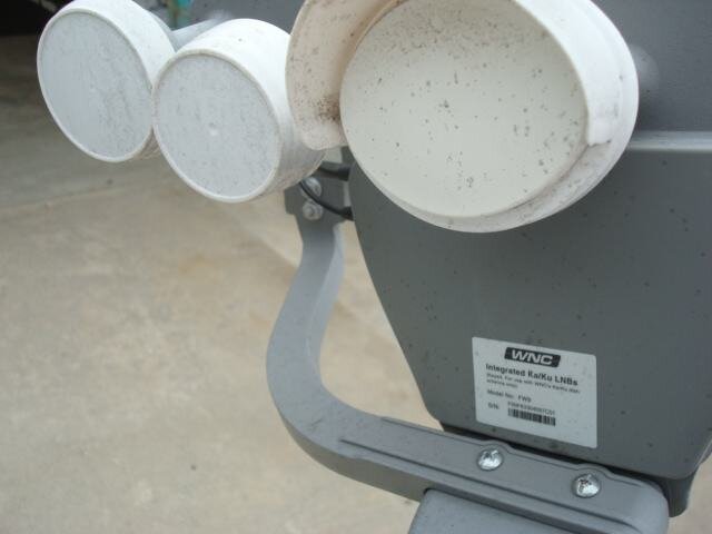

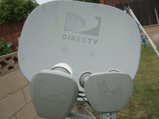

I found this 'quirky' looking dish, it measures 29X27. I'm wondering if its any good for FTA using the center LNB? Thanks!

You can use the dish. There are a lot of sats with strong TPs. But I think you need a linear LNB as those are probably all circular.
If you search for Directv dish in the title only, you can get some good stuff. I am sure other members will chime in here too.
yep, I agree:

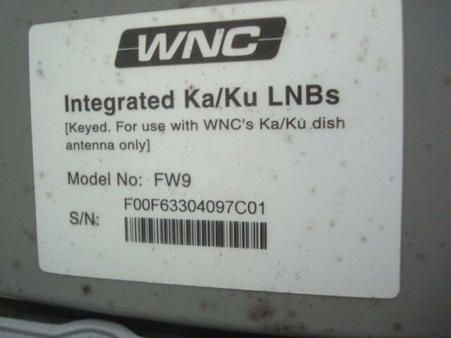

The big LNB in the middle is for Ka band and circular.
The outboard LNBs are circular Ku.
While the dish is on the small side and not a good starter dish for someone just getting into the hobby , it'd be fine for an extra dish for some of the stronger transponders you might want.
As mentioned, a proper LNBf will need to be fitted at the center mounting position.
edit:
The sturdy mount is very nice for aiming at a fixed bird, but way too heavy (and the dish too small) to put on a motor.
In fact, if you decided to throw away the dish, ya might keep the mount for future projects. :)

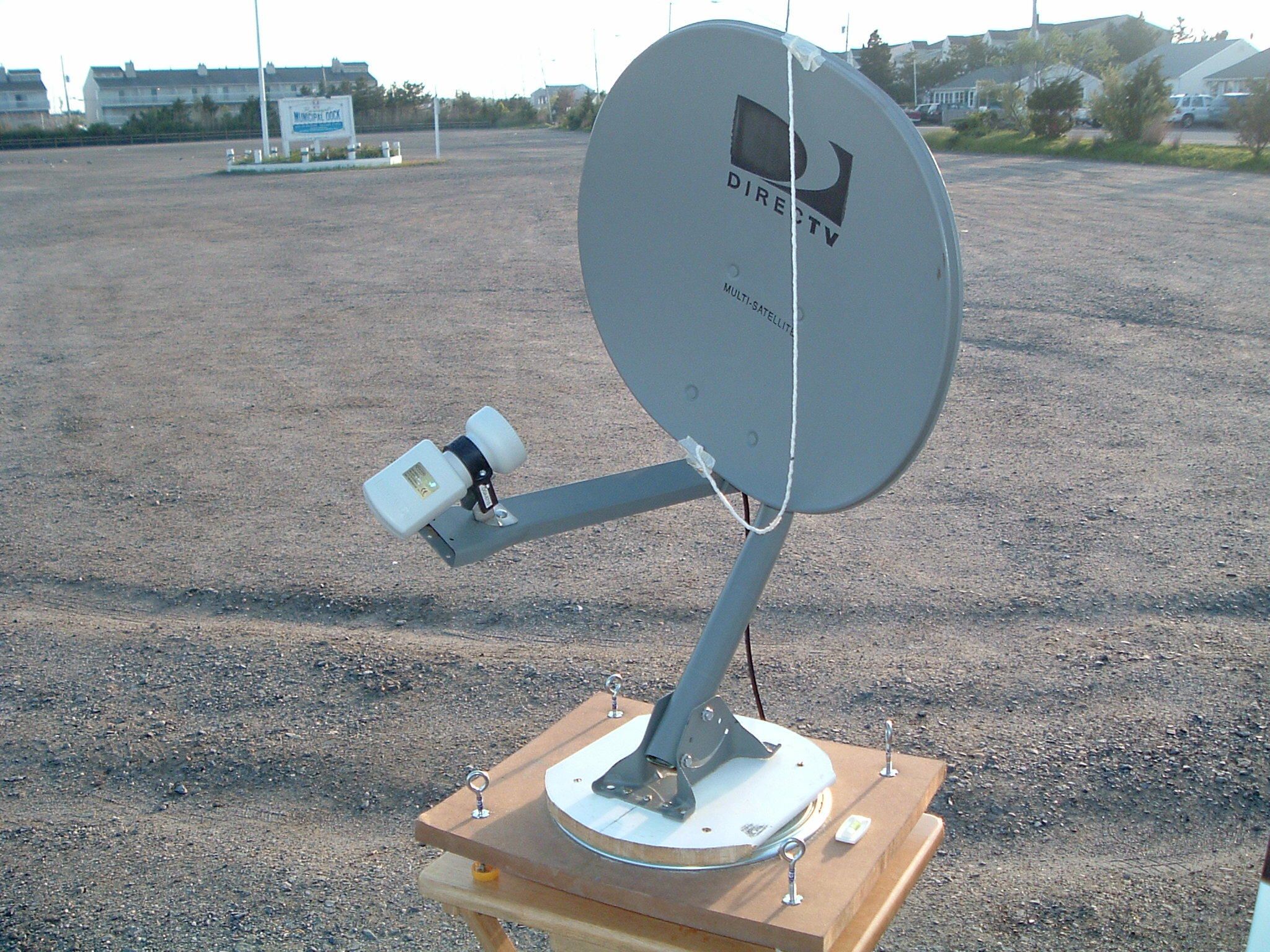

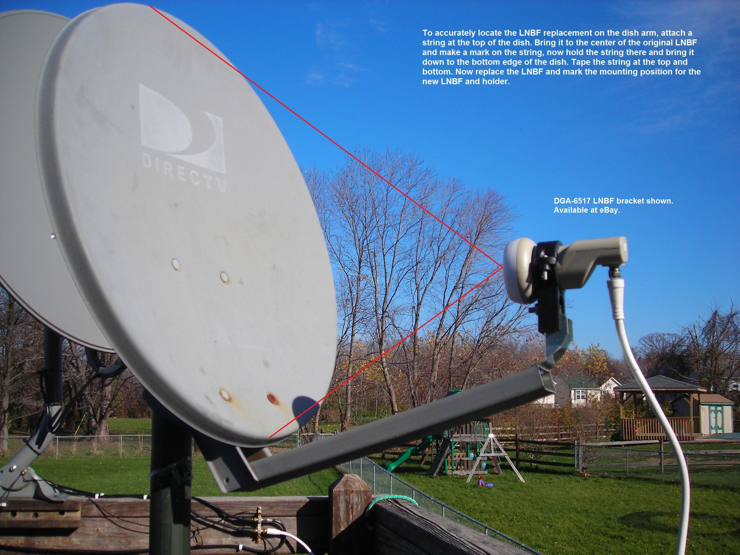

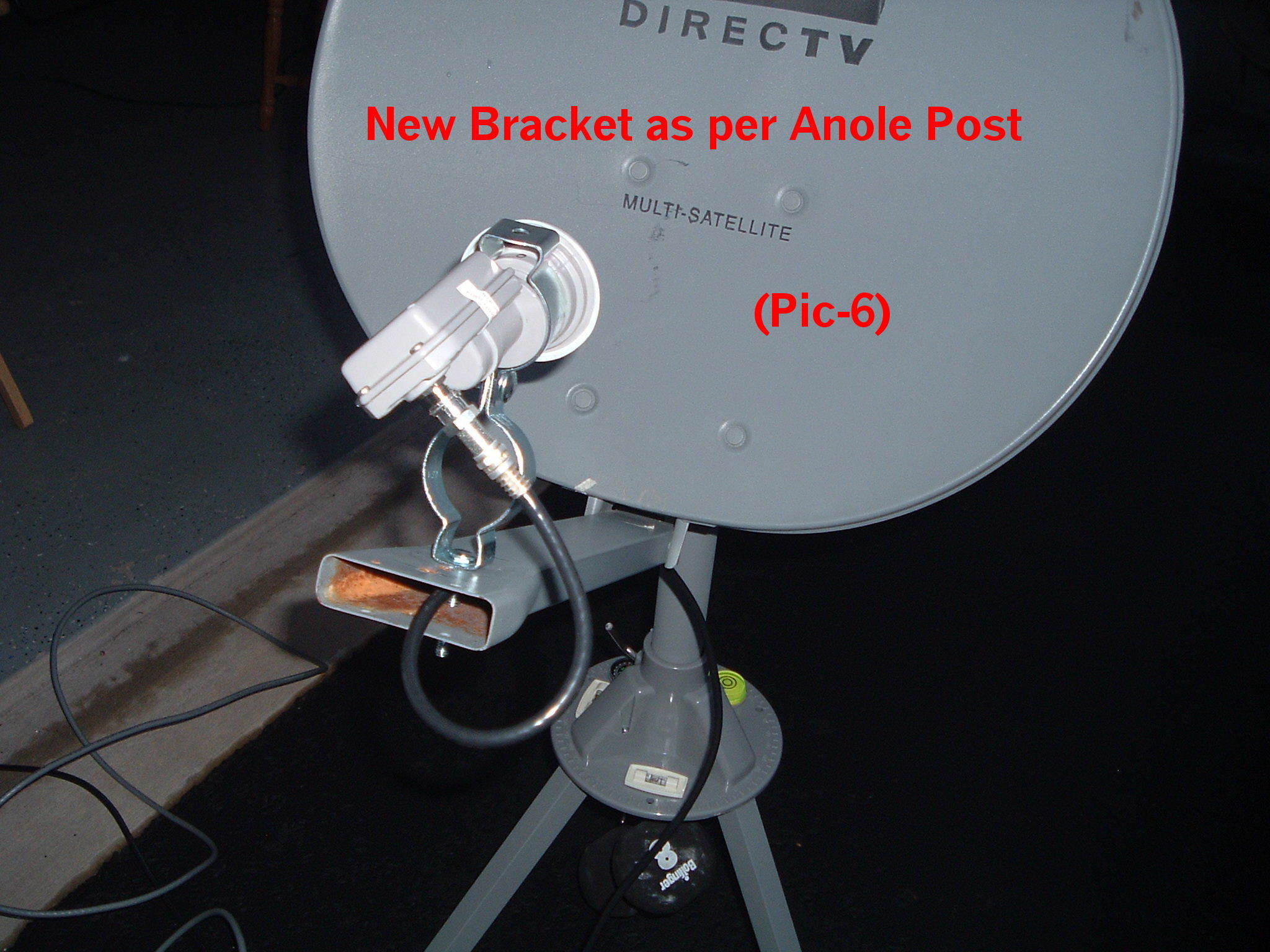

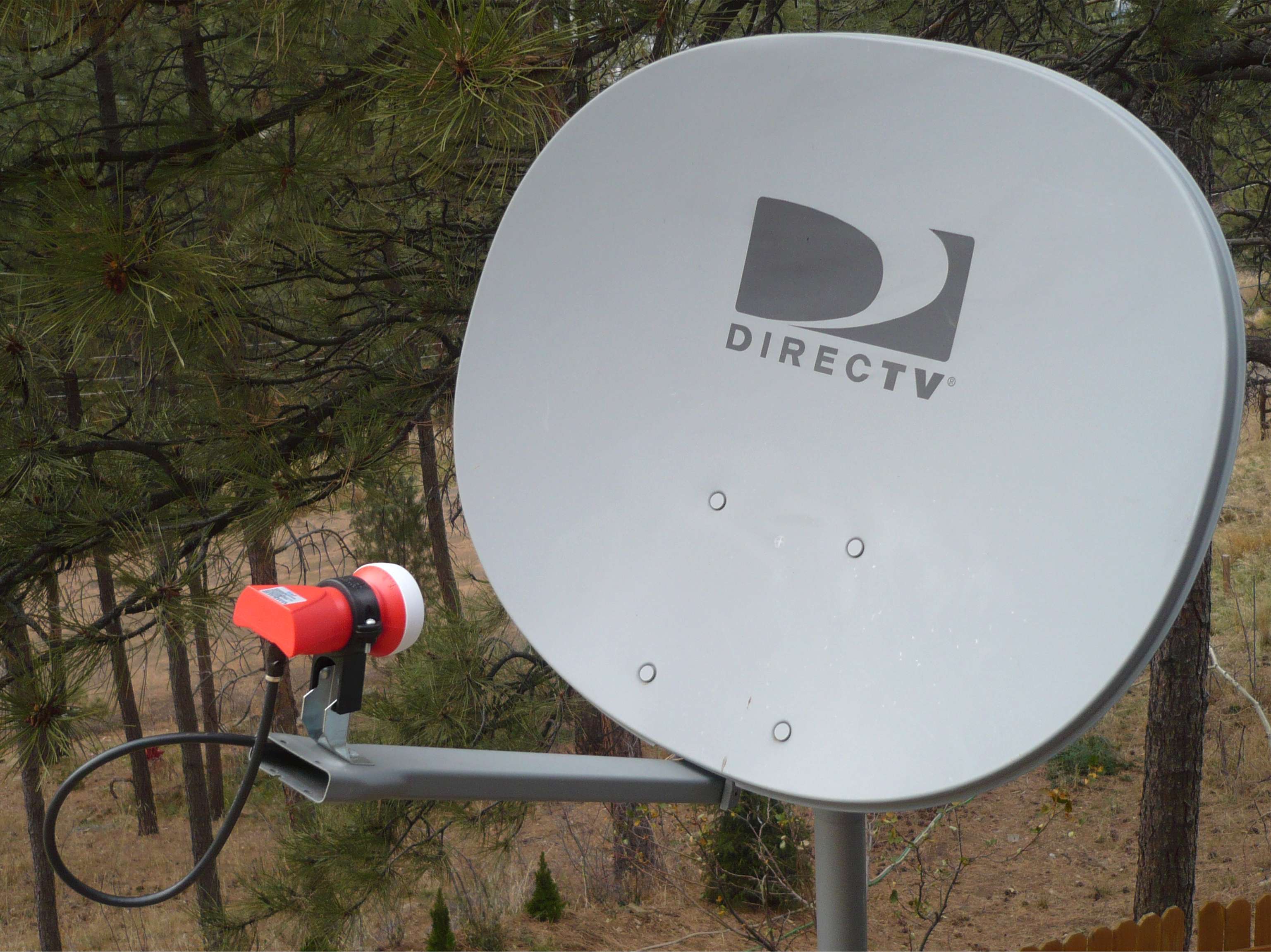

Here are pics. of what others have done.
Try 97W and 125W

1. I thought that I would not have to replace the big center LNB since it is also Ka/Ku combo LNB.

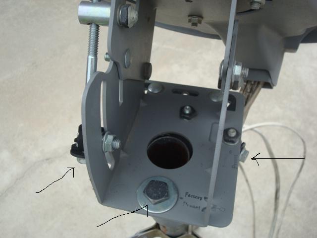

2. The bracket has 'special' bolts on it which I assume are used to set the EL/AZ/Skew?

Here's your dish on the SolidSignal web site.
Click on the tab under the pictures, marked: Documentation.
Read the AT9 Install Manual .PDF for a good understanding of how everything works.
