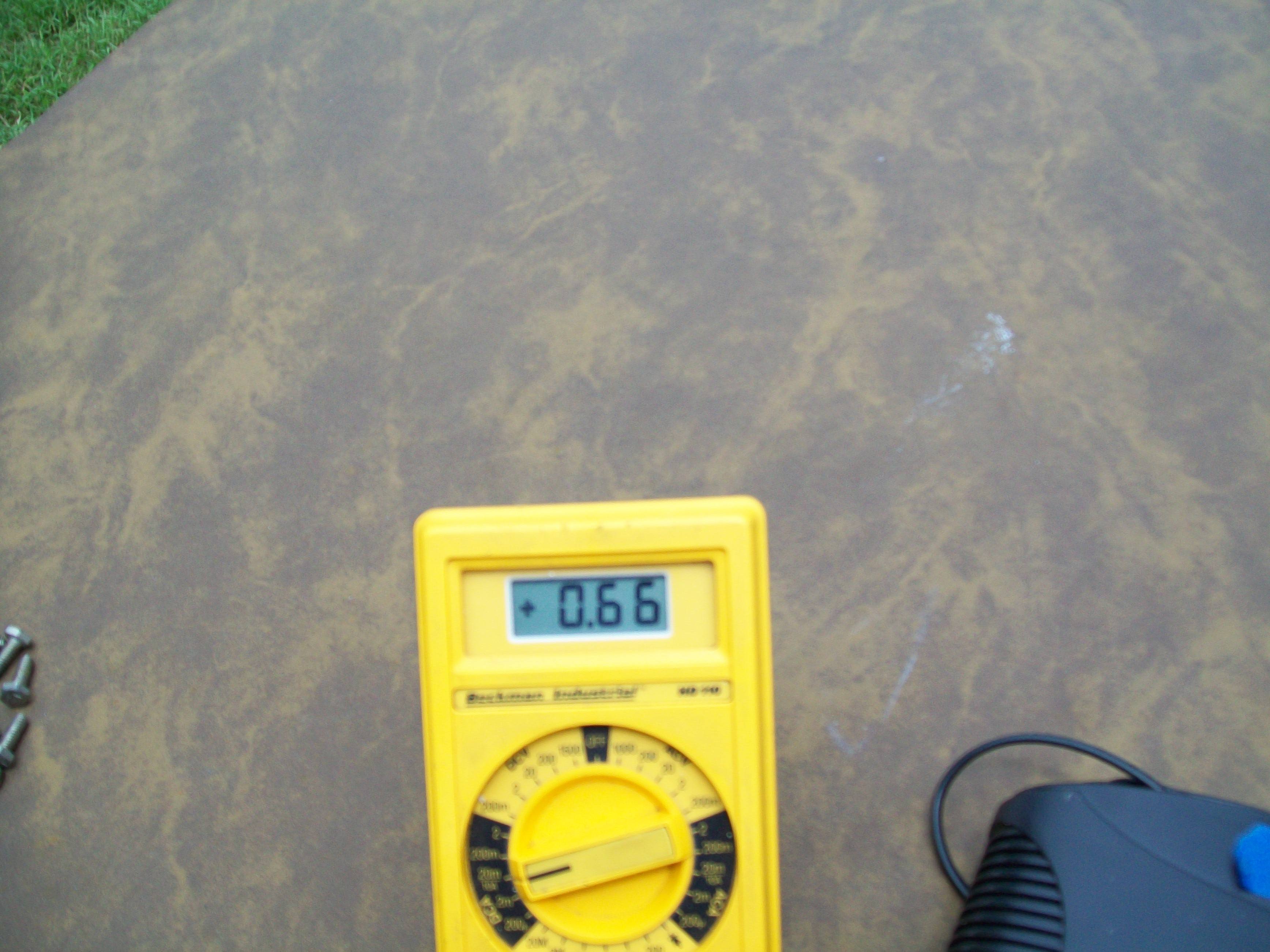

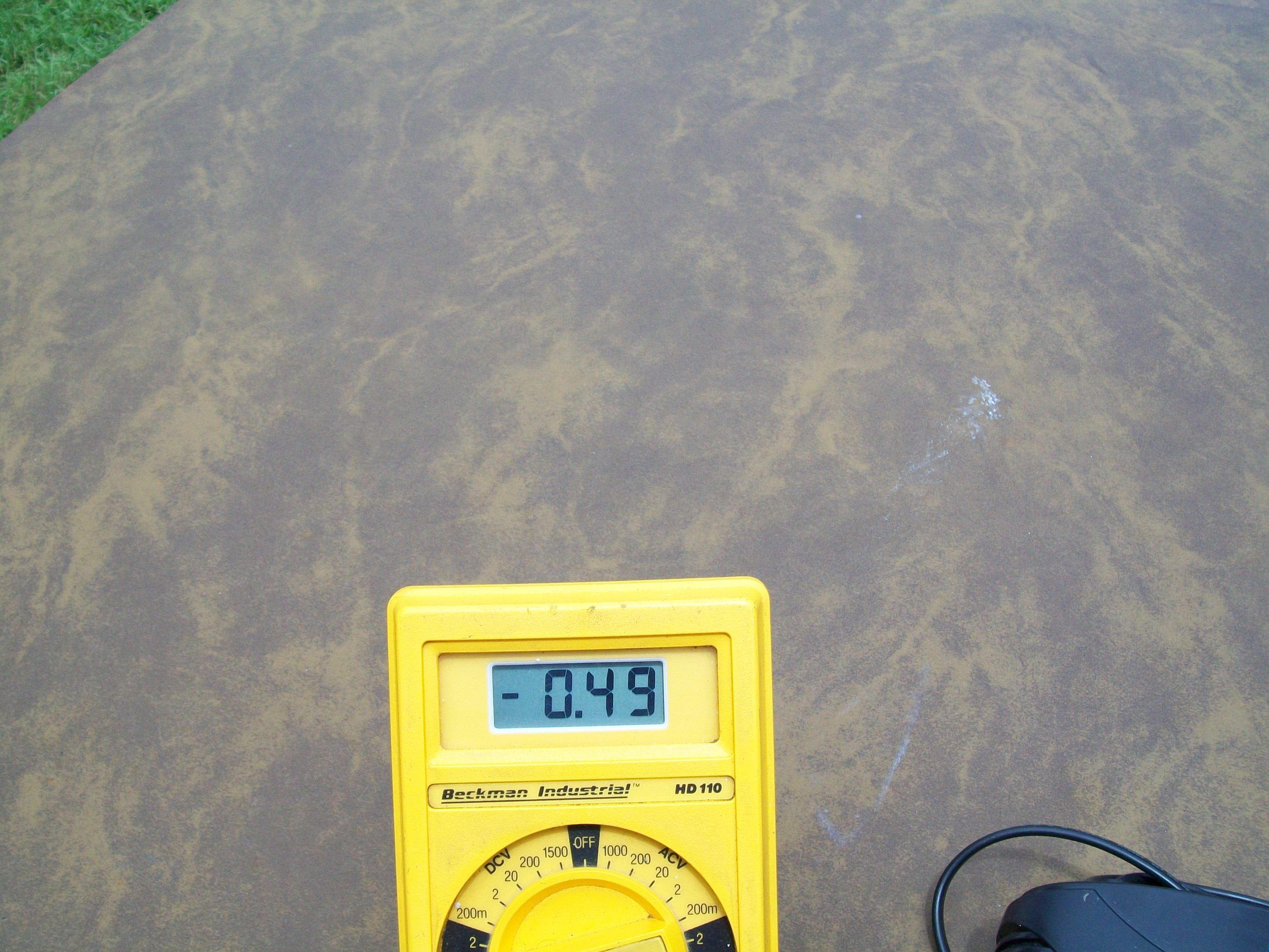

FYI the G-box will run larger than a 10-foot dish, I know because I have installed them with out no problem, and have been running fine for years. now they do have a 2.5amp draw limit, which is a lot, most actuators or H-mounts run way below that all depending on gear ratios. now every one should check their amp draw from time to time, because it does go up with motor age, wear and use.
they also say in their specs that it is limited to a 2000 count, I can tell you that the G-box will go way over that an be very accurate with a very high count. I have had several talks with the tech man at Sadoun about the high count of the G-box. one of my pride and joy dishes here is my ChannelView, that is ran by a G-box, and has been running fine for close to a year now. the dish an its mount has to be in the 350 to 400lbs range, an as far as the re-turn pulse count well over 7000. now my amp draw on this is under 1. amp draw either up or down, and right at a .5 amp draw on the down movement.
I have use these motor controlers for years, ran a MotecII w/Pan3500 for years, an when Sadoun came out with the G-box about 3 years ago I bought 2 of them an glad I did. to me they are the best on the market for a motor controler to this day.
1st pictue on down movement.
2nd picture is up movement, from a 10degrees of elevation.
