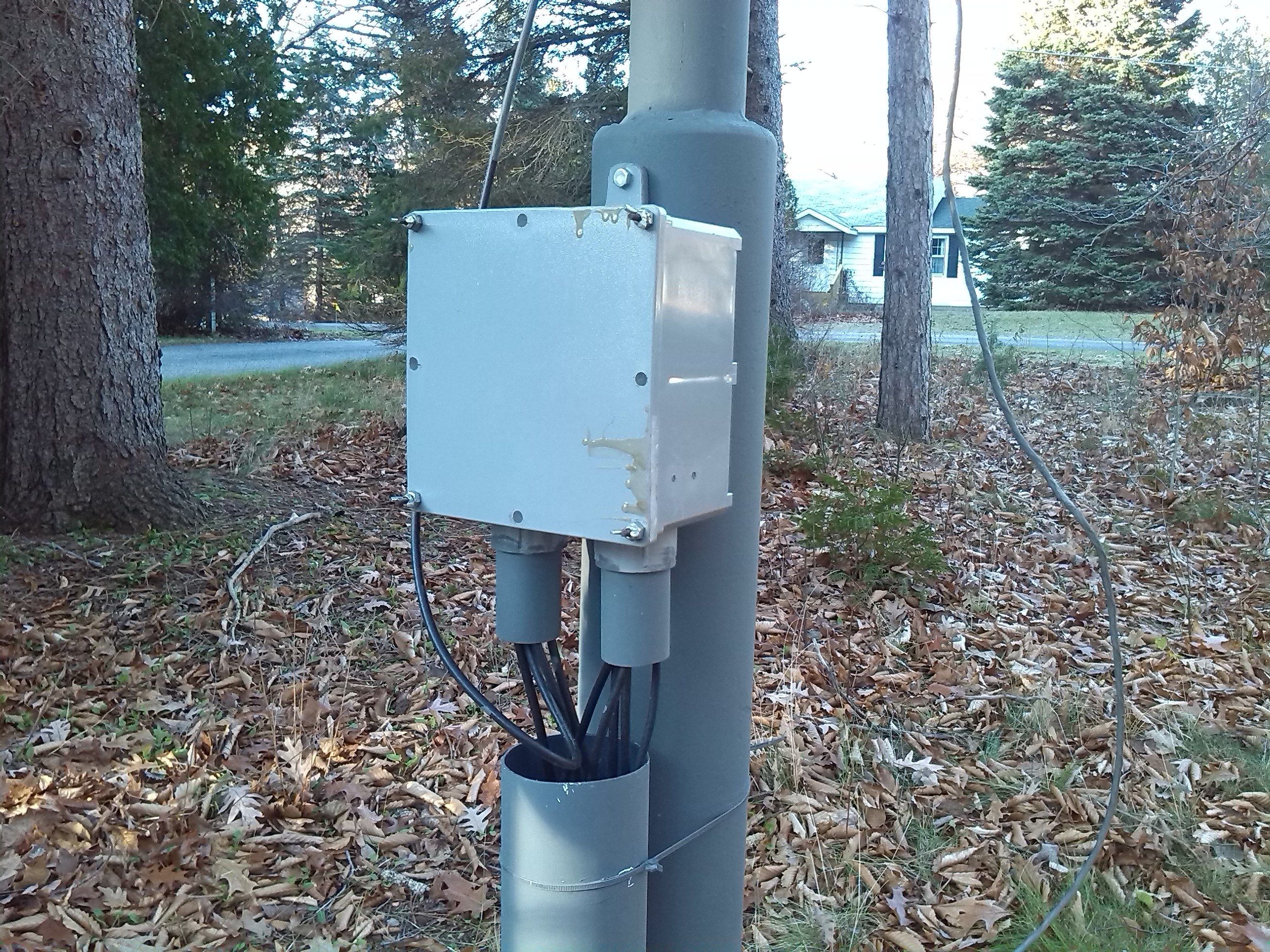

Folks, for those with D* switches... are they installed outdoors or indoors? Does it matter how far the switch is from the dishes or should the minimum cable lenght be the goal?
Cheers,K
Thanks for the tips, I thought those were weather proof. I'll do my best to shield it. As for wiring lenght, is there a rule of thumb, or any reasonable lenght goes?
Your RF (IF) will disappear way before the DiSEqC or USALS commands do. So no, there's no modification of the 'length' just because DISEqC is added.
in the old days they used to ship with plastic caps for the unused ports.Water will get in any unused ports that are aimed upwards.
They are designed to be mounted as close to the dish as possible and it would make no sense to mount them indoors.You would have to run 4 coax lines all the way to the house.

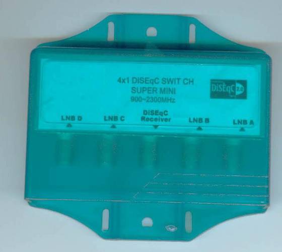

I use this type of plastic cover. It seems to protect the switch well.
Looks good.. but what is it?
looks like plastic to protect Identifications or Folders
How you insert the cable to the switch ports?:confused:
I am also looking something "cheap" , "practical" and "secure" to protect my switchs
