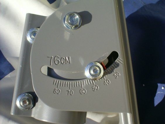

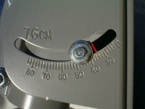

What kind of motor and dish?
If its a Winegard DS 2076 dish make sure to use the RED line when setting the elevation....

Winegard 76m dish, H-H DM-910 motor, Viewsat Xtreme receiver.
Thanks, the book does not explain the red line marker.
So I'm setting it for 23.4, which I'm assuming combined with the motor post angle, gives me 30 deg.
Back on the roof!!!
Thanks again,
Bob
