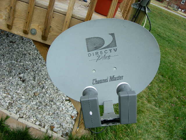

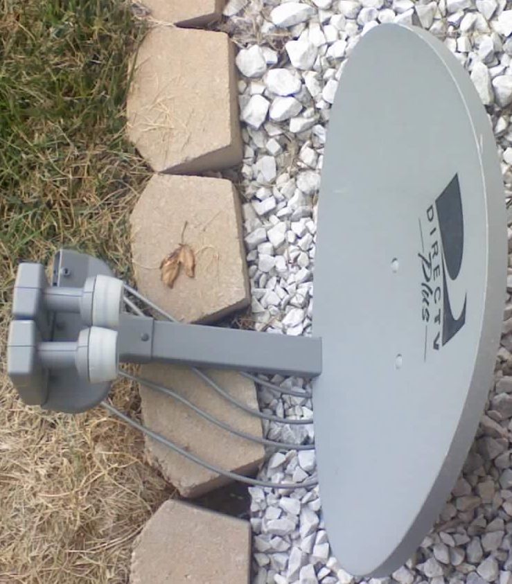

Okay, failure to communicate.
I made an assumption... that your new DirecTV dish was a Phase III as in my "small dish" link above.
It's not, the "Plus" is a Phase II dish as shown in the picture below.
So, as Tron asked, what sort of mod did you do to put a linear LNB on it?
Show us some pictures.
I have no doubt the dish will work, as long as the LNB is the proper type and location.
This matter of skewing the dish WILL cause you aiming confusion.
The darned thing will appear to be pointed way off in the wrong direction, and at the wrong altitude.
What I did with my Phase III dish is NOT skew the dish itself, but just the LNB it it's holder.
The alternative is to set up the dish with zero skew, and try to get it aimed correctly with a compass.
Mark the pole so you can reset the dish azimuth...
THEN, skew the dish the required number of degrees...
... and then sweep the sky looking for your bird.
edit: not my pix. Just some I found on the internet and archived.
