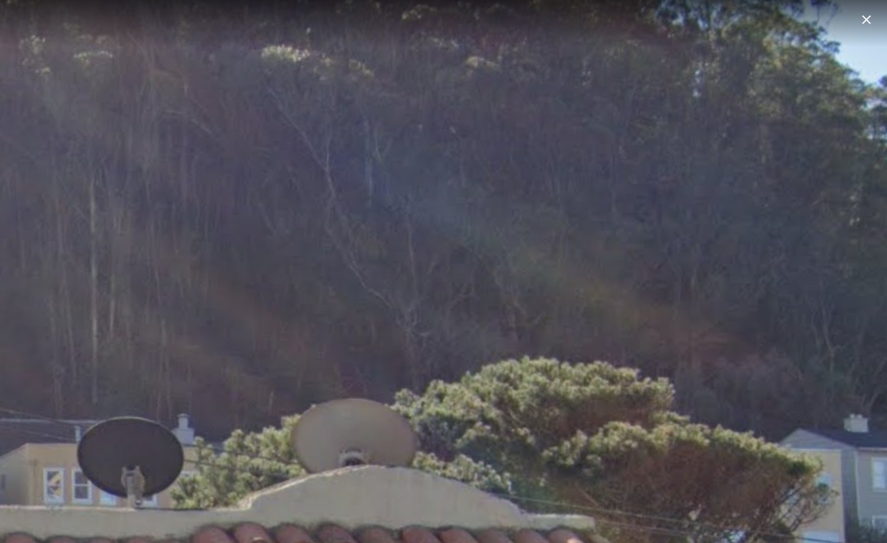

This is what the two dishes 1000.2 and 500+ looks like from Google Maps Street View before yesterday when looking at it from the street on the front side of the house, you can actually see the coax cable on the back of the black dish after he fixed it. The in-house DISH technicians seems to do a better job as you can't see the wires except the ones that go down the wall from the roof to get to the receiver as there is no wall jack since the RG6 seems to go directly through the wall with a RF-6 plate to the back of the receiver directly.
